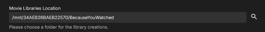

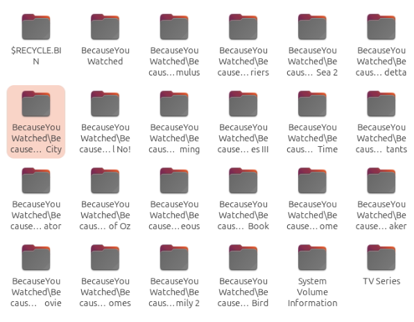

kjhedges 67 Posted November 2, 2024 Posted November 2, 2024 I tried this plugin again, But I appear to have some issue with where I select Movie Libraries Location The items that the plugin is creating though do not reside in that folder. So the created Library does not show any content. I also see in the Logs this line for every media item Error App: One or more errors occurred. (Access to the path '/opt/emby-server 'medianame' is denied.) 1 example Error App: One or more errors occurred. (Access to the path '/opt/emby-server\Dead Men Are Dangerous (1939)' is denied.)
mickle026 653 Posted November 2, 2024 Posted November 2, 2024 2 hours ago, kjhedges said: /opt/emby-server\Dead Men Are Dangerous (1939) / and \ in the same path. Suggestion: Programmer needs to use C# Path.Combine() from System.IO , rather than +"\" or +"/" when making paths in order to support all OS's.

bwarthen 13 Posted November 3, 2024 Author Posted November 3, 2024 (edited) Here is a new build that should work for linux using mickle026 Path.Combine() suggestion. Thanks for the information. Emby.WatchedSuggestions.dll Let me know if this works for you kjhedges Edited November 3, 2024 by bwarthen 1

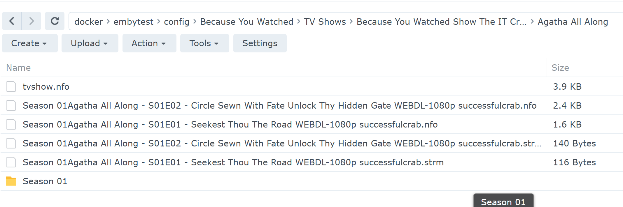

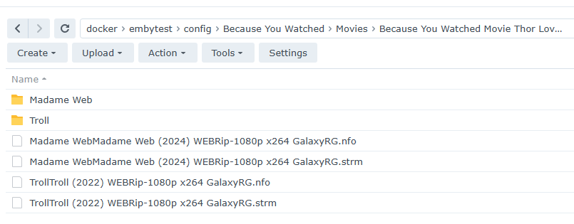

fillidill 175 Posted December 5, 2024 Posted December 5, 2024 @bwarthenThis is a really cool plugin! However, I am using the linux version of the plugin on my Synology and it still seems to create the structure incorrectly. Look at this example where it doesn't place the strm in the correct folder, instead the folder name is placed in the name of the file.
bwarthen 13 Posted December 5, 2024 Author Posted December 5, 2024 (edited) I will have to dig my old linux system out of the closet and get that up and running to test this out. I'll see if I can get it working correctly on both systems. It may take a bit to get it all updated again because it is mostly manual. It's on something similar to a raspberry pi. Just out of curiosity is there anything in the folders at all? Edited December 5, 2024 by bwarthen 1
fillidill 175 Posted December 6, 2024 Posted December 6, 2024 10 hours ago, bwarthen said: I will have to dig my old linux system out of the closet and get that up and running to test this out. I'll see if I can get it working correctly on both systems. It may take a bit to get it all updated again because it is mostly manual. It's on something similar to a raspberry pi. Just out of curiosity is there anything in the folders at all? Yes, all the metadata of the movie/show is there. It only seems to be the .strm that is not placed correctly. Attached is an example of a tv show. Disregard the nfo files as I think those are automatically created by Emby (my libraries are set to save them along the media files).
