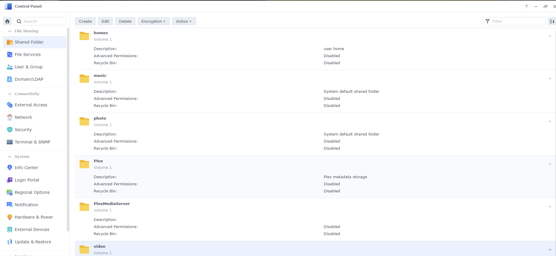

bus275Mail 0 Posted September 13, 2024 Posted September 13, 2024 Updated to DMS 7.2. and got "this version installed in incompatible with your DMS 7.2." Uninstalled and reinstalled and started fine but cannot find my libraries "scan medial library Failed." Tried adding a new library with the server address, but it won't authorize. Tried looking at the shared folder in my Synology, but nothing about Emby there. Realize it is likely a simple pointing to the data, but I cannot figure it out. Any help is appreciated.
bus275Mail 0 Posted September 13, 2024 Author Posted September 13, 2024 I think so, but no MyEmbyMedia showed up. There were some things about some old Plex services, but nothing about Emby.

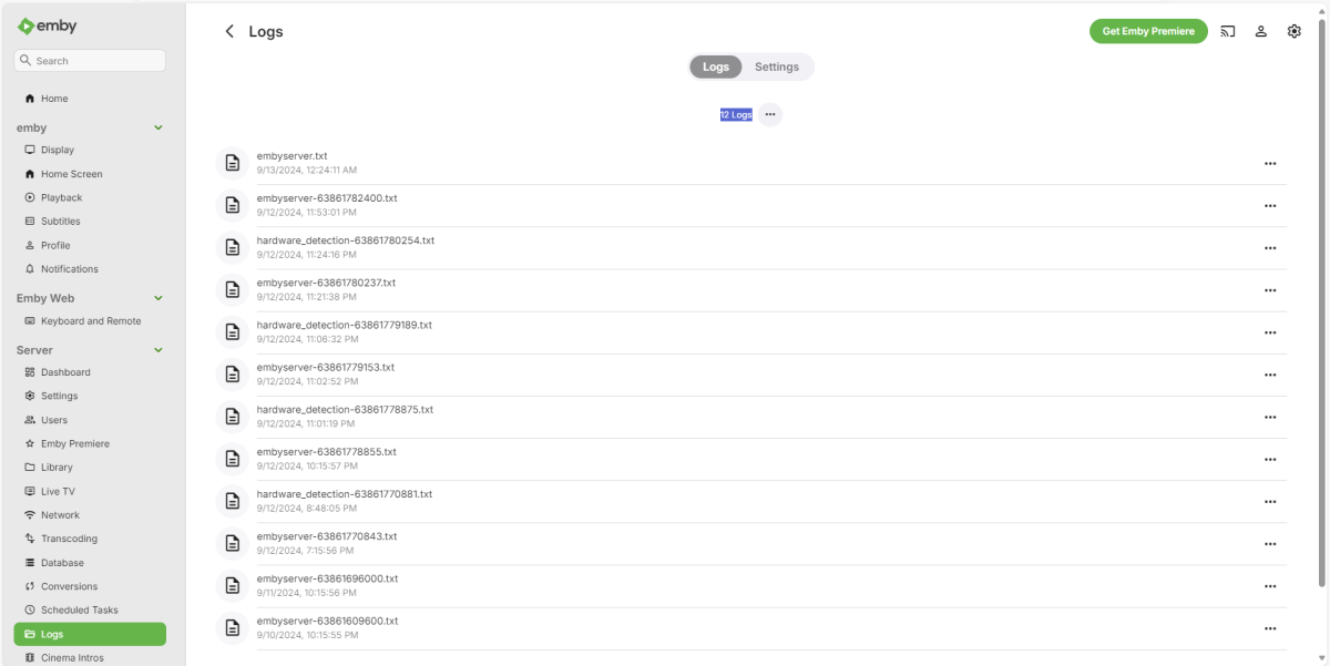

bus275Mail 0 Posted September 13, 2024 Author Posted September 13, 2024 Kind of challenging to know which log. I made the update about 2 hours ago. I am still guessing that it is not the update itself, but just that it is not pointing at the Synology data files. Anyway, LMK if any of these might be helpful and I will upload them.
Happy2Play 9811 Posted September 13, 2024 Posted September 13, 2024 I would post the top two as the current top one don't know if that is a midnight rollover log or a startup log.
Happy2Play 9811 Posted September 13, 2024 Posted September 13, 2024 Might even have to compare to a log before your DSM update.
bus275Mail 0 Posted September 13, 2024 Author Posted September 13, 2024 I've attached the last two plus the one I believe is before the update. embyserver-63861782400.txt embyserver.txt embyserver-63861778855.txt
Solution Happy2Play 9811 Posted September 13, 2024 Solution Posted September 13, 2024 17 minutes ago, bus275Mail said: I've attached the last two plus the one I believe is before the update. embyserver-63861782400.txt 3.58 MB · 0 downloads embyserver.txt 172.19 kB · 0 downloads embyserver-63861778855.txt 30.51 kB · 0 downloads You had beta installed for DSM7 and downgrade to release on DSM7.2, you cannot do that as there is a database change. SQLitePCL.pretty.SQLiteException: Error: no such column: Album Please install beta 4.9.0.30 and you should be good. Or you have to delete the database and start over. 1 1
