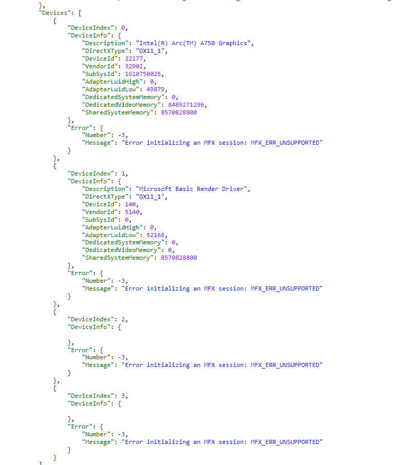

softworkz 5135 Posted September 18, 2024 Posted September 18, 2024 (Haven't looked at the dxdiag log yet...) What looks suspicious is that the system indicates that there would be 5 graphic adapters on your system and 3 of them create errors, so that we can't even retrieve basic information (like adapter name, etc): The actual errors from the information retrieval are a bit hidden (end of a long line): I can imagine very well that the Intel implementation of QSV does the same enumeration and because it fails on that, it might not even work for the first adapter (Arc). Handbrake may possibly use QSV via D3D9 rather than 11 like we do.
softworkz 5135 Posted September 18, 2024 Posted September 18, 2024 DxDiag show just one display adapter - but that's probably normal as it's supposed to show direcx display devices only. The question is: where are those 5 devices coming from? Any idea? Do you see anything in Device Manager? Is there any software installed which might create any kind of (virtual) display adapters?

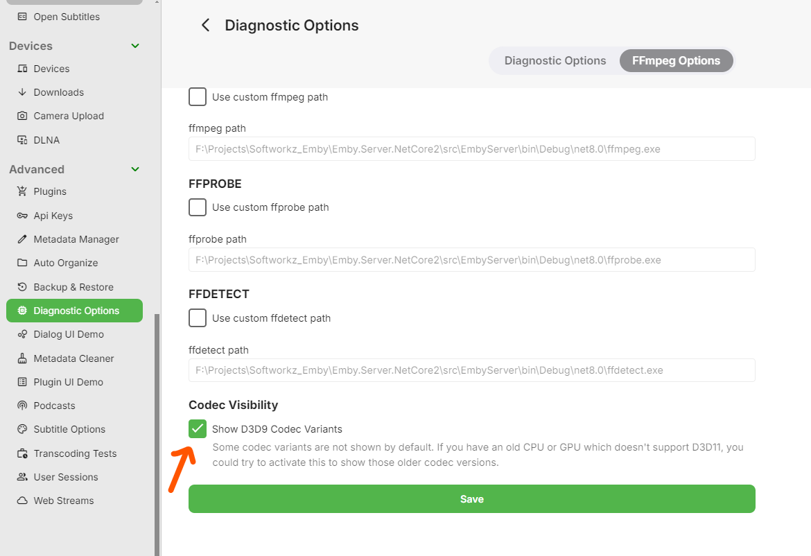

softworkz 5135 Posted September 18, 2024 Posted September 18, 2024 As a last resort, you could also make Emby Server use D3D9. To enable this, you need to install the "Diagnostics Plugin" from the catalog, this will give you a new entry "Diagnostic Options": Don't forget to press SAVE, then restart Emby Server and wait a moment for the hw detection to finish.
