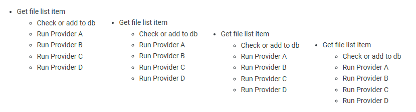

softworkz 5121 Posted September 12, 2024 Posted September 12, 2024 The primary cause of inefficience is the sequential nature of the process: Get file list item Check or add to db Run Provider A Run Provider B Run Provider C Run Provider D Get file list item Check or add to db Run Provider A Run Provider B Run Provider C Run Provider D The problem is, that you cannot run many of the metadata providers in parallel as they will error. You even need to obeye rate limits for some of them. So, when you parallelize the file system scanning, you would still have to sequentialize the provider processing (which is what really takes time). One possible way would be to interleave processing similar to this: Where things run in parallel to some extent, but in a way that each provider gets a single request only at a time. But that's way more complicated as it sounds. Also, not all providers take the same amount of time and this would equalize duraction for each provider to the max duration of all. So, it needs to be decoupled even further. It's very possible but not an easy change.
