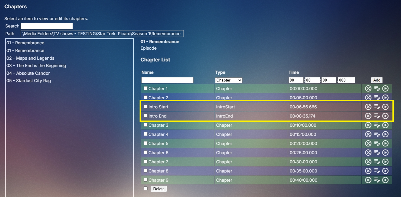

Happy2Play 9814 Posted September 12, 2024 Posted September 12, 2024 4 minutes ago, podonnell said: Is there some kind of debug tool that lets me see where the 'intro' markers are on particular titles? Have you looked at the Chapter API plugin?

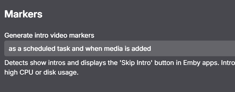

podonnell 48 Posted September 12, 2024 Author Posted September 12, 2024 46 minutes ago, Happy2Play said: Have you looked at the Chapter API plugin? I haven't, will install that and give it a shot. I confirmed the 'Markers' is set on the library, but I feel like this task maybe was cancelled on the series when it was first imported. Is there any way to re-run this for a specific series without re-adding the media?

Luke 42255 Posted September 12, 2024 Posted September 12, 2024 10 hours ago, podonnell said: I haven't, will install that and give it a shot. I confirmed the 'Markers' is set on the library, but I feel like this task maybe was cancelled on the series when it was first imported. Is there any way to re-run this for a specific series without re-adding the media? Based on your settings, refreshing metadata at the series level will do it.
podonnell 48 Posted September 12, 2024 Author Posted September 12, 2024 6 hours ago, Luke said: Based on your settings, refreshing metadata at the series level will do it. Just tried this, but it does not kick off the 'Detect Episode Intros' task. However, even after manually running that it still does not seem to have intros. Wondering if the media is the issue. 17 hours ago, Happy2Play said: Dev will have to comment but only thing I can think of would be Refresh metadata on episodes, Season, or Series. But the plugin shows info per item. I have now added this plugin, but confused if this is a 'new' intro detector that I need to be running? I'm going to post in the thread there, but it shows there are no intros for the series season I selected.
Happy2Play 9814 Posted September 13, 2024 Posted September 13, 2024 3 hours ago, podonnell said: I have now added this plugin, but confused if this is a 'new' intro detector that I need to be running? I'm going to post in the thread there, but it shows there are no intros for the series season I selected. Just go to the media in the plugin and verify if it has markers.
podonnell 48 Posted September 13, 2024 Author Posted September 13, 2024 (edited) 1 hour ago, Happy2Play said: Just go to the media in the plugin and verify if it has markers. Thanks for the nice image. I checked that out and the intro start and end were missing. So it looks like the built-in one is not picking them up. From what I'm reading, I need to get a database and search it and then run a check with the plugin you linked to get the intros to show. Update: Just tried to load the DB, got a success message, but when I did a download/reload of the intro data, the series I am looking for was not shown. Edited September 13, 2024 by podonnell
