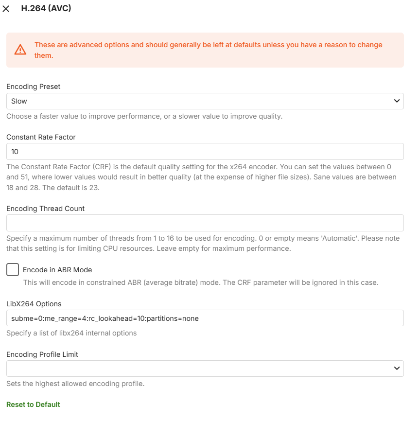

Luke 42176 Posted September 13, 2024 Posted September 13, 2024 Quote I can change the encoding preset, but even putting that down to something insane like slow doesn't seem to do much in terms of the end quality level, very minimal difference from what I've tested so far. I'm not sure where else I can look? Hi, did you verify the changes were applied by comparing the ffmpeg logs?
drapacioli 8 Posted September 13, 2024 Author Posted September 13, 2024 (edited) 12 hours ago, Luke said: Hi, did you verify the changes were applied by comparing the ffmpeg logs? I guess? If I'm looking in the right place in the logs, it looks like it: File with default transcoding: C:\Users\nick\AppData\Roaming\Emby-Server\system\ffmpeg.exe -loglevel +timing -y -print_graphs_file "C:\Users\nick\AppData\Roaming\Emby-Server\programdata\logs\ffmpeg-transcode-43393baa-1c3e-4c60-b315-289f3f73bafe_1graph.txt" -copyts -start_at_zero -init_hw_device "qsv=dev1:hw,child_device=0,qsv_use_dx11=1" -f matroska,webm -ss 00:00:06.000 -c:v:0 h264_qsv -threads:v:0 1 -hwaccel:v:0 qsv -hwaccel_device:v:0 dev1 -hwaccel_output_format:v:0 qsv -noautorotate -i "\\DS218\Emby\Anime\Subbed\Pocket Monsters (2023) {anidb-17777}\Pocket Monsters (2023) - E63 - Episode 63.mkv" -filter_complex "[0:0]hwdownload@f1,format@f2=pix_fmts=nv12,format@f3=pix_fmts=yuv420p,subtitles@f4=filename='\\\\DS218\\Emby\\Anime\\Subbed\\Pocket Monsters (2023) {anidb-17777}\\Pocket Monsters (2023) - E63 - Episode 63.mkv':fontsdir='C\:\\Users\\nick\\AppData\\Roaming\\Emby-Server\\programdata\\fonts':si=0,hwupload@f5=extra_hw_frames=32[f5_out0]" -map [f5_out0] -map 0:1 -sn -c:v:0 h264_qsv -b:v:0 3458005 -g:v:0 72 -maxrate:v:0 3458005 -bufsize:v:0 6916010 -keyint_min:v:0 72 -r:v:0 23.976024627685547 -profile:v:0 high -aud:v:0 1 -c:a:0 libmp3lame -ab:a:0 192000 -ac:a:0 2 -metadata:s:a:0 language=jpn -disposition:a:0 default -max_delay 5000000 -avoid_negative_ts disabled -f segment -map_metadata -1 -map_chapters -1 -segment_format mpegts -segment_list "C:\Users\nick\AppData\Roaming\Emby-Server\programdata\transcoding-temp\B3FAC3\B3FAC3.m3u8" -segment_list_type m3u8 -segment_time 00:00:03.000 -segment_start_number 2 -individual_header_trailer 0 -write_header_trailer 0 -segment_write_temp 1 "C:\Users\nick\AppData\Roaming\Emby-Server\programdata\transcoding-temp\B3FAC3\B3FAC3_%d.ts" Same file with advanced transcoding and preset set to slow: C:\Users\nick\AppData\Roaming\Emby-Server\system\ffmpeg.exe -loglevel +timing -y -print_graphs_file "C:\Users\nick\AppData\Roaming\Emby-Server\programdata\logs\ffmpeg-transcode-4ae161bb-3789-4a7b-8065-6b6840e2aba2_1graph.txt" -copyts -start_at_zero -init_hw_device "qsv=dev1:hw,child_device=0,qsv_use_dx11=1" -f matroska,webm -c:v:0 h264_qsv -threads:v:0 1 -hwaccel:v:0 qsv -hwaccel_device:v:0 dev1 -hwaccel_output_format:v:0 qsv -noautorotate -i "\\DS218\Emby\Anime\Subbed\Pocket Monsters (2023) {anidb-17777}\Pocket Monsters (2023) - E63 - Episode 63.mkv" -filter_complex "[0:0]hwdownload@f1,format@f2=pix_fmts=nv12,format@f3=pix_fmts=yuv420p,subtitles@f4=filename='\\\\DS218\\Emby\\Anime\\Subbed\\Pocket Monsters (2023) {anidb-17777}\\Pocket Monsters (2023) - E63 - Episode 63.mkv':fontsdir='C\:\\Users\\nick\\AppData\\Roaming\\Emby-Server\\programdata\\fonts':si=0,hwupload@f5=extra_hw_frames=32[f5_out0]" -map [f5_out0] -map 0:1 -sn -c:v:0 h264_qsv -b:v:0 3458005 -g:v:0 72 -maxrate:v:0 3458005 -bufsize:v:0 6916010 -keyint_min:v:0 72 -r:v:0 23.976024627685547 -preset:v:0 slow -profile:v:0 high -aud:v:0 1 -c:a:0 libmp3lame -ab:a:0 192000 -ac:a:0 2 -metadata:s:a:0 language=jpn -disposition:a:0 default -max_delay 5000000 -avoid_negative_ts disabled -f segment -map_metadata -1 -map_chapters -1 -segment_format mpegts -segment_list "C:\Users\nick\AppData\Roaming\Emby-Server\programdata\transcoding-temp\1ACD02\1ACD02.m3u8" -segment_list_type m3u8 -segment_time 00:00:03.000 -segment_start_number 0 -individual_header_trailer 0 -write_header_trailer 0 -segment_write_temp 1 "C:\Users\nick\AppData\Roaming\Emby-Server\programdata\transcoding-temp\1ACD02\1ACD02_%d.ts" I don't think that's the problem though, I think the problem is the bitrate is too low for realtime encoding profiles in the first place. How can I override it or better yet remove the bitrate limitation entirely/set by the user defined quality limit in the web player? I've noticed it's worse on some episodes than others, I'm thinking it's using the average bitrate of the file to set the "bitrate" in the encoding settings? The quality is consistent in the source from episode to episode, visually speaking, but the average bitrate is the only thing that varies, and that value seems to be what is passed along in the transcoding profile. It's the only reason I can think of that the transcoding can vary so much in terms of quality from episode to episode. Edited September 13, 2024 by drapacioli

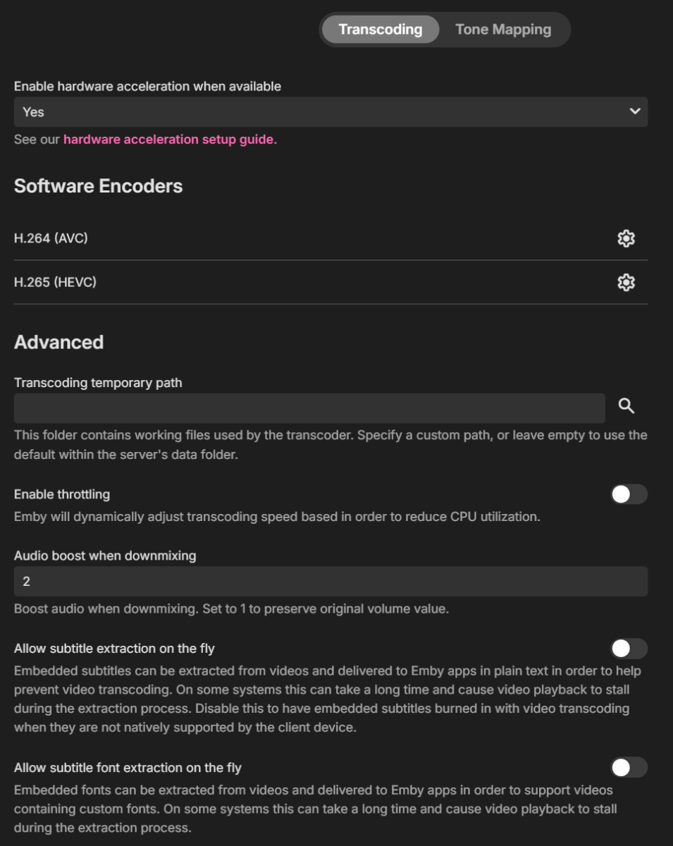

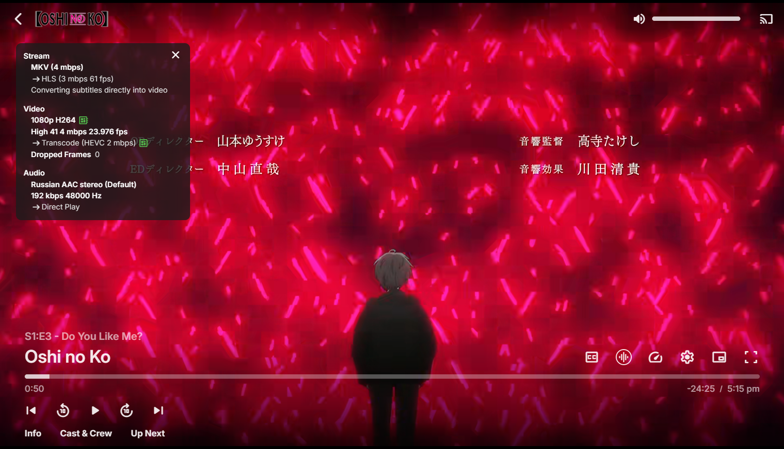

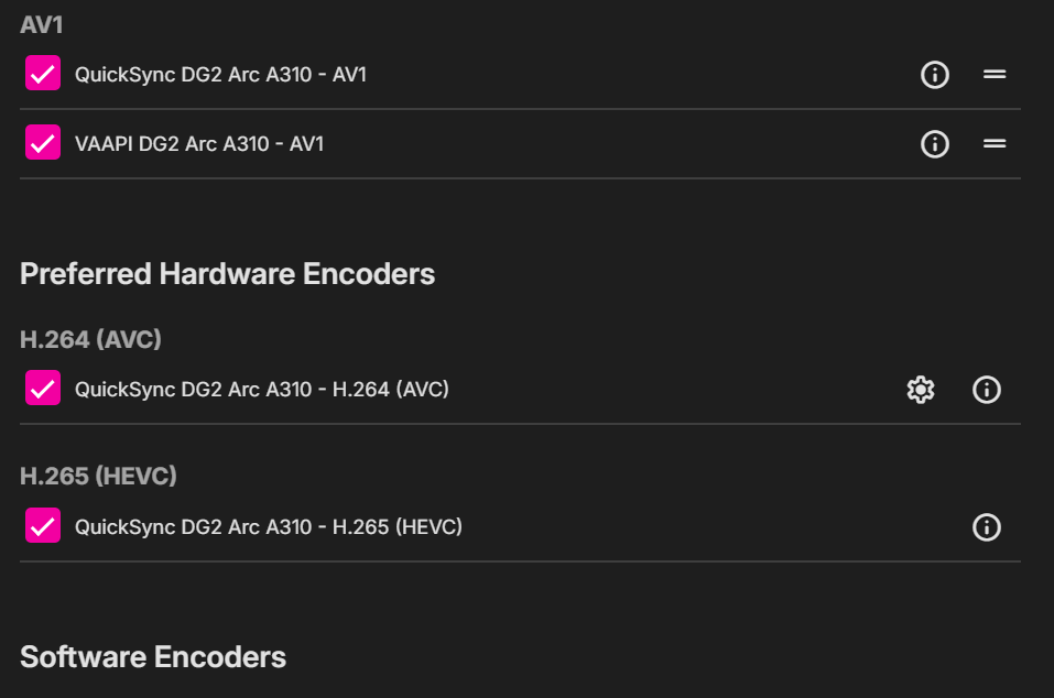

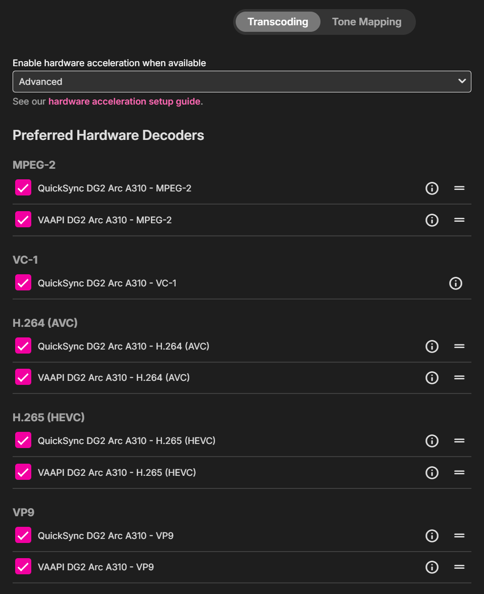

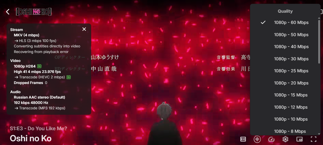

semioniy 4 Posted June 26, 2025 Posted June 26, 2025 (edited) So, it's been almost a year. I installed a cheap Intel ARC A310 into my UnRaid server and was able to make transcoding work, but it caps out at 2Mbps for HEVC and 4Mbps for H.264 despite the client demanding 60Mbps of quality. Look at these beautiful artifacts TBH, I don't quite understand where the settings for HWA transcoding are. Here's the Transcoding page: There are certainly settings for Software Encoding, but HWA encoding can only be switched On/Off. If I go to 'Advanced' instead of 'Yes', I see The options cog only near the Preferred Hardware Encoders - is it here that I set my desired encoding quality? If yeas - then also no dice, setting Encoding preset to Slow and CRF to 10 changes absolutely nothing, I still get the same bitrate. So, where do I change the quality? Edited June 26, 2025 by semioniy
drapacioli 8 Posted June 26, 2025 Author Posted June 26, 2025 2 minutes ago, semioniy said: So, where do I change the quality? That's the neat part, we don't... I've ultimately resorted to effectively tripling my used storage space by re-encoding things in higher quality than necessary where I need to be able to swap between subs, and burning in where I can. It was $300 for the hard drive space to do it, sadly the emby team was not willing to budge on this design philosophy. Even the solution I thought I had before - Jellyfin - has other limitations that made it impractical.

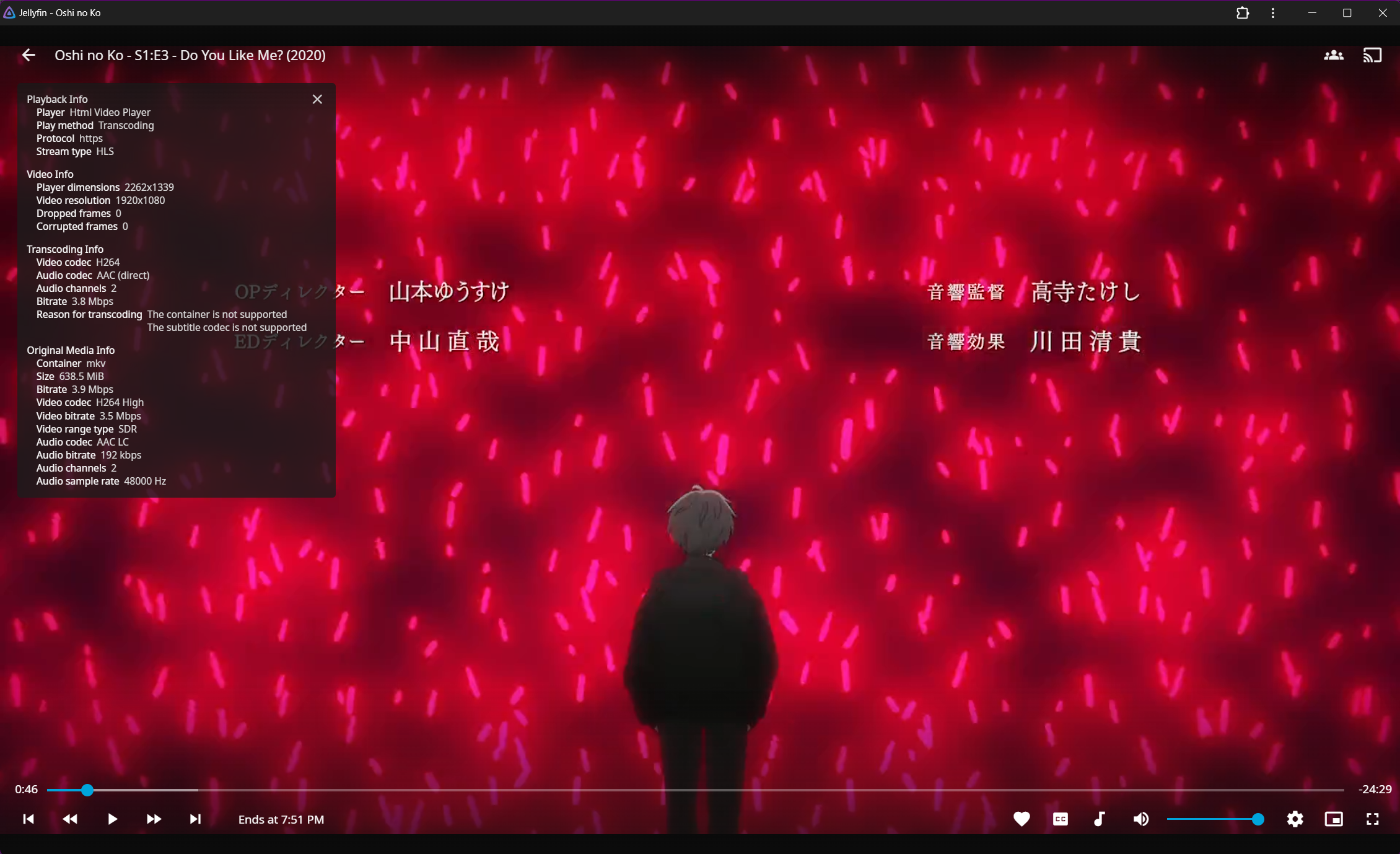

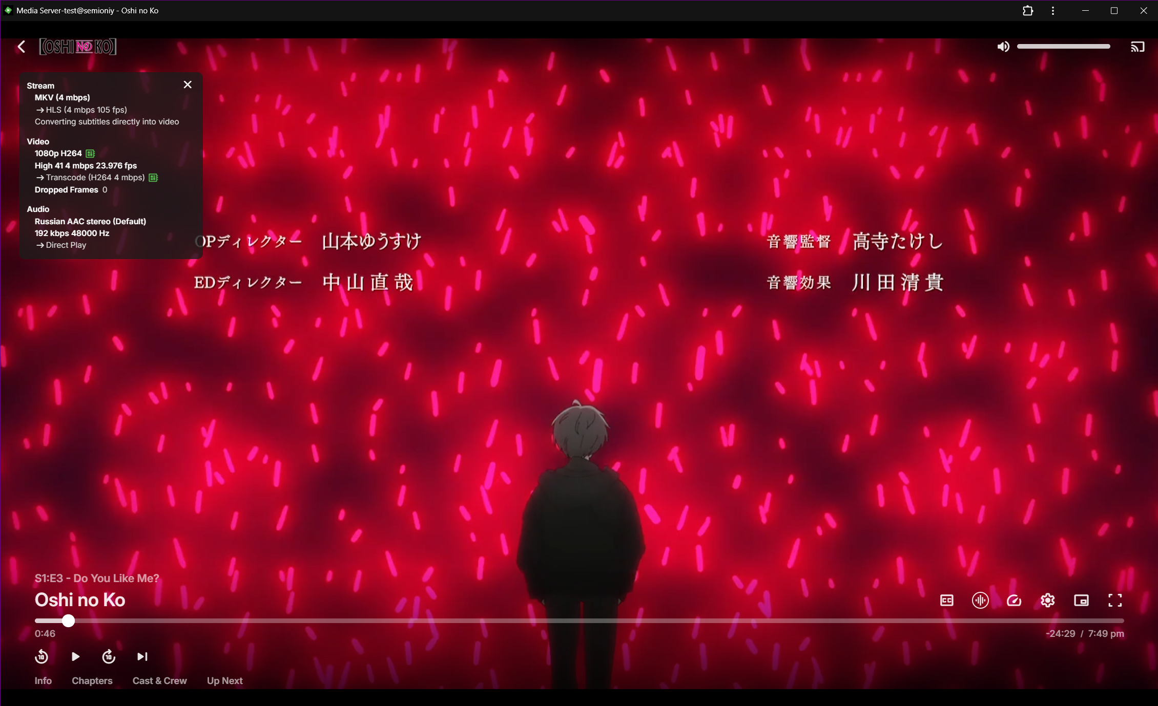

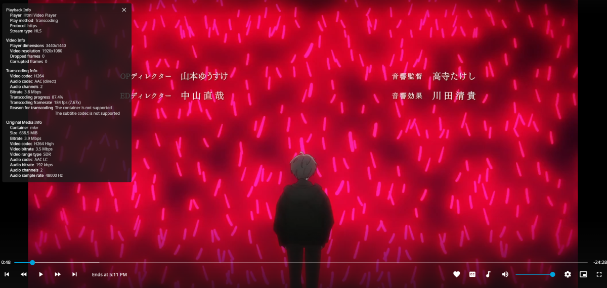

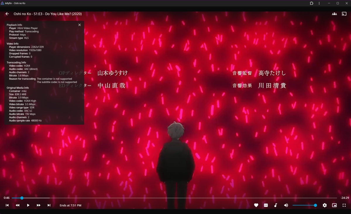

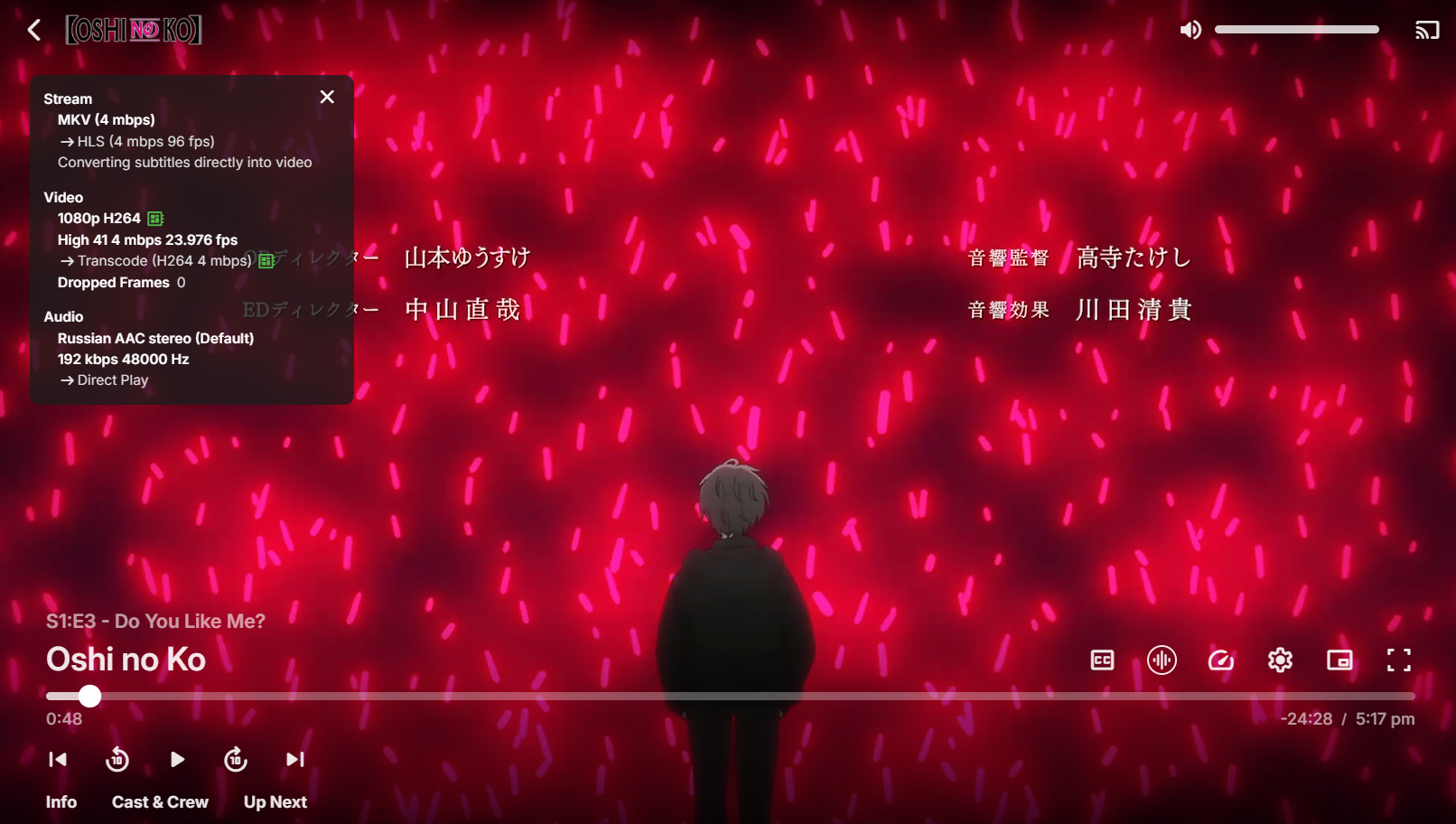

semioniy 4 Posted June 26, 2025 Posted June 26, 2025 (edited) Here's my attempt to test if smth is wrong with my GPU - I installed Jellyfin and set subtitles to burn in always. Despite the same bitrate, the quality seems much higher, so it's something in the transcoding settings that emby sets inefficiently (I guess). Emby HEVC (unwatchable): Emby H.264 (gradients are much better, but still somewhat blocky): Jellyfin H.264: Also, when seeking for a specific spot in player, emby needs 6-8 seconds to start playing when skipping to an unbuffered spot, while jellyfin starts playback right away. I will provide all the help to the emby team if they want to resolve this issue, which has been present from the day I tried HWA on Emby (2 years ago) P.S. I can also create and give you credentials to remotely access my local emby if needed Edited June 26, 2025 by semioniy
semioniy 4 Posted June 26, 2025 Posted June 26, 2025 (edited) I wouldn't call this result conclusive at all though - I redeployed everything, and emby and jellyfin switched places, the HWA transcode of emby looking better than that of jellyfin. I have no idea how and why, it just happened. The end result is not the point though - what would be nice is having any amount of control over that end result, instead of relying on that magical "backend will handle it somehow" thing My offer stands though: I've spun up an extra instance of emby for testing, as well as a jellyfin for comparison, and can give access to it if you need an edge-case to test - Running on UnRaid in docker, using Intel ARC GPU for transcoding. Access to configs / logs can also be done over nextcloud, I just need to create users for all that and send credentials. Edited June 26, 2025 by semioniy added images 1
