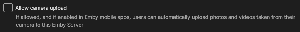

Juanrendon 4 Posted September 10, 2024 Posted September 10, 2024 Good morning, I would like to ask if there is a way to remove Upload from Camera permissions from users, since it is very uncomfortable when they use this function and clutter the media library with dozens of folders. I look forward to your help, thank you very much.
seanbuff 1356 Posted September 10, 2024 Posted September 10, 2024 13 minutes ago, Juanrendon said: I would like to ask if there is a way to remove Upload from Camera permissions from users You can uncheck this user option?
Juanrendon 4 Posted September 10, 2024 Author Posted September 10, 2024 15 minutes ago, seanbuff said: ¿Puedes desmarcar esta opción de usuario? Hello Seanbuff. Is this option in the new update? I mean I would have to update the server to have that option.
seanbuff 1356 Posted September 10, 2024 Posted September 10, 2024 (edited) 1 minute ago, Juanrendon said: Is this option in the new update? This is not a new option, no. What version of Emby Server are you currently running? Edited September 10, 2024 by seanbuff words 1

Juanrendon 4 Posted September 10, 2024 Author Posted September 10, 2024 Hace 8 minutos, Happy2Play dijo: Sí, estaba empezando a preguntarme lo mismo por otros temas. Estoy usando la versión 4.7.14.0
Juanrendon 4 Posted September 10, 2024 Author Posted September 10, 2024 17 minutes ago, seanbuff said: This is not a new option, no. What version of Emby Server are you currently running? I am using Version 4.7.14.0
Luke 42243 Posted September 10, 2024 Posted September 10, 2024 This new permission was added in Emby Server 4.8, so you'd have to update the server.
Juanrendon 4 Posted September 10, 2024 Author Posted September 10, 2024 7 minutes ago, Luke said: Este nuevo permiso se agregó en Emby Server 4.8, por lo que deberá actualizar el servidor. If I update the server, the metadata configuration is maintained, that is, I won't have to synchronize everything again, right?
