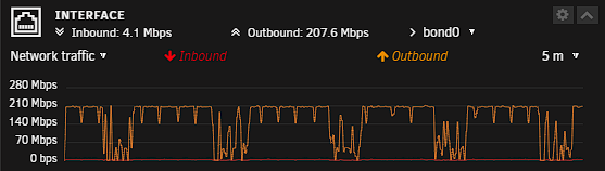

I’m encountering a really weird issue with Emby lately. When trying to play videos directly on an external network, Emby doesn’t work as expected. Here’s what happens:
  • My Unraid server goes into full bandwidth usage mode (about 200 Mbps), but when I check the network inspection in Chrome, the real bandwidth is barely hitting 1 Mbps.

This is how my internet traffic look like in 5 minutes chart

  • Solution
Update, I sort the issue out by adding cache bypass for videos to cloudflare. I follow suggestion from this post
(http.request.full_uri contains "https://emby.example.com/*videos/*/*")
  • Thanks 1
