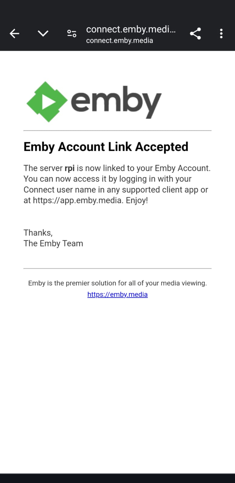

clhdjckbjjzjbvbek 2 Posted September 6, 2024 Author Posted September 6, 2024 5 hours ago, Luke said: Hi, that's strange. I would try redoing this part: By removing it, saving, and then adding it back. Please see if that helps. Thanks. @Luke tried it, still same result. I got a confirmation mail and I approved (attached) I also tried with incorrect password, and got a message saying its a wrong password. so I'm confident the mail and password Im providing are valid, but stil it just take me back to the "select server screen" what else can I do? @Happy2Play I'm not familiar with networking so much.. but I do know that an Android Emby server was able to stream outside of my network, and it used the exact same WIFI.

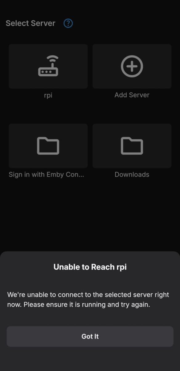

clhdjckbjjzjbvbek 2 Posted September 6, 2024 Author Posted September 6, 2024 yes, it couldn't connect. now what I did is remove all servers from my phone, and connected with Emby Connect it found the server, but this is the error I get when I click on it: of course it's up and running and no issues from local network

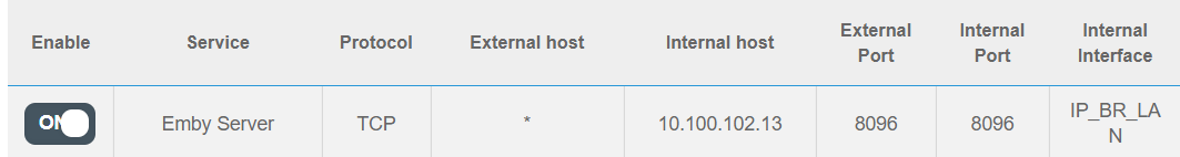

clhdjckbjjzjbvbek 2 Posted September 6, 2024 Author Posted September 6, 2024 I would mention that Im also not able to connect using the Remote (WAN) access that is listed on the dashboard. it will result in an error saying: Unable to Reach Server We're unable to connect to the selected server right now. please ensure it is running and try again I enabled port forwarding on my router:
