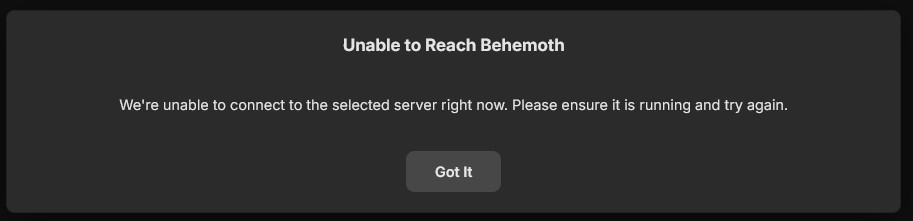

moriandrizzt 1 Posted September 5, 2024 Posted September 5, 2024 I was on one of the versions 4.7.x.x before upgrading to 4.8.8.0 and since then my emby connect has been throwing me the error "We're unable to connect to the selected server right now. Please ensure it is running and try again." I upgraded to a beta version 4.9.0.30 this morning to see if it would make a difference and it is still throwing this same error. I have tried removing the emby connect from my account on the server and re-adding it. I've also rebooted. I was originally running this on ubuntu 18.04 Gnome and now am using Mint Cinnamon (I forget the version but should be the latest). Everything was fine up until I upgraded emby this past Monday to 4.8.8.0. Almost forgot to mention that It is detecting my public ip just fine in emby. I'd like to downgrade to version 4.7.x.x but I can't find a download link for debian. I usually keep my debian files but somehow I've misplaced the last one. Thanks in advance!
