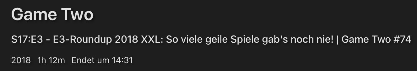

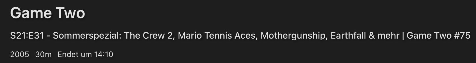

GrimReaper 4926 Posted September 6, 2024 Posted September 6, 2024 (edited) 23 minutes ago, nino12 said: Ouch. Here's the problem again. Where does the "S21" even come from? It comes from "21 - E31" part of your filename (...2018-07-21 - E31moRg7rD...) and results in S21:E31, same as 23 minutes ago, nino12 said: Question: Where does the "S17" even come from? comes from "17 - E3" part in that file (...2018-06-17 - E3-Roundup...) and results in S17:E3. What I don't understand is why do you have to have any episode title or extradata in your filename, all your episodes are already distinguished by airdate and you're using embedded titles that you'd see in the UI (even if you weren't, they'd still be distinct episodes based on airdate) - so if insisting on using TV shows type library, why don't you just dump all extradata except "ShowTitle - Airdate" and spare yourself some pain? Edited September 6, 2024 by GrimReaper
