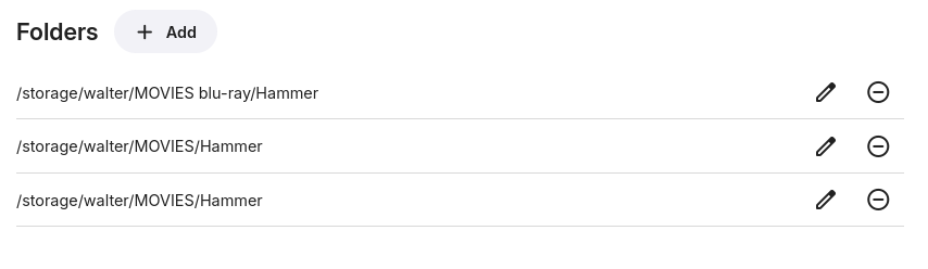

gogginguy 4 Posted September 4, 2024 Posted September 4, 2024 (edited) One of my servers shows my icons for Libraries, but all of the contents are suddenly empty. "Scan Library Files" doesn't update anything. The screenshot below shows three paths, the first two are original and contain content, yet none of the content is showing in the Library. When I added the third path (identical to the 2nd path), it found and added the single movie in that folder. Running 4.8.8.0 I wouldn't know what pertinent logs to send, given this behavior. (Please move this issue to Linux server -- unless there's a way for me to do it) Edited September 4, 2024 by gogginguy

gogginguy 4 Posted September 4, 2024 Author Posted September 4, 2024 7 minutes ago, Happy2Play said: Probably need to see the server log. Not sure if adding same path will do more harm than good though. Assuming there are no errors in the log usually only happens on new libraries but may need to toggle Access and Parental controls on that specific user. And maybe all users if more than one is affected. The duplicate is a temporary debug technique. I added a movie to the first path -- "Scan" didn't find it. I added it to the second (duplicated) path and it was found.

gogginguy 4 Posted September 4, 2024 Author Posted September 4, 2024 (edited) 1 hour ago, Happy2Play said: Should not affect a normal scan but you need to fix iNotify. The configured user limit (128) on the number of inotify instances has been reached, or the per-process limit on the number of open file descriptors has been reached. Nothing stands out as it is quering provider for movies. Reveal hidden contents Line 290: 2024-09-04 20:25:09.160 Info TheMovieDb: MovieDbProvider: Finding id for item: A Nightmare On Elm Street-7 Line 300: 2024-09-04 20:25:10.614 Info TheMovieDb: MovieDbProvider: Finding id for item: A Nightmare On Elm Street-12 Line 349: 2024-09-04 20:25:12.518 Info TheMovieDb: MovieDbProvider: Finding id for item: A Nightmare On Elm Street-13 Line 359: 2024-09-04 20:25:14.137 Info TheMovieDb: MovieDbProvider: Finding id for item: A Nightmare On Elm Street-14 Line 368: 2024-09-04 20:25:16.048 Info TheMovieDb: MovieDbProvider: Finding id for item: A Nightmare On Elm Street-15 Line 375: 2024-09-04 20:25:16.832 Info TheMovieDb: MovieDbProvider: Finding id for item: A Nightmare On Elm Street-18 Line 384: 2024-09-04 20:25:18.699 Info TheMovieDb: MovieDbProvider: Finding id for item: A Nightmare On Elm Street-21 Line 393: 2024-09-04 20:25:20.497 Info TheMovieDb: MovieDbProvider: Finding id for item: A Nightmare On Elm Street-23 Line 400: 2024-09-04 20:25:21.372 Info TheMovieDb: MovieDbProvider: Finding id for item: A Nightmare On Elm Street-26 Line 409: 2024-09-04 20:25:23.029 Info TheMovieDb: MovieDbProvider: Finding id for item: A Nightmare On Elm Street-56 Line 418: 2024-09-04 20:25:24.706 Info TheMovieDb: MovieDbProvider: Finding id for item: A Nightmare On Elm Street-61 Line 427: 2024-09-04 20:25:27.381 Info TheMovieDb: MovieDbProvider: Finding id for item: A Nightmare On Elm Street-62 Line 436: 2024-09-04 20:25:29.562 Info TheMovieDb: MovieDbProvider: Finding id for item: A Nightmare On Elm Street-68 Line 445: 2024-09-04 20:25:31.258 Info TheMovieDb: MovieDbProvider: Finding id for item: A Nightmare On Elm Street-78 Line 454: 2024-09-04 20:25:32.912 Info TheMovieDb: MovieDbProvider: Finding id for item: A Nightmare On Elm Street-82 Line 463: 2024-09-04 20:25:35.219 Info TheMovieDb: MovieDbProvider: Finding id for item: A Nightmare On Elm Street-83 Line 472: 2024-09-04 20:25:36.909 Info TheMovieDb: MovieDbProvider: Finding id for item: A Nightmare On Elm Street-84 Line 481: 2024-09-04 20:25:38.726 Info TheMovieDb: MovieDbProvider: Finding id for item: A Nightmare On Elm Street-90 Line 490: 2024-09-04 20:25:40.840 Info TheMovieDb: MovieDbProvider: Finding id for item: A Nightmare On Elm Street-94 Line 763: 2024-09-04 20:30:29.784 Info TheMovieDb: MovieDbProvider: Finding id for item: Ferris Bueller's Day Off_t00 Line 850: 2024-09-04 20:30:37.976 Info TheMovieDb: MovieDbProvider: Finding id for item: Ferris Bueller's Day Off_t01 Line 859: 2024-09-04 20:30:44.029 Info TheMovieDb: MovieDbProvider: Finding id for item: Ferris Bueller's Day Off_t02 Line 868: 2024-09-04 20:30:52.055 Info TheMovieDb: MovieDbProvider: Finding id for item: Ferris Bueller's Day Off_t03 Line 877: 2024-09-04 20:30:54.168 Info TheMovieDb: MovieDbProvider: Finding id for item: Ferris Bueller's Day Off_t04 Line 886: 2024-09-04 20:30:56.382 Info TheMovieDb: MovieDbProvider: Finding id for item: Ferris Bueller's Day Off_t05 Line 895: 2024-09-04 20:30:58.583 Info TheMovieDb: MovieDbProvider: Finding id for item: Ferris Bueller's Day Off_t06 Line 904: 2024-09-04 20:31:01.030 Info TheMovieDb: MovieDbProvider: Finding id for item: Ferris Bueller's Day Off_t07 Line 1006: 2024-09-04 20:33:01.635 Info TheMovieDb: MovieDbProvider: Finding id for item: BENNY LOVES YOU-A Line 1131: 2024-09-04 20:36:30.429 Info TheMovieDb: MovieDbProvider: Finding id for item: BENNY LOVES YOU-A Line 1253: 2024-09-04 20:37:49.890 Info TheMovieDb: MovieDbProvider: Finding id for item: BLOOD AND BLACK LACE Line 1318: 2024-09-04 20:37:56.546 Info TheMovieDb: MovieDbProvider: Finding id for item: RASHOMON Line 1376: 2024-09-04 20:38:01.875 Info TheMovieDb: MovieDbProvider: Finding id for item: THE CAT O NINE TAILS-A Line 1399: 2024-09-04 20:38:04.019 Info TheMovieDb: MovieDbProvider: Finding id for item: THE PRIZE Line 1408: 2024-09-04 20:38:04.822 Info TheMovieDb: MovieDbProvider: Finding id for item: THE PROFESSIONALS Line 1424: 2024-09-04 20:38:06.203 Info TheMovieDb: MovieDbProvider: Finding id for item: THE WOMAN IN WHITE Line 1449: 2024-09-04 20:38:08.383 Info TheMovieDb: MovieDbProvider: Finding id for item: THROUGH A GLASS DARKLY-A Line 1458: 2024-09-04 20:38:09.183 Info TheMovieDb: MovieDbProvider: Finding id for item: WHEELER DEALERS Line 1501: 2024-09-04 20:43:02.703 Info TheMovieDb: MovieDbProvider: Finding id for item: BENNY LOVES YOU-A Line 1669: 2024-09-04 21:04:01.703 Info TheMovieDb: MovieDbProvider: Finding id for item: TOY STORY-A If libraries are not showing items then you will need to try toggling Access control and Parental controls on the user as some thing has happened to permission is my guess. Have you tested with a different user? Unfortunately, I'm the only user. All the titles scanned in the list provided were added in an attempt to troubleshoot this problem. Access is full permission. No entries for "Block items..." Edited September 4, 2024 by gogginguy updated information to pass along
Happy2Play 9812 Posted September 4, 2024 Posted September 4, 2024 1 minute ago, gogginguy said: Unfortunately, I'm the only user. All the titles scanned in the list provided were added in an attempt to troubleshoot this problem. Question: If Access/Parental controls are the issue, why are newly added titles showing up? Not sure as it could be something stuck/broken per those options as I have created new libraries to only have it show via library setup and no where else. But yes you issues sound slightly different but suggest something broken in the database and the user. Can you test creating a new test user?
gogginguy 4 Posted September 5, 2024 Author Posted September 5, 2024 (edited) New user has the same issue. And why would the old/new user have permissions on some files and not all the files? The test files were picked at random, so it wouldn't be any file attributes. 1. The path/file locations haven't changed and are present. 2. Duplicate path/file locations deliver as expected. 3. It's not the user. 4. It's not the attributes on the files. 5. Parental/Access are full/appropriate. Has anyone experienced this behavior after upgrading to 4.8.8.0 which happened 2 months ago, but I did not confirm that the titles were there anytime after the upgrade. I might have, but I can't be sure. Is there a setting which would force "Scan" to consider all paths and titles regardless of flags/state? Edited September 5, 2024 by gogginguy new question added

gogginguy 4 Posted October 16, 2024 Author Posted October 16, 2024 First, no I haven't upgraded. I did not find a graceful way to do this, so I had to cobble-together backup files from a month ago and do I restore and they all came back. Then... It happened again last week, and I had a restore again to get them back. At first I thought this was due to librariy locations "sharing" with other servers and eliminated that practice, but with it happening again, I believe this wasn't the cause. I'm guessing this is a somewhat acute occurrence. I will be upgrading soon and see if that solves anything. Is there reason to believe this is a version issue?
Luke 42243 Posted October 21, 2024 Posted October 21, 2024 On 10/16/2024 at 9:56 AM, gogginguy said: I will be upgrading soon and see if that solves anything. Is there reason to believe this is a version issue? @gogginguy I think it will help rule things out. Also can you please list out how many Emby libraries you've created, along with the folder paths that are added to each one? Thanks !
