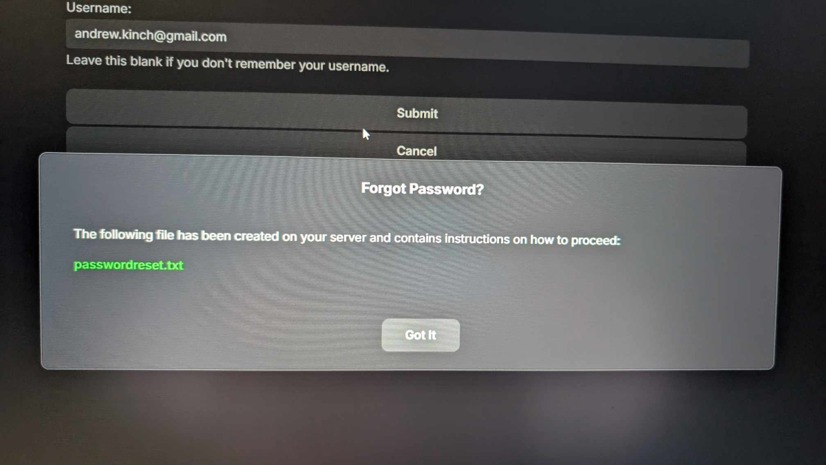

pattang_21 4 Posted September 4, 2024 Posted September 4, 2024 Hi, I have a friend who I share content with. He was logged out today and then was unable to log back in. When attempting to reset the password he got this message. I don't know where to look for this file as the server owner. I tried resetting his password via the user interface but nothing has worked. Any help would be appreciated.

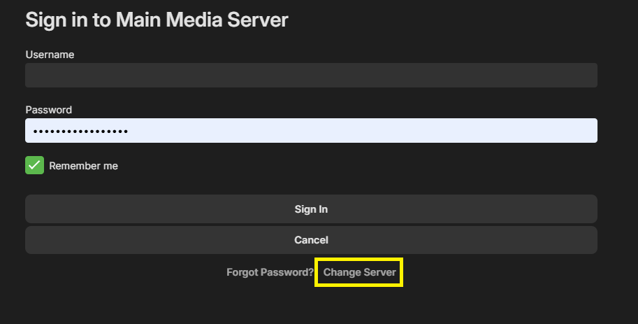

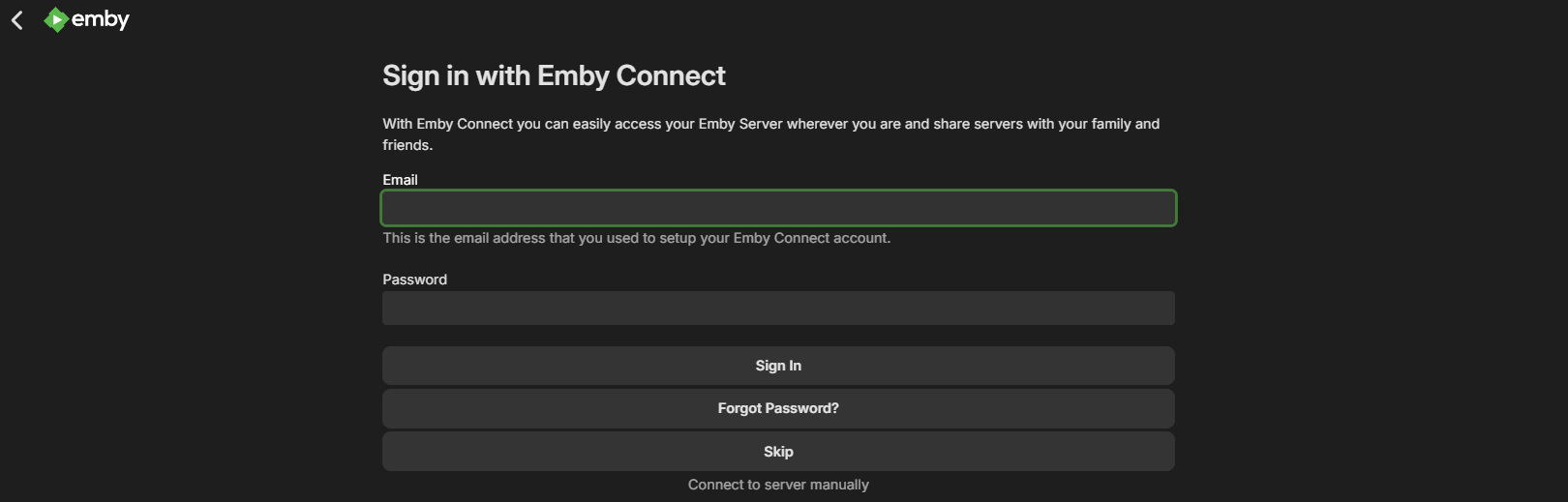

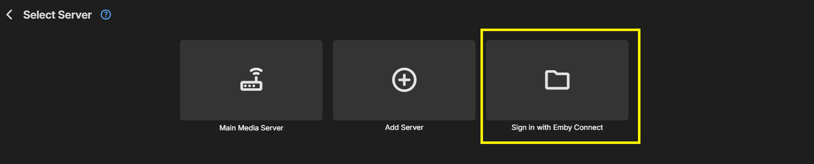

Happy2Play 9798 Posted September 4, 2024 Posted September 4, 2024 You cannot reset Connect password from that login screen as it is technical the local login screen and is only for local password reset. Not sure of the client of options on screen but have to change servers. And use Forgot password here Or this page Forgot Password - Emby Community
Happy2Play 9798 Posted September 4, 2024 Posted September 4, 2024 You may need to unlink the Connect user and relink the user that same way you added them if they are still having issues.

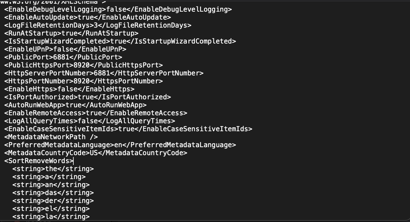

pattang_21 4 Posted September 4, 2024 Author Posted September 4, 2024 The port is not open. I checked my router and the new system even though I deleted emby still has control over that port for some reason. I then attempted switch all the ports to a different port I opened but now I cannot access the ui at all with any of those port internally. I attempted to follow your instructions here But after getting to the system.xml file I don't know what the next step is. I tried opening it on textedit on my mac but then got shouted at with symbols so I panicked and ran away. What would be the next step here? Thank you for your help @Happy2Play
Happy2Play 9798 Posted September 4, 2024 Posted September 4, 2024 Are you on the same machine as the server? Did you change the port in your url to whatever you changed it to in Emby? But the system.xml is just a text file are you sure you opened the correct file?

Happy2Play 9798 Posted September 4, 2024 Posted September 4, 2024 Assuming your qnap is on that address yes. But are you sure that is a free port? As goggles says "Ports 6881 through 6999 are dedicated to BitTorrent,"

Happy2Play 9798 Posted September 4, 2024 Posted September 4, 2024 Shut down Emby, change publicport and httpserverportnumber 6881 back to 8096 or whatever you had it at previously and start Emby.
Happy2Play 9798 Posted September 4, 2024 Posted September 4, 2024 (edited) Or rename/delete the system.xml and allow it to regenerate as not a lot is changed from default and just step through the startup wizard. Edited September 4, 2024 by Happy2Play 1
pattang_21 4 Posted September 4, 2024 Author Posted September 4, 2024 You all rock. I fixed it all with your instructions. Have an awesome day team!
