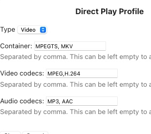

Fjunillon 4 Posted October 24, 2024 Author Posted October 24, 2024 OK, to be sure the box could read something, I made some standard converted movies. I took one video and made 6 different converted targets (a mix of mp4, mkv, mpeg, h264, aac, mp3). Then I took an usb card and try reading it on the box. Surprise, each one could be read. So came back on dlna and none could be read. It jumps from one to one until it reaches the end of the list. The last thing I can see in my tcp catch is : 13:59:58.877081 IP sia.fiji.local.8096 > 192.168.1.10.51008: Flags [P.], seq 11585:12587, ack 784, win 504, options [nop,nop,TS val 154595010 8 ecr 147931389], length 1002 E...(Z@.@..]....... ...@cJiLd........3..... \%S...@.Item.movie</upnp:class><res duration="0:09:56.45" size="288252880" resolution="1920x1080" bitrate="3866193" protocolInfo="ht tp-get:*:video/mpeg:DLNA.ORG_PN=MPEG_TS_SD_NA_ISO;DLNA.ORG_OP=01;DLNA.ORG_CI=0;DLNA.ORG_FLAGS=21D00000000000000000000000000000">http://192.168.1.200:8096/videos/7/original.mpegts?DeviceId=24ff0e6d976c7ecb2df40e7f949bf39c&amp;MediaSourceId=424aa0fd80f30049291434afd6feb1ed&amp;PlaySessionId=78e1b787808d8864cfe4864568168f4e&amp;api_key=47f63cd17df043049a2bb6aa99f49469</res><upnp:albumArtURI dlna:profileID="JPEG_SM">http://192.168.1.200:8096/Items/7/Images/Primary/0/a52f8ad0a834cf6cb0c9c5dcb4e27e1a/jpg/640/480/0/0</upnp:albumArtURI><upnp:icon>http://192.168.1.200:8096/Items/7/Images/Primary/0/a52f8ad0a834cf6cb0c9c5dcb4e27e1a/jpg/48/48/0/0</upnp:icon></item></DIDL-Lite></Result><NumberReturned>6</NumberReturned><TotalMatches>6</TotalMatches><UpdateID>2334</UpdateID></u:BrowseResponse></s:Body></s:Envelope> I guess the last video tried in mpeg and nothing else. So strange. tcpdump.txt
Luke 42243 Posted October 28, 2024 Posted October 28, 2024 Quote I took one video and made 6 different converted targets (a mix of mp4, mkv, mpeg, h264, aac, mp3). Then I took an usb card and try reading it on the box. Surprise, each one could be read. Then maybe you can add them to the direct play profiles and avoid the transcoding?
Fjunillon 4 Posted October 28, 2024 Author Posted October 28, 2024 well... that's exactly what I though, but it's not working Unless I made a mistake ?

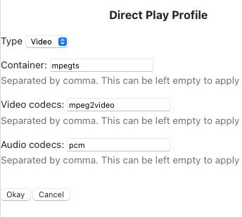

Fjunillon 4 Posted October 31, 2024 Author Posted October 31, 2024 OK, I made it work through plexmediaserver . And I clearly don't understand why emby does not go well. here what I have in emby : and here is what I have in my plexmedia xml profile <!-- Forcing transcode for every codec --> <TranscodeTargets> <VideoProfile container="mpegts" codec="mpeg2video" audioCodec="pcm"> <MediaConditions> <AllowDirectPlay>false</AllowDirectPlay> <!-- Disables DirectStream --> </MediaConditions> </VideoProfile> </TranscodeTargets> what's the difference ?
Fjunillon 4 Posted November 1, 2024 Author Posted November 1, 2024 exactly the same, impossible to read the file....
