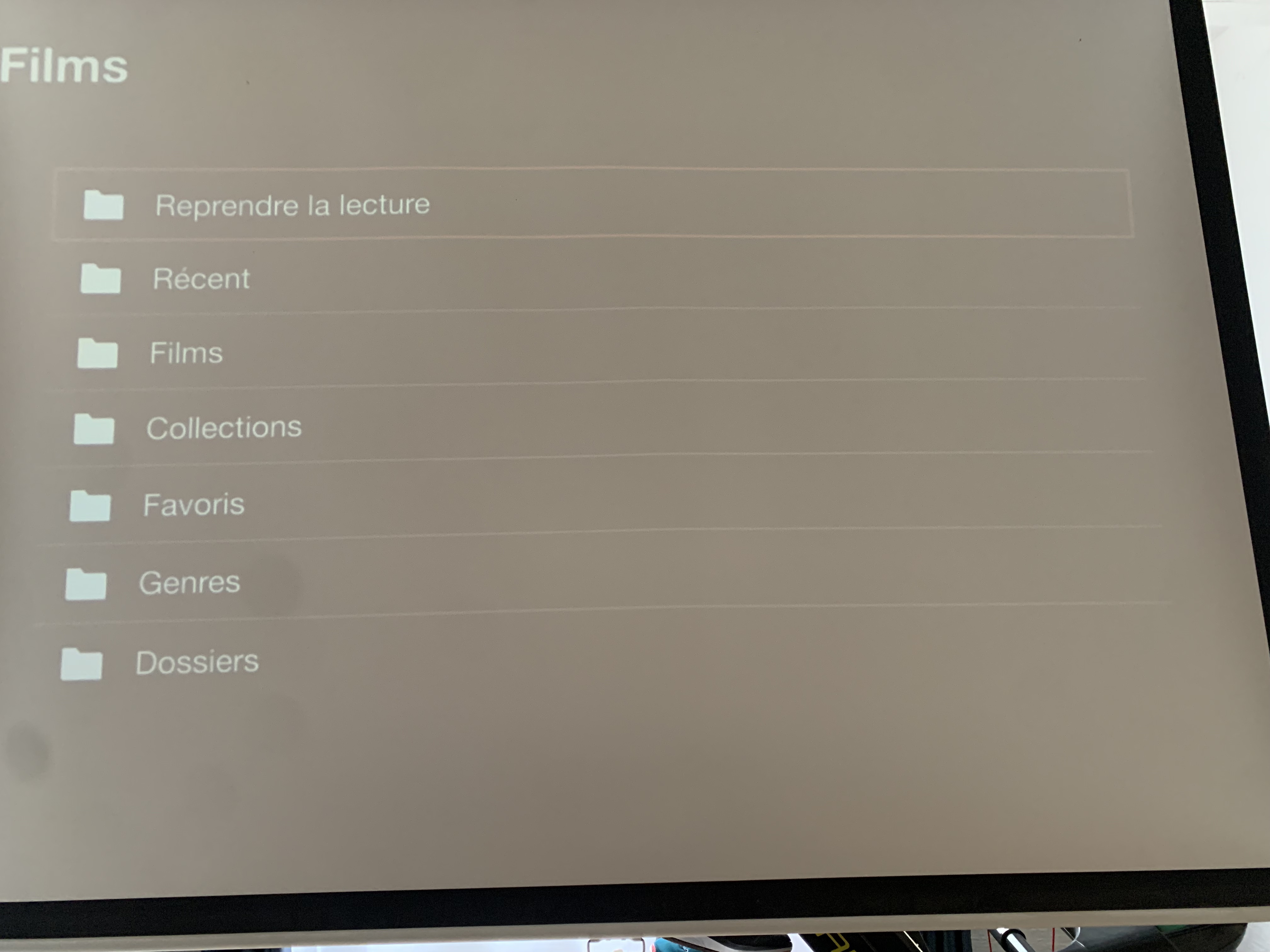

Fjunillon 4 Posted September 3, 2024 Posted September 3, 2024 Hi all I have a strange problem very specific (well...it seems to) with my provider video box. My Emby Server 4.8.8 is runinng on a little linux (raspi/os) and going well. I can access movies from smartphone, web nav, amazon firetv. But... From this video box (Orange for french reference) this is impossible to read a movie. I can see my Emby instance, navigate through lists but each time I want to read one, I got an "impossible to read" message. If I go in the log here is the guilty process. http://192.168.1.200:8096/videos/419/original.mkv%3FDeviceId=24ff0e6d976c7ecb2df40e7f949bf39c&MediaSourceId=1f287d01ca5e71f36cfc162799f9d98a&PlaySessionId=02d12ecd5aef734fafe5d9f54d0a765a&api_key=2f6a39bf5acf483ebf4e42c796e4cfb2. Connection=keep-alive, Host=host3, User-Agent=GStreamer souphttpsrc 1.22.1 libsoup/2.70.0, Accept-Encoding=identity, icy-metadata=1 2024-09-03 10:50:06.596 Debug App: Access token is invalid or expired: . 2024-09-03 10:50:06.600 Warn Server: AUTH-ERROR: 192.168.1.10 - Access token is invalid or expired. 2024-09-03 10:50:06.608 Error Server: Access token is invalid or expired. 2024-09-03 10:50:06.618 Info Server: http/1.1 Response 401 to host2. Time: 27ms. GET I searched forums but can't make it work. Trying to change clock on the box is impossible, synchronize with emby also... I create a specific profile for the device as I know it's not a very developed one. I was using plexmedia before emby, and it was OK but I had to create a profile also. 2024-09-03 10:49:34.409 Debug DLNA: Attempting to create PlayToController from location http://192.168.1.10:42300/description.xml 2024-09-03 10:49:34.412 Debug HttpClient: GET http://192.168.1.10:42300/description.xml 2024-09-03 10:49:34.427 Debug DLNA: Device Manufacturer: SoftAtHome 2024-09-03 10:49:34.427 Debug DLNA: Device Model Name: SoftAtHome Media Renderer 2024-09-03 10:49:34.427 Debug DLNA: Found device name Décodeur TV UHD from device properties 2024-09-03 10:49:34.427 Debug DLNA: Dlna Device.Start 2024-09-03 10:49:34.429 Info DLNA: DLNA Session created for Décodeur TV UHD - SoftAtHome Media Renderer. Description url: http://192.168.1.10:42300/description.xml 2024-09-03 10:49:34.929 Info HttpClient: GET http://192.168.1.10:42300/AVTransport/scpd.xml If anyone has a clue I will be very happy

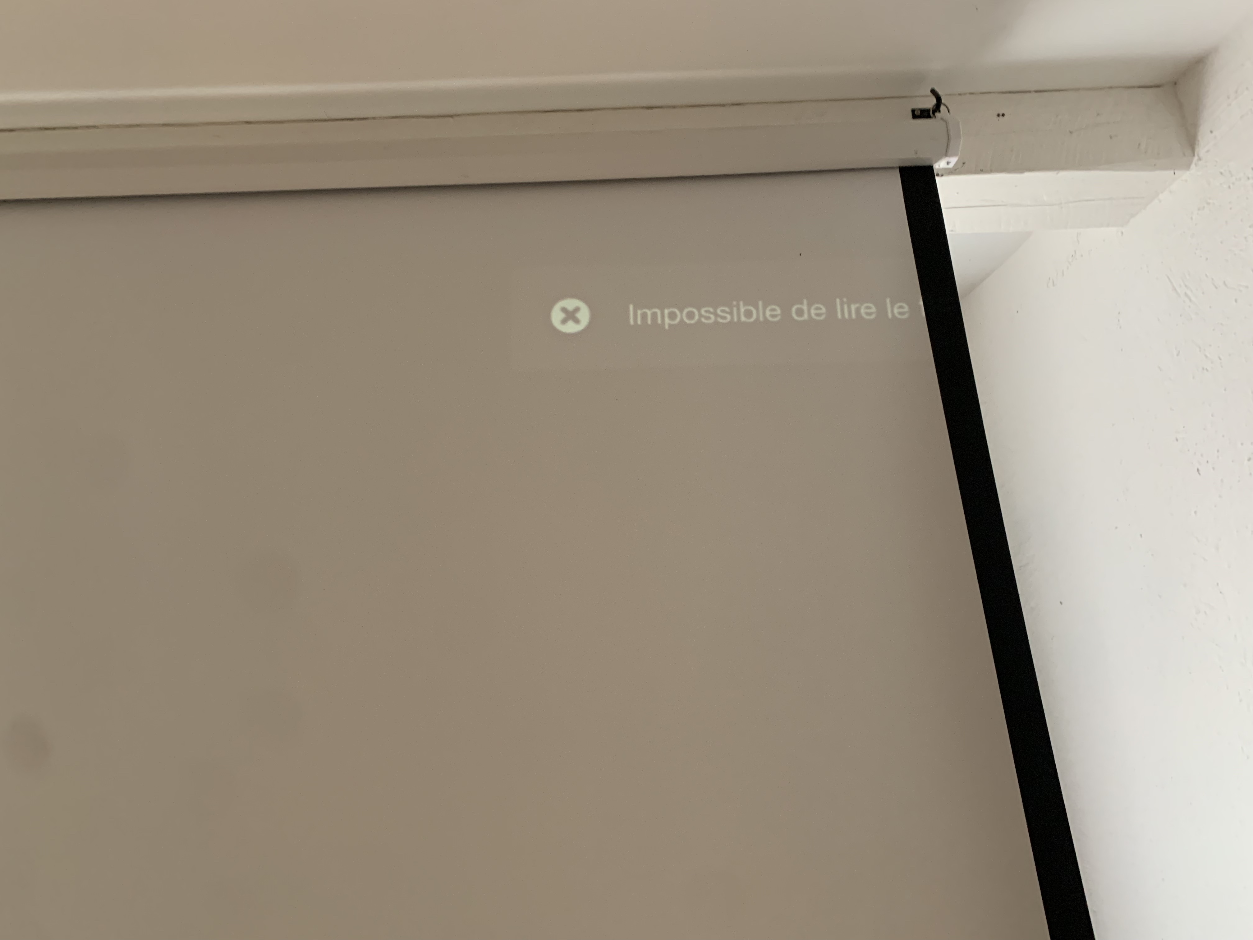

Fjunillon 4 Posted September 15, 2024 Author Posted September 15, 2024 when asking for a movie, the box tries but gives an error. The all movie list is ok, I can select one and when I ask for it I get an "impossible to read the movie" (sshot). I tried different format, encode style etc. Nothing.

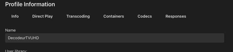

Fjunillon 4 Posted October 13, 2024 Author Posted October 13, 2024 I got clues from the french forum and as far as I understand log, the answer of the video box confirm that. Did I understood well ? 2024-10-12 13:06:49.544 Info DLNA: DLNA Session created for Décodeur TV UHD - SoftAtHome Media Renderer. Description url: http://192.168.1.10:42300/description.xml 2024-10-12 13:06:50.045 Info HttpClient: GET http://192.168.1.10:42300/AVTransport/scpd.xml 2024-10-12 13:06:59.295 Info HttpClient: GET http://192.168.1.10:42300/ConnectionManager/scpd.xml 2024-10-12 13:06:59.307 Info DLNA: Device GetProtocolInfoResponse Source: 2024-10-12 13:06:59.307 Info DLNA: Device GetProtocolInfoResponse Sink: http-get:*:text/xml:DLNA.ORG_PN=DIDL_S http-get:*:image/jpeg:DLNA.ORG_PN=JPEG_SM_ICO http-get:*:image/jpeg:DLNA.ORG_PN=JPEG_LRG_ICO http-get:*:image/jpeg:DLNA.ORG_PN=JPEG_TN http-get:*:image/jpeg:DLNA.ORG_PN=JPEG_SM http-get:*:image/jpeg:DLNA.ORG_PN=JPEG_MED http-get:*:image/jpeg:DLNA.ORG_PN=JPEG_LRG http-get:*:image/png:DLNA.ORG_PN=PNG_SM_ICO http-get:*:image/png:DLNA.ORG_PN=PNG_LRG_ICO http-get:*:image/png:DLNA.ORG_PN=PNG_TN http-get:*:audio/L16;channels=1;rate=44100:DLNA.ORG_PN=LPCM http-get:*:audio/L16;channels=2;rate=44100:DLNA.ORG_PN=LPCM http-get:*:audio/L16;channels=1;rate=48000:DLNA.ORG_PN=LPCM http-get:*:audio/L16;channels=2;rate=48000:DLNA.ORG_PN=LPCM http-get:*:video/vnd.dlna.mpeg-tts:DLNA.ORG_PN=MPEG_TS_SD_EU http-get:*:video/vnd.dlna.mpeg-tts:DLNA.ORG_PN=MPEG_TS_SD_EU_T http-get:*:video/mpeg:DLNA.ORG_PN=MPEG_TS_SD_EU_ISO http-get:*:video/vnd.dlna.mpeg-tts:DLNA.ORG_PN=MPEG_TS_SD_NA http-get:*:video/vnd.dlna.mpeg-tts:DLNA.ORG_PN=MPEG_TS_SD_NA_T http-get:*:video/mpeg:DLNA.ORG_PN=MPEG_TS_SD_NA_ISO http-get:*:video/vnd.dlna.mpeg-tts:DLNA.ORG_PN=MPEG_TS_SD_KO http-get:*:video/vnd.dlna.mpeg-tts:DLNA.ORG_PN=MPEG_TS_SD_KO_T http-get:*:video/mpeg:DLNA.ORG_PN=MPEG_TS_SD_KO_ISO http-get:*:video/mpeg:DLNA.ORG_PN=MPEG_PS_NTSC http-get:*:video/mpeg:DLNA.ORG_PN=MPEG_PS_PAL http-get:*:image/jpeg:* http-get:*:image/gif:* http-get:*:image/png:* http-get:*:audio/wav:* http-get:*:audio/x-wav:* http-get:*:audio/wave:* http-get:*:audio/mp4:* http-get:*:audio/x-mp4:* http-get:*:audio/mpeg4:* http-get:*:audio/x-mpeg4:* http-get:*:audio/m4a:* http-get:*:audio/x-m4a:* http-get:*:audio/3gpp:* http-get:*:audio/aac:* http-get:*:audio/flac:* http-get:*:audio/x-flac:* http-get:*:audio/ogg:* http-get:*:audio/vorbis:* http-get:*:video/x-divx:* http-get:*:video/x-matroska:* http-get:*:video/x-msvideo:* http-get:*:video/avi:* http-get:*:video/msvideo:* http-get:*:video/vnd.avi:* http-get:*:audio/avi:* http-get:*:audio/x-matroska:* http-get:*:video/mp2t:* http-get:*:video/vnd.dlna.mpeg-tts:* http-get:*:video/mp1s:* http-get:*:video/mp2p:* http-get:*:video/mpeg:* http-get:*:video/mpeg2:* http-get:*:video/mpv:* http-get:*:video/mp4:* http-get:*:video/x-mp4:* http-get:*:video/mov:* http-get:*:video/quicktime:* http-get:*:video/x-quicktime:* http-get:*:text/m3u:* http-get:*:audio/x-mpegurl:* http-get:*:audio/x-scpls:* http-get:*:application/vnd.ms-wpl:* http-get:*:video/x-ms-asf:* So, writing this is right, no ? Quote <TranscodingProfile container="mpegts" type="Video" videoCodec="mpeg2video" audioCodec="pcm" But then why, when trying an mp4/aac movie, the server is not transcoding it, just like if it does not care about the profile ? embyserver-63864374400.txt
Luke 42243 Posted October 13, 2024 Posted October 13, 2024 10 hours ago, Fjunillon said: I got clues from the french forum and as far as I understand log, the answer of the video box confirm that. Did I understood well ? 2024-10-12 13:06:49.544 Info DLNA: DLNA Session created for Décodeur TV UHD - SoftAtHome Media Renderer. Description url: http://192.168.1.10:42300/description.xml 2024-10-12 13:06:50.045 Info HttpClient: GET http://192.168.1.10:42300/AVTransport/scpd.xml 2024-10-12 13:06:59.295 Info HttpClient: GET http://192.168.1.10:42300/ConnectionManager/scpd.xml 2024-10-12 13:06:59.307 Info DLNA: Device GetProtocolInfoResponse Source: 2024-10-12 13:06:59.307 Info DLNA: Device GetProtocolInfoResponse Sink: http-get:*:text/xml:DLNA.ORG_PN=DIDL_S http-get:*:image/jpeg:DLNA.ORG_PN=JPEG_SM_ICO http-get:*:image/jpeg:DLNA.ORG_PN=JPEG_LRG_ICO http-get:*:image/jpeg:DLNA.ORG_PN=JPEG_TN http-get:*:image/jpeg:DLNA.ORG_PN=JPEG_SM http-get:*:image/jpeg:DLNA.ORG_PN=JPEG_MED http-get:*:image/jpeg:DLNA.ORG_PN=JPEG_LRG http-get:*:image/png:DLNA.ORG_PN=PNG_SM_ICO http-get:*:image/png:DLNA.ORG_PN=PNG_LRG_ICO http-get:*:image/png:DLNA.ORG_PN=PNG_TN http-get:*:audio/L16;channels=1;rate=44100:DLNA.ORG_PN=LPCM http-get:*:audio/L16;channels=2;rate=44100:DLNA.ORG_PN=LPCM http-get:*:audio/L16;channels=1;rate=48000:DLNA.ORG_PN=LPCM http-get:*:audio/L16;channels=2;rate=48000:DLNA.ORG_PN=LPCM http-get:*:video/vnd.dlna.mpeg-tts:DLNA.ORG_PN=MPEG_TS_SD_EU http-get:*:video/vnd.dlna.mpeg-tts:DLNA.ORG_PN=MPEG_TS_SD_EU_T http-get:*:video/mpeg:DLNA.ORG_PN=MPEG_TS_SD_EU_ISO http-get:*:video/vnd.dlna.mpeg-tts:DLNA.ORG_PN=MPEG_TS_SD_NA http-get:*:video/vnd.dlna.mpeg-tts:DLNA.ORG_PN=MPEG_TS_SD_NA_T http-get:*:video/mpeg:DLNA.ORG_PN=MPEG_TS_SD_NA_ISO http-get:*:video/vnd.dlna.mpeg-tts:DLNA.ORG_PN=MPEG_TS_SD_KO http-get:*:video/vnd.dlna.mpeg-tts:DLNA.ORG_PN=MPEG_TS_SD_KO_T http-get:*:video/mpeg:DLNA.ORG_PN=MPEG_TS_SD_KO_ISO http-get:*:video/mpeg:DLNA.ORG_PN=MPEG_PS_NTSC http-get:*:video/mpeg:DLNA.ORG_PN=MPEG_PS_PAL http-get:*:image/jpeg:* http-get:*:image/gif:* http-get:*:image/png:* http-get:*:audio/wav:* http-get:*:audio/x-wav:* http-get:*:audio/wave:* http-get:*:audio/mp4:* http-get:*:audio/x-mp4:* http-get:*:audio/mpeg4:* http-get:*:audio/x-mpeg4:* http-get:*:audio/m4a:* http-get:*:audio/x-m4a:* http-get:*:audio/3gpp:* http-get:*:audio/aac:* http-get:*:audio/flac:* http-get:*:audio/x-flac:* http-get:*:audio/ogg:* http-get:*:audio/vorbis:* http-get:*:video/x-divx:* http-get:*:video/x-matroska:* http-get:*:video/x-msvideo:* http-get:*:video/avi:* http-get:*:video/msvideo:* http-get:*:video/vnd.avi:* http-get:*:audio/avi:* http-get:*:audio/x-matroska:* http-get:*:video/mp2t:* http-get:*:video/vnd.dlna.mpeg-tts:* http-get:*:video/mp1s:* http-get:*:video/mp2p:* http-get:*:video/mpeg:* http-get:*:video/mpeg2:* http-get:*:video/mpv:* http-get:*:video/mp4:* http-get:*:video/x-mp4:* http-get:*:video/mov:* http-get:*:video/quicktime:* http-get:*:video/x-quicktime:* http-get:*:text/m3u:* http-get:*:audio/x-mpegurl:* http-get:*:audio/x-scpls:* http-get:*:application/vnd.ms-wpl:* http-get:*:video/x-ms-asf:* So, writing this is right, no ? But then why, when trying an mp4/aac movie, the server is not transcoding it, just like if it does not care about the profile ? embyserver-63864374400.txt 21.12 kB · 0 downloads Hi, I don't know. You have to just keep trying combinations of containers and codecs until you can get it to play. The player says it supports all those things, and yet, here you are trying to force it to transcode because it doesn't seem to be able to handle anything. Unfortunately many players report incorrect data from those endpoints.
Fjunillon 4 Posted October 14, 2024 Author Posted October 14, 2024 OK, thanks for that. Just to go on, where can I find docs on that (directPlay, transcoding, Containers...?), because... that's not clear for me ( :D )
Luke 42243 Posted October 15, 2024 Posted October 15, 2024 I think mpegts for the container will be your best bet. For the video codec I would try h264 and mpeg2video. For audio I would try aac and mp3.
