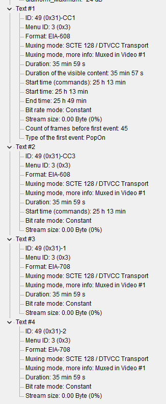

When I select Play I see:
MediaInfo shows:
I have attached debug server and ffmpeg logs.

Using ffmpeg -i option only on the recorded .ts file shows this:
Input #0, mpegts, from 'Wheel of Fortune S40E93.ts':
  Duration: 00:34:59.71, start: 18856.833167, bitrate: 9673 kb/s
  Program 3
  Stream #0:0[0x31]: Video: h264 (High) ([27][0][0][0] / 0x001B), yuv420p(tv, top first), 1920x1080 [SAR 1:1 DAR 16:9], 29.97 fps, 29.97 tbr, 90k tbn
  Stream #0:1[0x34](eng): Audio: ac3 ([129][0][0][0] / 0x0081), 48000 Hz, 5.1(side), fltp, 384 kb/s
So ffmpeg sees no subtitles or closed caption either. Yet MedioInfo does.

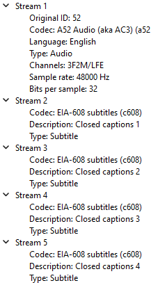

VLC also does:
