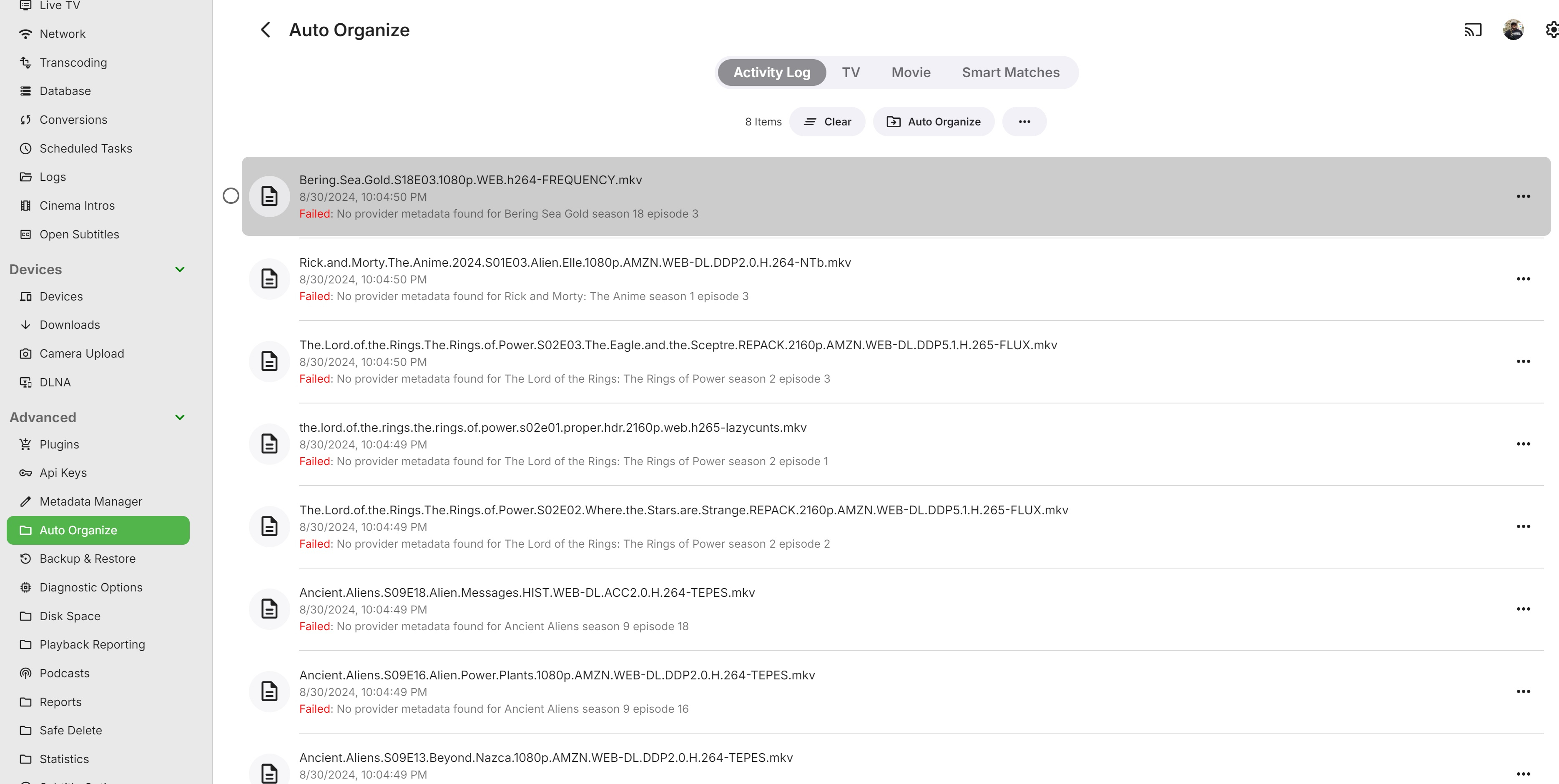

diaz1510 154 Posted August 31, 2024 Posted August 31, 2024 I'm now no longer getting any metadata for any shows in auto-organize. Manually OR automatically. I've got everything set properly. This is for ALL media now.
