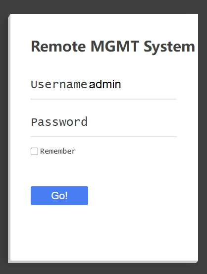

Alexmh 2 Posted August 31, 2024 Author Posted August 31, 2024 9 minutes ago, Happy2Play said: Maybe something the "Remote MGMT System" on port 80? But is something wonky on this network. I didn't exactly caught the question but I don't have anything running on port 80. Also port 80 is forwarded for my outdoor camera, if it has any relevance.

Happy2Play 9814 Posted August 31, 2024 Posted August 31, 2024 (edited) 30 minutes ago, Alexmh said: I didn't exactly caught the question but I don't have anything running on port 80. Also port 80 is forwarded for my outdoor camera, if it has any relevance. Looks like port 80 goes to whatever the "Remote MGMT System" so would think all your DomainName traffic should terminate there. As the domainname above resolves to your IP address. Edited August 31, 2024 by Happy2Play

Alexmh 2 Posted August 31, 2024 Author Posted August 31, 2024 7 minutes ago, Happy2Play said: Looks like port 80 goes to whatever the "Remote MGMT System" so would think all your DomainName traffic should terminate there. As the domainname above resolves to your IP address. yes this is my outside security camera. I can access it through port 80 for web interface, and another port for streaming on my phone or PC App.
