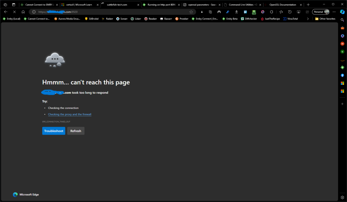

gihayes 47 Posted September 2, 2024 Author Posted September 2, 2024 I can access via http using both my.domain.com:8096 and my http://WAN IP:8096 using phone disconnected from wi-fi (Remote). I can access via http using local IP:8096 or machine name:8096 or localhost:8096 using computer (Local). I can access via http using my domain name:8096 and local IP:8096 using my phone connected to wi-fi (Local). This has been working all along. Trying to access via https using WAN IP:8920, Local IP:8920, or Domain name:8920 gets me the 'Cannot Reach' webpage whether I am trying to connect from the local network or from the internet. I apreciate your efforts in helping me figure this out. I found system.XML <HttpsPortNumber>8920</HttpsPortNumber> <EnableHttps>true</EnableHttps> <CertificatePath>C:\Users\xxxxxxx\AppData\Roaming\Emby-Server\system\xxxxxxx_2024\xxxxxxx_2024.pfx</CertificatePath> <IsPortAuthorized>true</IsPortAuthorized> <AutoRunWebApp>true</AutoRunWebApp> <EnableRemoteAccess>true</EnableRemoteAccess> <LogAllQueryTimes>false</LogAllQueryTimes>

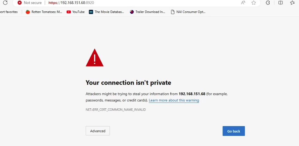

Happy2Play 9814 Posted September 2, 2024 Posted September 2, 2024 Okay so http connections work without issue. If you are not getting cert_common_name_invalid using https://192.168.0.35:8920 I would think there is something wrong with your certificate. But at the same time I would think Emby would be throwing errors on it. But worst case have you tried a different port then 8920?
rbjtech 5345 Posted September 2, 2024 Posted September 2, 2024 On 30/08/2024 at 21:58, gihayes said: The server has responsed via https - and it closed the connection - so the transport to https is fine. I'd suggest it's the cert - create it again with a simple or no password and check permissions - once it's working, then go back and create again with a good password. 'Certutil' can also be used to validate the CA chains.
gihayes 47 Posted September 2, 2024 Author Posted September 2, 2024 Yes, I've tried several different ports. I've tried swapping them, and even tried 8443, lol. When I downloaded the Cert Files, Dynu indicated that the pfx file would not have a password. So I used Dynu's SSL Converter to create a new pfx that did. I was not able to connect via https with it either.. Sooo. I have just created another pfx using my crt, key, and bundle files without a password. Still no luck. I ran C:\Windows\System32>certutil -dumpPFX C:\xxxxx.com_2024_SSL\xxxxx.com_2024.pfx and it ran and put out a lot of stuff! and the last line said: CertUtil: -dumpPFX command completed successfully but I have no idea on how to interpret all it put out. Is there something I should look for in certutil's output to determine if my cert is OK?
