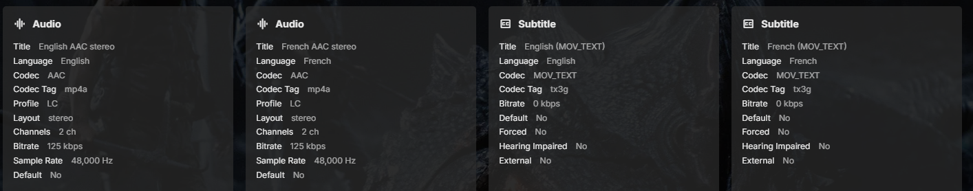

dprovencher 1 Posted August 30, 2024 Posted August 30, 2024 I wrote an app using mediainfo / mp4box to specifically edit track language, default tag and forced tag according to my needs because I share my stuff with family and they are not used to select subs everytime a video starts and checking if it's the right one, etc. Almost all of my videos contain at least 2 audio tracks and multiple embedded subs, normal and forced. I live in Canada (French) and I have many files with fr-CA audio and fr-CA forced subs. I also have "fra" audio in other files along with fra forced subs. Almost all files also have eng audio with normal eng subs and also eng forced subs. Example 1 : Audio fra,eng Subtitle fra(forced),eng(forced),eng Example 2 : Audio fr-CA,en-GB Subtitle fr-CA(forced),en-GB The problem I have, now that my files are correctly edited, is emby does not detect the Forced flag in mp4 files, or at least does not update the info regarding the file. I did a library scan and replace metadata and nothing changed. I use .nfos for everything if that's relevant, and those don't have the default / forced flags in them, only the mp4 themselves, but I hope emby use mediainfo. Thank you,

dprovencher 1 Posted August 30, 2024 Author Posted August 30, 2024 Here is one video as an example : What mediainfo shows : Audio #1 ID : 3 Format : AAC LC Format/Info : Advanced Audio Codec Low Complexity Codec ID : mp4a-40-2 Duration : 1 h 41 min Bit rate mode : Constant Bit rate : 125 kb/s Channel(s) : 2 channels Channel layout : L R Sampling rate : 48.0 kHz Frame rate : 46.875 FPS (1024 SPF) Compression mode : Lossy Stream size : 91.4 MiB (2%) Title : BAMTech audio / English Language : English Default : No Alternate group : 2 Tagged date : 2024-08-30 14:06:18 UTC Audio #2 ID : 4 Format : AAC LC Format/Info : Advanced Audio Codec Low Complexity Codec ID : mp4a-40-2 Duration : 1 h 41 min Bit rate mode : Constant Bit rate : 125 kb/s Channel(s) : 2 channels Channel layout : L R Sampling rate : 48.0 kHz Frame rate : 46.875 FPS (1024 SPF) Compression mode : Lossy Stream size : 91.4 MiB (2%) Title : BAMTech audio / Français (Canadien) Language : French (CA) Default : No Alternate group : 3 Tagged date : 2024-08-30 14:06:18 UTC Text #1 ID : 5 Format : Timed Text Muxing mode : sbtl Codec ID : tx3g Duration : 1 h 41 min Bit rate mode : Variable Bit rate : 56 b/s Frame rate : 0.487 FPS Stream size : 41.2 KiB (0%) Title : English [CC] Language : English Default : No Forced : No Alternate group : 4 Tagged date : 2024-08-30 14:06:18 UTC Count of events : 1478 Text #2 ID : 6 Format : Timed Text Muxing mode : sbtl Codec ID : tx3g Duration : 27 min 24 s Bit rate mode : Variable Bit rate : 1 b/s Frame rate : 0.010 FPS Stream size : 253 Bytes (0%) Title : fr-CA--forced-- Language : French (CA) Default : No Forced : Yes Alternate group : 5 Tagged date : 2024-08-30 14:06:18 UTC Count of events : 8
dprovencher 1 Posted August 30, 2024 Author Posted August 30, 2024 Same file, from ffprobe : Stream #0:1[0x3](eng): Audio: aac (LC) (mp4a / 0x6134706D), 48000 Hz, stereo, fltp, 125 kb/s Metadata: handler_name : BAMTech audio vendor_id : [0][0][0][0] Stream #0:2[0x4](fra): Audio: aac (LC) (mp4a / 0x6134706D), 48000 Hz, stereo, fltp, 125 kb/s Metadata: handler_name : BAMTech audio vendor_id : [0][0][0][0] Stream #0:3[0x5](eng): Subtitle: mov_text (tx3g / 0x67337874), 0 kb/s Metadata: handler_name : SubtitleHandler Stream #0:4[0x6](fra): Subtitle: mov_text (tx3g / 0x67337874), 0 kb/s Metadata: handler_name : SubtitleHandler I'm not used to ffprobe, is there some kind of way to get the real language (fr-CA) and the default / forced tags?
Happy2Play 9798 Posted August 30, 2024 Posted August 30, 2024 Dev will have to comment as Emby uses ffmpeg/ffprobe for everything. Not familiar embedded info in mp4 as it is slightly different then mkv and the specific language code requirements.
Luke 42184 Posted August 31, 2024 Posted August 31, 2024 HI, the first step is that ffmpeg/ffprobe needs to support this data for mp4 files. Once it does, then Emby will be able to utilize it.
dprovencher 1 Posted August 31, 2024 Author Posted August 31, 2024 Thank you Luke for your input! Would using mediainfo be something you could look at? It is widely used everywhere (MPC, vlc, most media managers like tinyMM, etc.) it outputs json or xml and is very easy to work with. Meanwhile, can you tell me with mkv are the languages like fr-CA supported and multiple forced subs? I could switch my files if mkv works for what I want, as long as emby does not rebuild my whole library because I switched extensions. Thank you!
dprovencher 1 Posted August 31, 2024 Author Posted August 31, 2024 I played around with ffprobe and found what I'm looking for, at least for the "forced" part : -show_streams -show_data For the 2 subs only : [STREAM] index=3 codec_name=mov_text codec_long_name=MOV text profile=unknown codec_type=subtitle codec_tag_string=tx3g codec_tag=0x67337874 width=N/A height=N/A id=0x5 r_frame_rate=0/0 avg_frame_rate=0/0 time_base=1/1000000 start_pts=0 start_time=0.000000 duration_ts=6073120000 duration=6073.120000 bit_rate=55 max_bit_rate=N/A bits_per_raw_sample=N/A nb_frames=2957 nb_read_frames=N/A nb_read_packets=N/A extradata= 00000000: 0000 0000 01ff 0000 00ff 0000 0000 0000 ................ 00000010: 0000 0000 0000 0001 0010 ffff ffff 0000 ................ 00000020: 0012 6674 6162 0001 0001 0541 7269 616c ..ftab.....Arial 00000030: 0000 0014 6274 7274 0000 0000 0000 0037 ....btrt.......7 00000040: 0000 0037 ...7 extradata_size=68 DISPOSITION:default=0 DISPOSITION:dub=0 DISPOSITION:original=0 DISPOSITION:comment=0 DISPOSITION:lyrics=0 DISPOSITION:karaoke=0 DISPOSITION:forced=0 DISPOSITION:hearing_impaired=0 DISPOSITION:visual_impaired=0 DISPOSITION:clean_effects=0 DISPOSITION:attached_pic=0 DISPOSITION:timed_thumbnails=0 DISPOSITION:non_diegetic=0 DISPOSITION:captions=0 DISPOSITION:descriptions=0 DISPOSITION:metadata=0 DISPOSITION:dependent=0 DISPOSITION:still_image=0 TAG:language=eng TAG:handler_name=SubtitleHandler [/STREAM] [STREAM] index=4 codec_name=mov_text codec_long_name=MOV text profile=unknown codec_type=subtitle codec_tag_string=tx3g codec_tag=0x67337874 width=N/A height=N/A id=0x6 r_frame_rate=0/0 avg_frame_rate=0/0 time_base=1/1000000 start_pts=0 start_time=0.000000 duration_ts=1644440001 duration=1644.440001 bit_rate=1 max_bit_rate=N/A bits_per_raw_sample=N/A nb_frames=17 nb_read_frames=N/A nb_read_packets=N/A extradata= 00000000: c000 0000 01ff 0000 00ff 0000 0000 0000 ................ 00000010: 0000 0000 0000 0001 0010 ffff ffff 0000 ................ 00000020: 0012 6674 6162 0001 0001 0541 7269 616c ..ftab.....Arial 00000030: 0000 0014 6274 7274 0000 0000 0000 0001 ....btrt........ 00000040: 0000 0001 .... extradata_size=68 DISPOSITION:default=0 DISPOSITION:dub=0 DISPOSITION:original=0 DISPOSITION:comment=0 DISPOSITION:lyrics=0 DISPOSITION:karaoke=0 DISPOSITION:forced=0 DISPOSITION:hearing_impaired=0 DISPOSITION:visual_impaired=0 DISPOSITION:clean_effects=0 DISPOSITION:attached_pic=0 DISPOSITION:timed_thumbnails=0 DISPOSITION:non_diegetic=0 DISPOSITION:captions=0 DISPOSITION:descriptions=0 DISPOSITION:metadata=0 DISPOSITION:dependent=0 DISPOSITION:still_image=0 TAG:language=fra TAG:handler_name=SubtitleHandler [/STREAM] You can see the diffrence in extradata, the forced subs begins with "c0" and the normal is "00". I knew what I was looking for as I add this flag with mp4box (txtflags=0xC0000000) I can't find anything regarding the language, but mediainfo has all of this. Thank you!
dprovencher 1 Posted September 4, 2024 Author Posted September 4, 2024 Well I've decided to test things out with mkv and even though ffprobe does not support normal languages like fr-CA emby displays the name of the track I put in and the forced flag is displayed too so I can work around with that at least. Maybe you could look at how Disney+, Netflix, Prime work and try to make something that works with modern languages and multi-language files. I'm sure I'm not the only one. Thank you,
