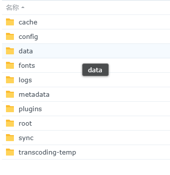

wuzhwuei 0 Posted August 31, 2024 Author Posted August 31, 2024 (edited) 9 minutes ago, Happy2Play said: Dev will comment further but if one individual has a broken install the one will have to troubleshot why this specific environment is not working correctly. Per your log either something in the container is blocking Emby or it somehow is a bad install. Did you verify if said can not find files even exist? I'm not a professional docker maintainer, I don't have access to the files inside the docker container, I can't verify the files you request, I'll just simply install the container docker images and containers are closed, users only map out the config folder configuration and media folder media, and the rest cannot access the system files, I think you should know better than me about the software you developed yourself Edited August 31, 2024 by wuzhwuei

wuzhwuei 0 Posted August 31, 2024 Author Posted August 31, 2024 (edited) I rebuilt all my configurations, everything is normal, and all my media settings and personalization settings are gone, why does the configuration file in the config folder affect the functiona lity of the whole program? Shouldn't config just store metadata and settings? It takes a lot of time and effort to rebuild these What exactly files are affecting the program? Edited August 31, 2024 by wuzhwuei

jelum 36 Posted September 10, 2024 Posted September 10, 2024 @wuzhwuei, can you share the way you started the container? all configurations you defined (you can mask your private data like URL, username, password, etc..). If it's a docker-compose - I want to see the whole file. I assume you override the mandatory folder inside the container using your configuration. that's why Emby is not able to find some essential files there. Usually, if the Emby image starts correctly, you'll not lose your config on a docker restart. And what is your host operation system - Linux, Windows, or Android?

jelum 36 Posted September 10, 2024 Posted September 10, 2024 I don't think the problem is in the plugin or Emby. If you lost your config, had issues with missing Emby files (by the logs), and are running Emby via docker, I assume you have incorrect script\command\config to start your image.
