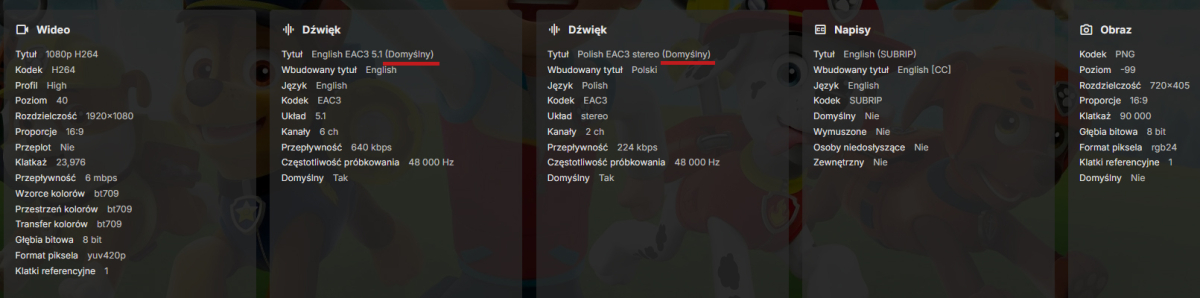

Mariusz 2 Posted August 29, 2024 Posted August 29, 2024 Hello, I have 2 detected sounds as default in some videos. For example: English (default) Polish (default) And even though I have Polish selected as default in the main settings, it still plays English for me because it is listed first. In movies it may not be annoying because I can manually switch it in the player, but in TV series it is when my daughter is watching a cartoon. How to fix it? Can you guys fix it somehow?

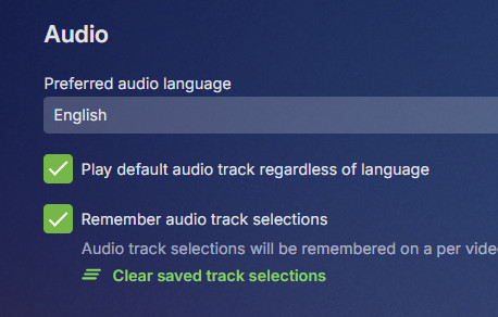

Solution pwhodges 2023 Posted August 29, 2024 Solution Posted August 29, 2024 Because it is marked as default in the video file? What is your audio setting in the user playback settings? If you have "play default" set, then the first track in the file that is marked "default" will be played regardless of the preferred language above. Try changing that setting. Paul 1

Mariusz 2 Posted August 29, 2024 Author Posted August 29, 2024 (edited) 19 minutes ago, pwhodges said: Because it is marked as default in the video file? What is your audio setting in the user playback settings? If you have "play default" set, then the first track in the file that is marked "default" will be played regardless of the preferred language above. Try changing that setting. Paul Verified. This setting did not change anything still the movie is unplayed in English even though I have my primary language selected as Polish. Samsung Smart TV (UE55MU7002) Edited August 29, 2024 by Mariusz
Happy2Play 9798 Posted August 30, 2024 Posted August 30, 2024 (edited) Pretty sure only one can/should be listed as default as subtitles have the same issue and multiple defaults don't work out well. But did you try unchecking "play default regardless of language"? Edited August 30, 2024 by Happy2Play 1
Luke 42184 Posted August 30, 2024 Posted August 30, 2024 2 hours ago, Mariusz said: Verified. This setting did not change anything still the movie is unplayed in English even though I have my primary language selected as Polish. Samsung Smart TV (UE55MU7002) Hi, what did you verify? How are the settings set? 1
RanmaCanada 500 Posted August 30, 2024 Posted August 30, 2024 I'd suggest using a tool like JMkvpropedit to resolve this on the mkv end. 2
Mariusz 2 Posted August 30, 2024 Author Posted August 30, 2024 (edited) 13 hours ago, Happy2Play said: Pretty sure only one can/should be listed as default as subtitles have the same issue and multiple defaults don't work out well. But did you try unchecking "play default regardless of language"? 11 hours ago, Luke said: Hi, what did you verify? How are the settings set? After resetting the TV, the option to “uncheck” this worked. Now the audio language is played correctly. Edited August 30, 2024 by Mariusz 1
