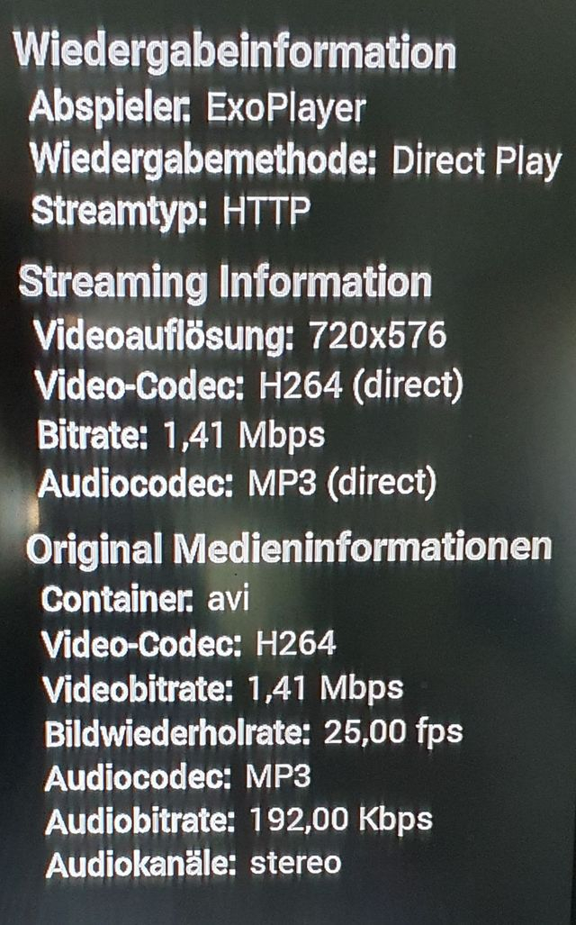

fbirkholz 0 Posted August 30, 2024 Author Posted August 30, 2024 Here it comes, as firetv not having screenshot it's just a photo thx

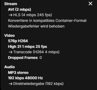

fbirkholz 0 Posted August 30, 2024 Author Posted August 30, 2024 While this is screenshot taken on web-client from synology viewed by windows in latest chrome browser which is the working once.
GrimReaper 4896 Posted August 30, 2024 Posted August 30, 2024 37 minutes ago, fbirkholz said: Here it comes, as firetv not having screenshot it's just a photo thx If you set your FireTV app quality (either OSD cog icon>Quality or Settings>Playback tab>Max. Streaming bitrate) to 1 Mbps, does that item play properly?
fbirkholz 0 Posted August 30, 2024 Author Posted August 30, 2024 19 minutes ago, GrimReaper said: If you set your FireTV app quality (either OSD cog icon>Quality or Settings>Playback tab>Max. Streaming bitrate) to 1 Mbps, does that item play properly? Changing general streaming rate from auto to 1Mbps working. But changes in OSD cog Icon Quality not working. Would that mean AUTO setting is not recognizing correct streaming rate on android, while doing correct in web-client? And I've to reduce this to 1MBps for all videos?
GrimReaper 4896 Posted August 30, 2024 Posted August 30, 2024 That was just a test to trigger transcoding and compare the results, as that item was trying to DirectPlay and failing, the exact reasons for that you'd have to wait for the Devs input based on in-app log you provided/sent electronically previously. @ebr 4 minutes ago, fbirkholz said: Would that mean AUTO setting is not recognizing correct streaming rate on android, while doing correct in web-client? No, it has to do with media played, seeing that is an avi file it's likely XviD or DivX or some other MPEG flavor and client app is trying to DirectPlay them on unsupported hardware instead of transcoding (as web app does, notice the reason for transcoding in WebUI Stats for Nerds: Converting to compatible container), you can post ffmpeg log and/or wait for Devs' comment based on same in-app logs sent previously. Aditinally, as said before: 2 hours ago, GrimReaper said: You can also download standard Android app from your store (or sideload from here) and see how does that compare.
