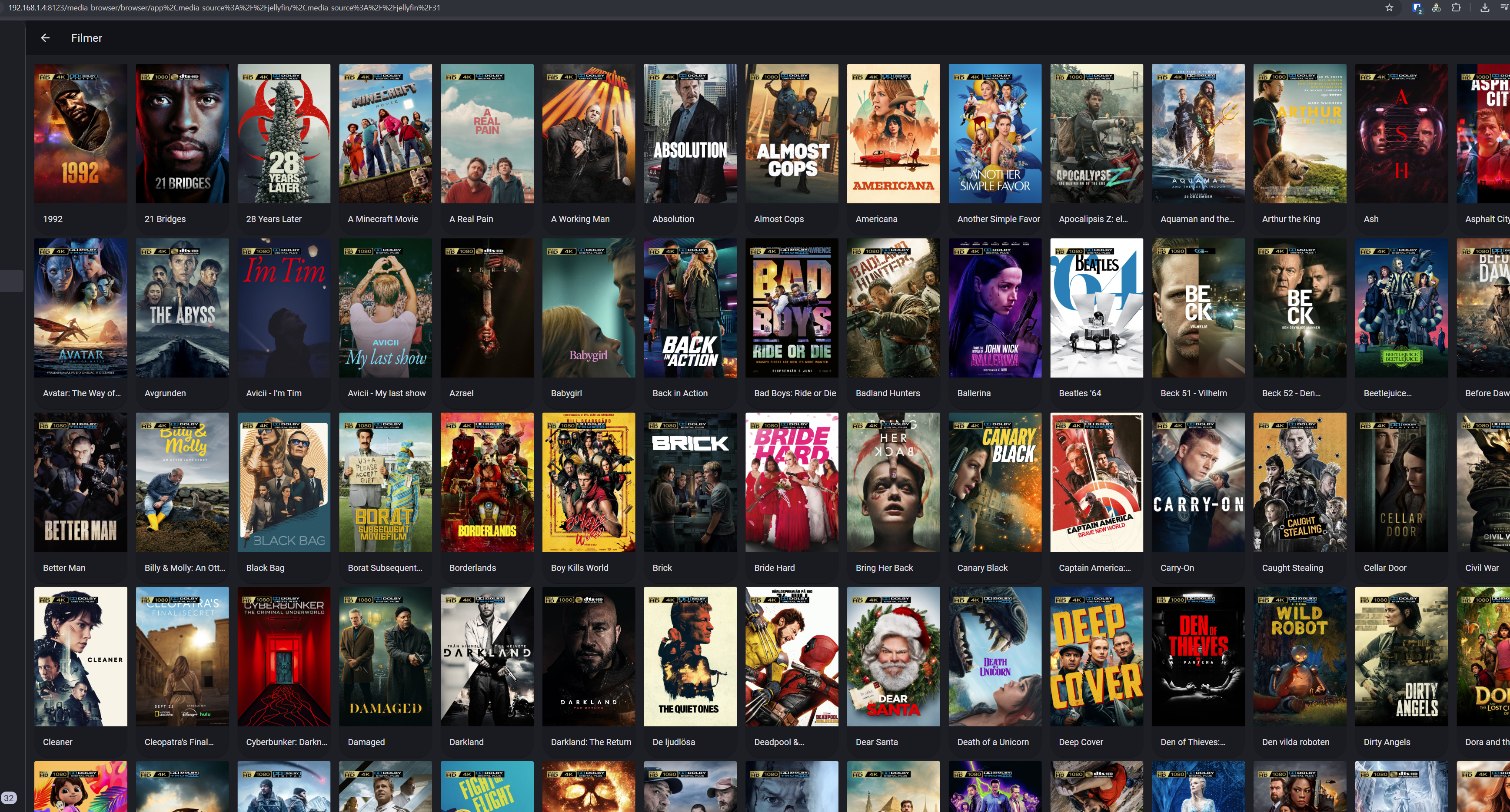

lundblad 10 Posted October 6, 2025 Posted October 6, 2025 I use the Jellyfin integration (HACS) for my emby server in Home assistant. That gives me a sensor showing active users that works great and insta updates. And it also gives me all my media in home assistant under media tab! Will try the template sensor above now too
