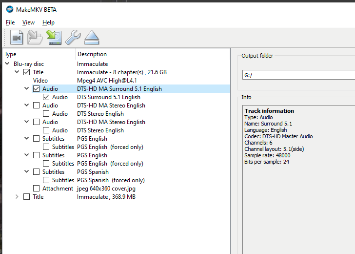

rms8 14 Posted August 27, 2024 Posted August 27, 2024 When I rip a movie to MKV, Emby is playing it back as just a 2chnl source, despite me making the selection in the attached pic. Is there some setting on the server I need to change? Ripped movies are on the Emby Server PC. They are viewed via WMC PC, but the server is doing the playback and the WMC PC is the interface. I used to use AnyDVD for my rips (ripped to the native folder structure and played back on WMC PC using TMT6), but now that AnyDVD is gone I am trying my hand with MakeMKV and letting the server do the playback.

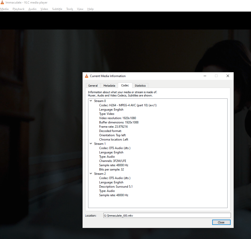

rms8 14 Posted August 27, 2024 Author Posted August 27, 2024 21 minutes ago, Lessaj said: What does the mediainfo of the output MKV look like? If I play the file on my Main PC via VLC, it shows the MKV file as 5.1 :
Lessaj 477 Posted August 27, 2024 Posted August 27, 2024 What is shown in Emby for mediainfo? That has more details that what VLC is showing. It looks like one of the audio streams is 5.1 and the other might only be stereo but the VLC info doesn't provide that information. It says 5.1 in the description, but the description could say anything.

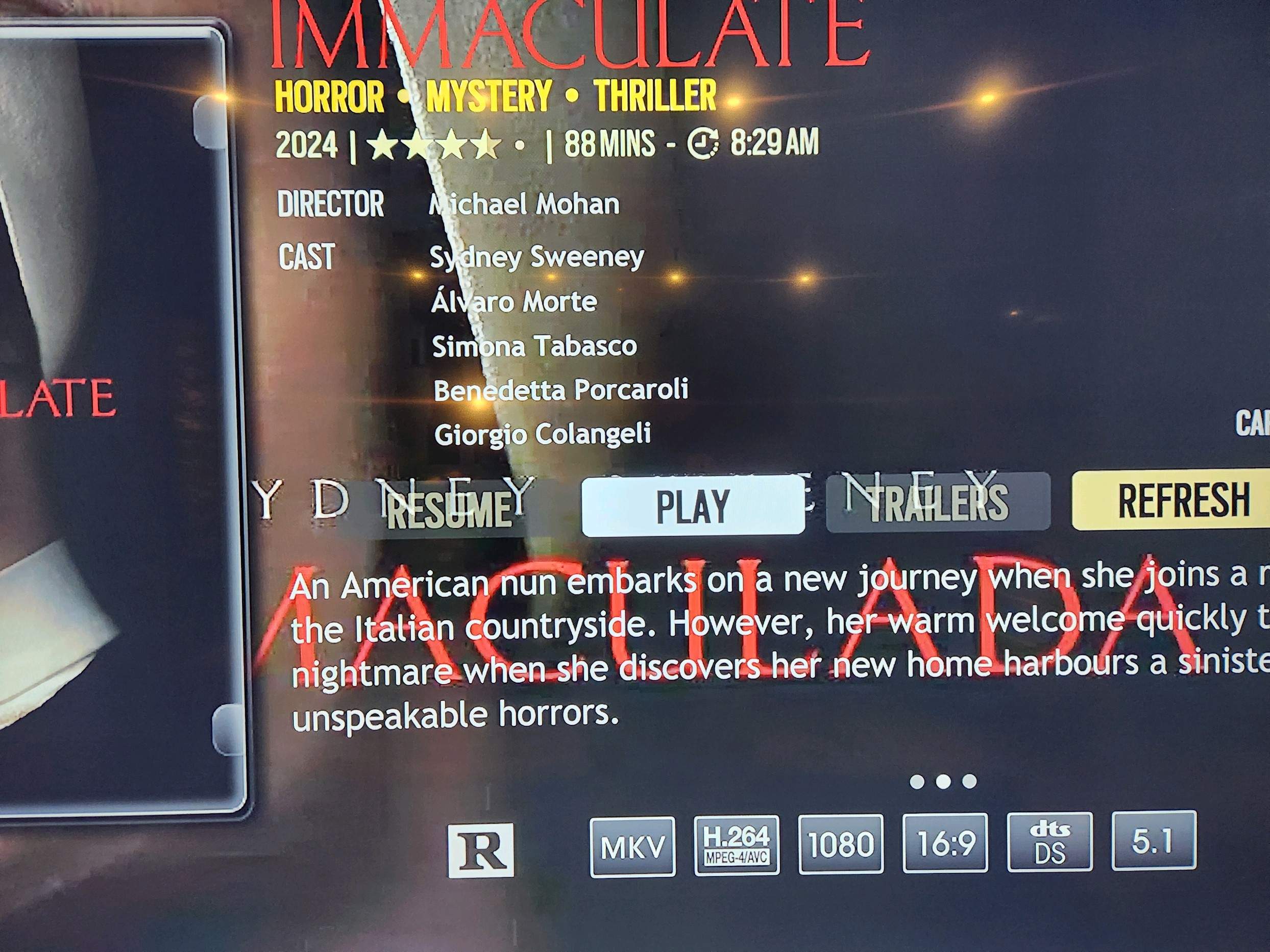

rms8 14 Posted August 28, 2024 Author Posted August 28, 2024 (edited) I'm using the most recent version of the server that still works with Win7 WMC. I just LOVE the different themes which I take FULL advantage of in order to tailor the UI to my liking. It's perfect to me! I deleted all the logs then started all over again as to clean up the info in the logs. I turned on the HTPC, started the Emby app from WMC, navigated to the movie in question (my first MKV) and played a few seconds of it. I went into Libraries, then to that movie, but could not find any audio spec info?? I checked another movie (a bluray rip) and also did not see any audio info displayed in Metadata, I did take a screenshot of the movie's entry on the HTPC and it does have a "5.1" badge. hwaccels_4.7.6.0.txt protocols_4.7.6.0.txt version_4.7.6.0.txt decoders_4.7.6.0.txt embyserver.txt encoders_4.7.6.0.txt filters_4.7.6.0.txt hardware_detection-63860425207.txt Edited August 28, 2024 by rms8

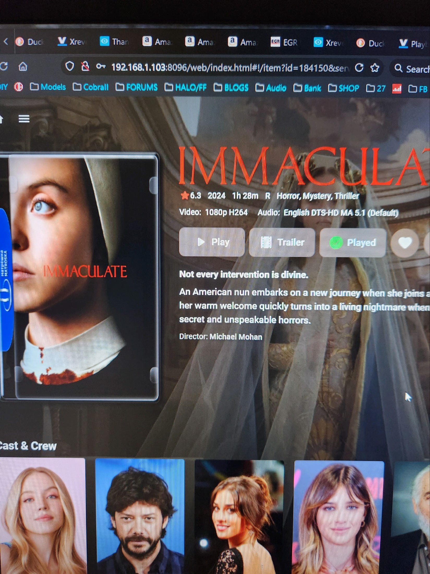

rms8 14 Posted August 28, 2024 Author Posted August 28, 2024 3 hours ago, Lessaj said: Can you look at the item details in the web app instead? I don't use the app on my phone since I have my server locked down to just my LAN. I did however download it to see if it shows something different than the 5.1 from the HTPC UI. Unfortunately, it would connect since my Server version is 4.7.6.0. It wants me to upgrade the server version before proceeding.
Lessaj 477 Posted August 28, 2024 Posted August 28, 2024 No not a mobile app, the web app is just the server address in your browser.
rms8 14 Posted August 28, 2024 Author Posted August 28, 2024 24 minutes ago, Lessaj said: No not a mobile app, the web app is just the server address in your browser. OK. Tried it that way. No difference. When I go to "Edit Metadata", there is no info on the resolution or audio. The screenshot shows that its 5.1 tho.

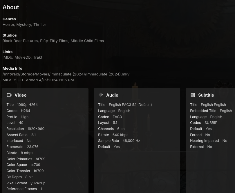

Lessaj 477 Posted August 28, 2024 Posted August 28, 2024 It should be at the bottom of the page like this:

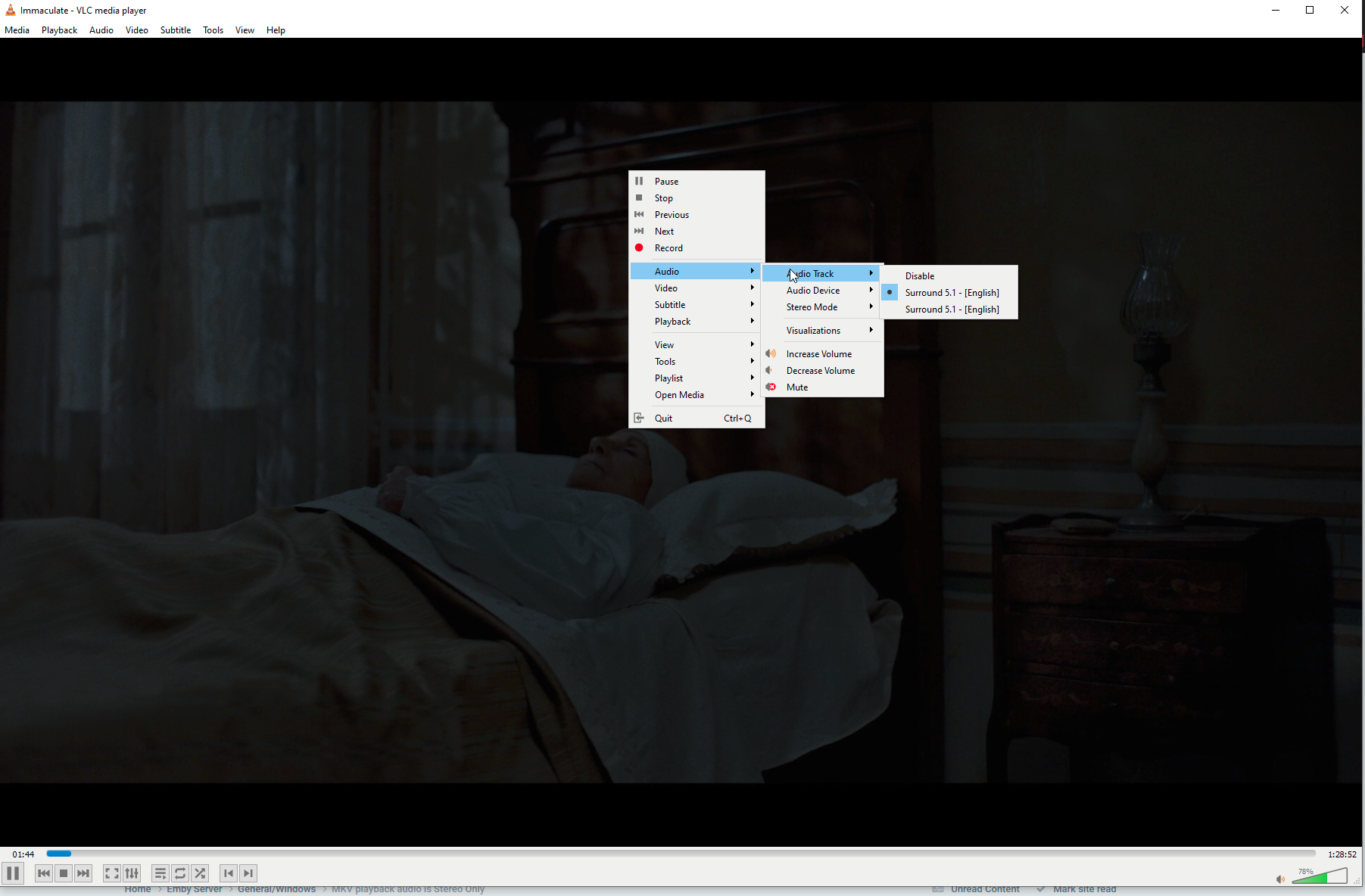

Lessaj 477 Posted August 28, 2024 Posted August 28, 2024 It should be correct, but that could just be the title that is set, which is why I want to see the metadata information. Especially since they've not used this program before I'm trying to see the details of what ended up being output. It looks like there are 2 audio tracks based on the VLC screenshot, but the other screenshot from Emby only seems to indicate one track. 1
rms8 14 Posted August 28, 2024 Author Posted August 28, 2024 49 minutes ago, Lessaj said: It should be correct, but that could just be the title that is set, which is why I want to see the metadata information. Especially since they've not used this program before I'm trying to see the details of what ended up being output. It looks like there are 2 audio tracks based on the VLC screenshot, but the other screenshot from Emby only seems to indicate one track. 1 hour ago, Happy2Play said: Would appear to potentially be correct. But since this is all WMC related on an old server may need someone with knowledge of WMC to comment and probably needs to be in the WMC section to get better visibility on the specific issue. @arrbee99I see you commenting in the WMC UI (beta) you have any ideas here? Oh boy....Happy2Play got me pointed in the right direction. It's RESOLVED. The HTPC I built has no graphics card. I use the on die graphics from Intel. I think it's HD700 Iris or something. There was an OBSCURE setting in the Intel IGP settings for Audio that said "Audio Through TV" or something like that. I changed it from Disabled to Enabled. When I started the MKV file, the Denon rcvr was now showing 5.1 chnls on the Input !!!! What's confusing is that I never experienced this with DVD's or Blurays ripped to the Server. Only noticed this when I ripped a bluray to MKV (vs. my standard of ripping to native folder structure). Thanks guys for digging into this !!!!!! 2
