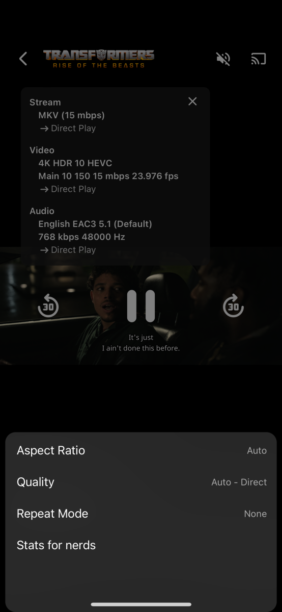

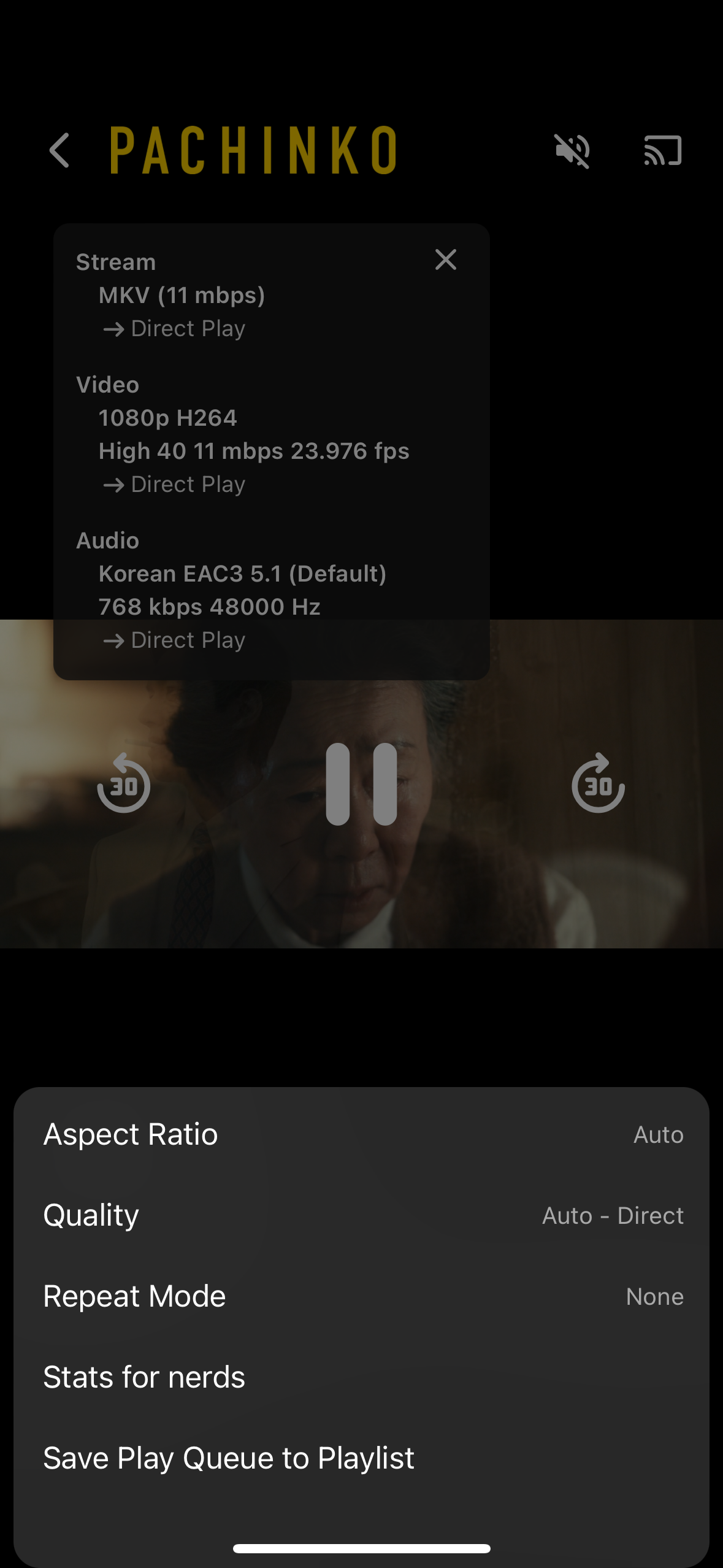

guunter 49 Posted September 8, 2024 Posted September 8, 2024 (edited) @CoastInTheFogi just tested on 5g on my iPhone and I seem to be direct playing using auto. I am on the beta channel for my server though. edit: nvm I forgot I had my on demand wireguard vpn turned on so that’s why it direct played. It did do 1080p 4mbs once I turned it off Edited September 8, 2024 by guunter
CoastInTheFog 1 Posted September 8, 2024 Author Posted September 8, 2024 @guunterSo close! I had started looking into the beta changes, couldn’t find anything relevant, and then saw your edit.
guunter 49 Posted September 8, 2024 Posted September 8, 2024 4 minutes ago, CoastInTheFog said: @guunterSo close! I had started looking into the beta changes, couldn’t find anything relevant, and then saw your edit. Yeah my bad. I was like wait let me give my two cents and remembered that I'm always on my home network
