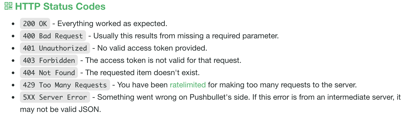

Painkiller88 250 Posted December 30, 2024 Posted December 30, 2024 Hi, May it be, there is something broken with the pushbullet plugin? I also get the bad request when trying to send a test notification. In the Documentation it says: So if someone would be over the 500 push notifications limit, it would be another error code (429), but what i get is the 400 bad request. maybe they changed something and the plugin needs to be updated. I already reset all my tokens and created a new one. This new one is working if i do the curl request but using the plugin i get bad request. I also uninstalled and re installed the whole plugin but still the same problem and as i can request stuff using curl, the token is valid. Thanks
