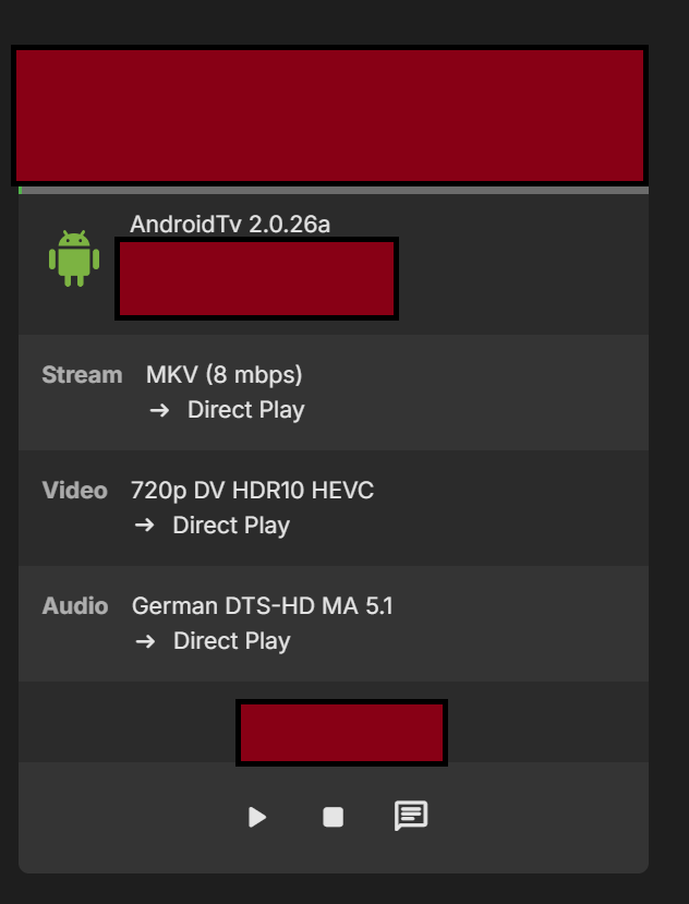

neik 874 Posted August 25, 2024 Posted August 25, 2024 (edited) Hi guys, my sister is using an older FTVS (2.gen I think) so definitely not DV/HDR capable but for some reason it is direct playing a file: I would expect it to tone map the file for playback compatibility, just like it is doing when I reduce quality on my Shield. Not quite sure what could be going wrong. Any hint? Edit: Btw... can the new Android app be sideloaded to FTVS? Is the old FTVS performance-wise capable of running the new app? Edited August 25, 2024 by neik
Solution ebr 16337 Posted August 26, 2024 Solution Posted August 26, 2024 Hi. That appears to be a really old version of the Fire TV app. You should try updating it or just installing the one called just "Emby" from the Amazon store.
neik 874 Posted August 26, 2024 Author Posted August 26, 2024 Oh didn't notice that, I had it set up to auto-update so assumed it was on the latest version. Will have a look at either updating or getting the new app onto it. Thank you! 1
neik 874 Posted August 28, 2024 Author Posted August 28, 2024 On 8/26/2024 at 6:32 AM, ebr said: Hi. That appears to be a really old version of the Fire TV app. You should try updating it or just installing the one called just "Emby" from the Amazon store. Updating solved it, thanks for the hint.
