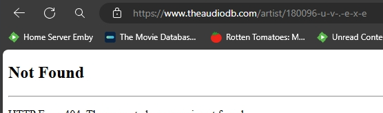

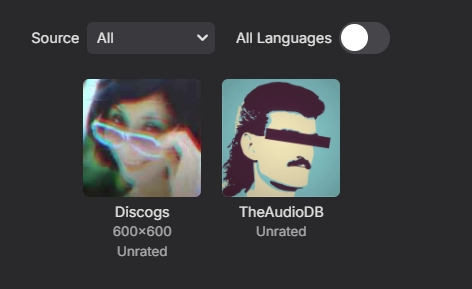

JBloom91 31 Posted August 27, 2024 Author Posted August 27, 2024 So I think I found the problem, Emby just doesn't want to update KENMORE Classic or the other artist I'm having trouble with. Unlike others it won't download images from TheAudioDB.
Happy2Play 9814 Posted August 27, 2024 Posted August 27, 2024 22 minutes ago, JBloom91 said: So I think I found the problem, Emby just doesn't want to update KENMORE Classic or the other artist I'm having trouble with. Unlike others it won't download images from TheAudioDB. Going to have to be more specific

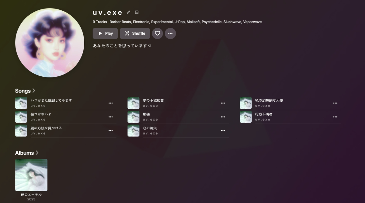

JBloom91 31 Posted August 27, 2024 Author Posted August 27, 2024 I mean I can update all other artists and it will update the metadata, images and overviews, but it will not update KENMORE Classic or u v . e x e
Happy2Play 9814 Posted August 27, 2024 Posted August 27, 2024 1 minute ago, JBloom91 said: u v . e x e I can potentically see issue with this one but would have to test. As for KENMORE Classic minus something in the logs I can't say as I have not seen a issue. Are you writing nfo files also? Spoiler <?xml version="1.0" encoding="utf-8" standalone="yes"?> <artist> <biography /> <outline /> <lockdata>false</lockdata> <dateadded>2024-08-26 11:24:13</dateadded> <title>KENMORE Classic</title> <sorttitle>Kenmore Classic</sorttitle> <runtime>75</runtime> <genre>Barber Beats</genre> <genre>Downtempo</genre> <genre>Electronic</genre> <genre>Mallsoft</genre> <genre>Slushwave</genre> <genre>Vaporwave</genre> <musicbrainzartistid>6914f918-1406-4f30-b678-a3c719e0f844</musicbrainzartistid> <uniqueid type="discogsartist">10916341</uniqueid> <discogsartistid>10916341</discogsartistid> <uniqueid type="musicbrainzartist">6914f918-1406-4f30-b678-a3c719e0f844</uniqueid> <album> <title>Mᴀʟʟ ᴏf Fᴜʀʏ</title> <year>2024</year> </album> <album> <title>Mᴀʟʟ ᴏf Fᴜʀʏ ɪɪ</title> <year>2024</year> </album> </artist>

JBloom91 31 Posted August 27, 2024 Author Posted August 27, 2024 Man I don't know why I always seem to have issues. Anyway, if you want to test it, those u v . e x e releases are available on https://miamipalm.bandcamp.com/ 平和を希求 was added as 平和を希求:????? until I manually renamed it.

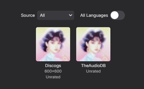

Happy2Play 9814 Posted August 27, 2024 Posted August 27, 2024 (edited) As for u v . e x e they imported correctly. Line 67991: 2024-08-26 21:42:50.128 Info HttpClient: GET https://api.discogs.com/database/search?q=u v . e x e&type=artist Line 68661: 2024-08-26 21:43:01.471 Debug App: Running MusicBrainzArtistProvider for u v . e x e Line 68664: 2024-08-26 21:43:01.877 Debug App: Running DiscogsArtistProvider for u v . e x e Line 68665: 2024-08-26 21:43:02.285 Info HttpClient: GET https://api.discogs.com/database/search?q=u v . e x e&type=artist Line 68667: 2024-08-26 21:43:02.836 Debug App: Running AudioDbArtistProvider for u v . e x e Line 68668: 2024-08-26 21:43:02.836 Debug App: Running BaseGenreCleaner for u v . e x e Line 68669: 2024-08-26 21:43:02.836 Debug App: Running FanartArtistProvider for u v . e x e Line 68670: 2024-08-26 21:43:02.837 Debug App: Running DiscogsArtistImageProvider for u v . e x e Line 68673: 2024-08-26 21:43:04.029 Debug ProviderManager: Saving image to E:\Media\Music - emby metadata\u v . e x e\folder.jpg Line 68674: 2024-08-26 21:43:04.030 Debug App: Running AudioDbArtistImageProvider for u v . e x e Line 68676: 2024-08-26 21:43:04.959 Debug ProviderManager: Saving image to E:\Media\Music - emby metadata\u v . e x e\fanart.jpg Okay in my case artist image came from discog. 2024-08-26 21:43:03.242 Info HttpClient: GET https://api.discogs.com/artists/14549062 2024-08-26 21:43:03.726 Info HttpClient: GET https://i.discogs.com/5fern2gzBMEaCi7bfqLvB0ubrstrKPQTKdWF0ViVsS0/rs:fit/g:sm/q:90/h:600/w:600/czM6Ly9kaXNjb2dz/LWRhdGFiYXNlLWlt/YWdlcy9BLTE0NTQ5/MDYyLTE3MTUwOTUw/NTktNDM5Ni5qcGVn.jpeg 2024-08-26 21:43:04.029 Debug ProviderManager: Saving image to E:\Media\Music - emby metadata\u v . e x e\folder.jpg 2024-08-26 21:43:04.030 Debug App: Running AudioDbArtistImageProvider for u v . e x e 2024-08-26 21:43:04.030 Info HttpClient: GET https://www.theaudiodb.com/images/media/artist/fanart/qlruqa1724730578.jpg 2024-08-26 21:43:04.959 Debug ProviderManager: Saving image to E:\Media\Music - emby metadata\u v . e x e\fanart.jpg Edited August 27, 2024 by Happy2Play
JBloom91 31 Posted August 27, 2024 Author Posted August 27, 2024 Well then I guess there is just something wrong on my end that just refuses to let them update.
Happy2Play 9814 Posted August 27, 2024 Posted August 27, 2024 (edited) Not sure why audiodb show a image when searched As theaudiodb just vanished for me. So it maybe a site issue but not sure. Will guess a cached image from previous search. Edited August 27, 2024 by Happy2Play
