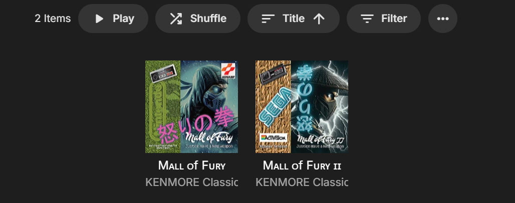

JBloom91 31 Posted August 24, 2024 Posted August 24, 2024 Emby doesn't seem to like these two albums, as the end result looks like this: https://musicbrainz.org/release/5b08376d-7284-4f06-9959-cc65374f49dc https://musicbrainz.org/release/8f4f1ffe-2d6c-4315-8440-b143851470d1

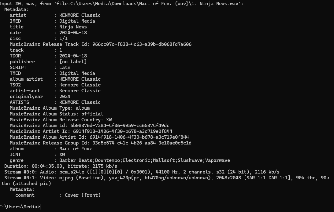

Happy2Play 9814 Posted August 25, 2024 Posted August 25, 2024 10 minutes ago, JBloom91 said: The probe exe seemingly does nothing, Can you provide exactly what you used. As the command does work as this is the command Emby uses to see the metadata. C:\Users\Media>C:\Users\Media\AppData\Roaming\Emby-Server\system\ffprobe.exe -i file:"E:\Media\Music - emby metadata\Undersaken\Swords of Fate (cassette)\2. Cloaked Visage.flac" ffprobe version 5.1-emby_2023_06_25 Copyright (c) 2007-2022 the FFmpeg developers and softworkz for Emby LLC built with gcc 12.2.0 (Rev10, Built by MSYS2 project) Input #0, flac, from 'file:E:\Media\Music - emby metadata\Undersaken\Swords of Fate (cassette)\2. Cloaked Visage.flac': Metadata: MUSICBRAINZ_RELEASEGROUPID: 7c99f622-7289-4048-b5d1-b94a67c4c2c2 ORIGINALDATE : 2023-12-01 ORIGINALYEAR : 2023 RELEASETYPE : album MUSICBRAINZ_ALBUMID: 21dce8f8-9bbf-43f5-a0cd-53a9ad6482c0 DATE : 2024-07-08 LABEL : Vault of Discoveries CATALOGNUMBER : VOD-006 MUSICBRAINZ_ALBUMARTISTID: 0d9e4d2a-0f6c-48fc-b772-6de8b7e15e45 album_artist : undersaken ALBUMARTISTSORT : undersaken SCRIPT : Latn RELEASESTATUS : official ALBUM : Swords of Fate TOTALDISCS : 1 MEDIA : Cassette disc : 1 TOTALTRACKS : 10 MUSICBRAINZ_TRACKID: da49fb23-62d7-4356-9130-542cd194692a TITLE : Cloaked Visage MUSICBRAINZ_ARTISTID: 0d9e4d2a-0f6c-48fc-b772-6de8b7e15e45 ARTIST : undersaken ARTISTSORT : undersaken ARTISTS : undersaken MUSICBRAINZ_RELEASETRACKID: 291daf85-f738-4d89-b14e-d10c00ef13df track : 2 GENRE : Barber Beats;Downtempo;Electronic;Experimental;Vaporwave TRACKTOTAL : 10 DISCTOTAL : 1 Duration: 00:04:47.78, start: 0.000000, bitrate: 1582 kb/s Stream #0:0: Audio: flac, 44100 Hz, stereo, s32 (24 bit) Stream #0:1: Video: png, rgba(pc), 2000x2000, 90k tbr, 90k tbn (attached pic) Metadata: comment : Cover (front)
JBloom91 31 Posted August 25, 2024 Author Posted August 25, 2024 1 hour ago, Happy2Play said: Can you provide exactly what you used. As the command does work as this is the command Emby uses to see the metadata. C:\Users\Media>C:\Users\Media\AppData\Roaming\Emby-Server\system\ffprobe.exe -i file:"E:\Media\Music - emby metadata\Undersaken\Swords of Fate (cassette)\2. Cloaked Visage.flac" ffprobe version 5.1-emby_2023_06_25 Copyright (c) 2007-2022 the FFmpeg developers and softworkz for Emby LLC built with gcc 12.2.0 (Rev10, Built by MSYS2 project) Input #0, flac, from 'file:E:\Media\Music - emby metadata\Undersaken\Swords of Fate (cassette)\2. Cloaked Visage.flac': Metadata: MUSICBRAINZ_RELEASEGROUPID: 7c99f622-7289-4048-b5d1-b94a67c4c2c2 ORIGINALDATE : 2023-12-01 ORIGINALYEAR : 2023 RELEASETYPE : album MUSICBRAINZ_ALBUMID: 21dce8f8-9bbf-43f5-a0cd-53a9ad6482c0 DATE : 2024-07-08 LABEL : Vault of Discoveries CATALOGNUMBER : VOD-006 MUSICBRAINZ_ALBUMARTISTID: 0d9e4d2a-0f6c-48fc-b772-6de8b7e15e45 album_artist : undersaken ALBUMARTISTSORT : undersaken SCRIPT : Latn RELEASESTATUS : official ALBUM : Swords of Fate TOTALDISCS : 1 MEDIA : Cassette disc : 1 TOTALTRACKS : 10 MUSICBRAINZ_TRACKID: da49fb23-62d7-4356-9130-542cd194692a TITLE : Cloaked Visage MUSICBRAINZ_ARTISTID: 0d9e4d2a-0f6c-48fc-b772-6de8b7e15e45 ARTIST : undersaken ARTISTSORT : undersaken ARTISTS : undersaken MUSICBRAINZ_RELEASETRACKID: 291daf85-f738-4d89-b14e-d10c00ef13df track : 2 GENRE : Barber Beats;Downtempo;Electronic;Experimental;Vaporwave TRACKTOTAL : 10 DISCTOTAL : 1 Duration: 00:04:47.78, start: 0.000000, bitrate: 1582 kb/s Stream #0:0: Audio: flac, 44100 Hz, stereo, s32 (24 bit) Stream #0:1: Video: png, rgba(pc), 2000x2000, 90k tbr, 90k tbn (attached pic) Metadata: comment : Cover (front) I went into the folder and found the ffprobe.exe. Double clicked on it multiple times, ran as administrator, nothing happened. If I am supposed to enter a command I am unsure where I'm supposed to do so.

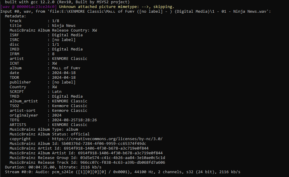

Happy2Play 9814 Posted August 25, 2024 Posted August 25, 2024 8 minutes ago, JBloom91 said: 2 hours ago, Happy2Play said: Can you provide exactly what you used. As the command does work as this is the command Emby uses to see the metadata. C:\Users\Media>C:\Users\Media\AppData\Roaming\Emby-Server\system\ffprobe.exe -i file:"E:\Media\Music - emby metadata\Undersaken\Swords of Fate (cassette)\2. Cloaked Visage.flac" ffprobe version 5.1-emby_2023_06_25 Copyright (c) 2007-2022 the FFmpeg developers and softworkz for Emby LLC built with gcc 12.2.0 (Rev10, Built by MSYS2 project) Input #0, flac, from 'file:E:\Media\Music - emby metadata\Undersaken\Swords of Fate (cassette)\2. Cloaked Visage.flac': Metadata: MUSICBRAINZ_RELEASEGROUPID: 7c99f622-7289-4048-b5d1-b94a67c4c2c2 ORIGINALDATE : 2023-12-01 ORIGINALYEAR : 2023 RELEASETYPE : album MUSICBRAINZ_ALBUMID: 21dce8f8-9bbf-43f5-a0cd-53a9ad6482c0 DATE : 2024-07-08 LABEL : Vault of Discoveries CATALOGNUMBER : VOD-006 MUSICBRAINZ_ALBUMARTISTID: 0d9e4d2a-0f6c-48fc-b772-6de8b7e15e45 album_artist : undersaken ALBUMARTISTSORT : undersaken SCRIPT : Latn RELEASESTATUS : official ALBUM : Swords of Fate TOTALDISCS : 1 MEDIA : Cassette disc : 1 TOTALTRACKS : 10 MUSICBRAINZ_TRACKID: da49fb23-62d7-4356-9130-542cd194692a TITLE : Cloaked Visage MUSICBRAINZ_ARTISTID: 0d9e4d2a-0f6c-48fc-b772-6de8b7e15e45 ARTIST : undersaken ARTISTSORT : undersaken ARTISTS : undersaken MUSICBRAINZ_RELEASETRACKID: 291daf85-f738-4d89-b14e-d10c00ef13df track : 2 GENRE : Barber Beats;Downtempo;Electronic;Experimental;Vaporwave TRACKTOTAL : 10 DISCTOTAL : 1 Duration: 00:04:47.78, start: 0.000000, bitrate: 1582 kb/s Stream #0:0: Audio: flac, 44100 Hz, stereo, s32 (24 bit) Stream #0:1: Video: png, rgba(pc), 2000x2000, 90k tbr, 90k tbn (attached pic) Metadata: comment : Cover (front) I went into the folder and found the ffprobe.exe. Double clicked on it multiple times, ran as administrator, nothing happened. If I am supposed to enter a command I am unsure where I'm supposed to do so. You can't click on it but use can use it in command line as shown via a command prompt/terminal.

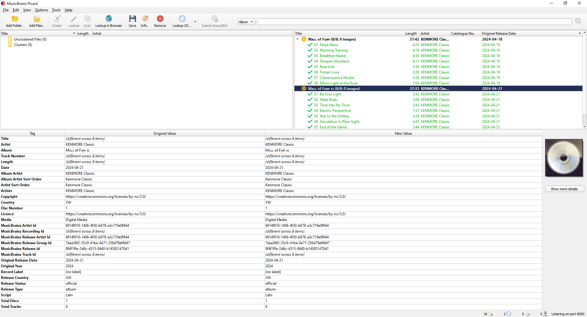

Vicpa 612 Posted August 25, 2024 Posted August 25, 2024 Hi Just take a screen shot of the tags in the Picard UI. 1
JBloom91 31 Posted August 25, 2024 Author Posted August 25, 2024 56 minutes ago, Vicpa said: Hi Just take a screen shot of the tags in the Picard UI.

user24 369 Posted August 25, 2024 Posted August 25, 2024 As these two MALL of FURY albums are freely downloadable from Bandcamp, I downloaded the FLAC versions to see if I could help: The direct downloaded files imported correctly into Emby with the basic info shown correctly. Running through Picard - no problems importing Running through Mp3tag - no problems importing Looking at your screenshot with the errors, I did wonder if you had two Album titles separated by a semi-colon e,g. "English Title; Japanese Title". If this was the case, then perhaps Emby is not recognising the Japanese characters, but also Emby does not allow for multiple Album titles (AFAIK) so the semicolon character appears in the Album title (I could replicate this). Maybe this gives you some clues? If not perhaps someone else can download the Albums and try to figure it out? 1
JBloom91 31 Posted August 25, 2024 Author Posted August 25, 2024 6 minutes ago, user24 said: As these two MALL of FURY albums are freely downloadable from Bandcamp, I downloaded the FLAC versions to see if I could help: The direct downloaded files imported correctly into Emby with the basic info shown correctly. Running through Picard - no problems importing Running through Mp3tag - no problems importing Looking at your screenshot with the errors, I did wonder if you had two Album titles separated by a semi-colon e,g. "English Title; Japanese Title". If this was the case, then perhaps Emby is not recognising the Japanese characters, but also Emby does not allow for multiple Album titles (AFAIK) so the semicolon character appears in the Album title (I could replicate this). Maybe this gives you some clues? If not perhaps someone else can download the Albums and try to figure it out? Odd. I have my files in wav but so far this hasn't been an issue with more albums (there have been a few but I'm assuming if I can fix this issue here I can fix the rest). I had the thought that perhaps the library just wasn't updating their data correctly, so I removed the albums from my library, scanned, restarted, restarted again cause a plugin updated, re-added the files and then scanned again. But they still came out messed up on my end.
Happy2Play 9814 Posted August 25, 2024 Posted August 25, 2024 Didn't see you could bypass the digital amount. But yes I don't see a issue so we need to see the ffprobe of the track but showing what any tag editor shows may help also.
Happy2Play 9814 Posted August 26, 2024 Posted August 26, 2024 As long as all the other track show correct Album then I have no idea as I got the wav format version also and tagged with mp3tag without issue. Ran through Picard also without issue
