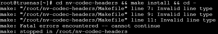

Kerros 3 Posted August 23, 2024 Posted August 23, 2024 Hello All, I'm currently running a TrueNAS and wanted to let Emby use my GPU for hardware acceleration. Verified that TrueNAS does detect my GPU. Emby does not when trying to "find it" by looking at the hardware acceleration advanced options (none pop up for hardware). After reviewing the hardware acceleration documentation (https://emby.media/support/articles/Hardware-Acceleration-on-Linux.html), I worked my way over through to Nvidia's FFmpeg installation guide for Linux here: https://docs.nvidia.com/video-technologies/video-codec-sdk/12.2/ffmpeg-with-nvidia-gpu/index.html Sub-question: I'm installing this on my main shell and not the Emby Jail. Is it supposed to be installed on the Emby Jail? Stuck on the second step where you install the ffnvcodec. For some reason, it says that the downloaded Makefile has invalid lines! Does NVIDIA have a corrupt git repository or am I missing the ball on this one completely? Any guidance would be appreciated!

Kerros 3 Posted August 30, 2024 Author Posted August 30, 2024 On 8/27/2024 at 11:20 PM, Luke said: Let us know how this goes. Thanks. Still working through it. For some reason one of the packages keeps telling me it doesn't exist.
