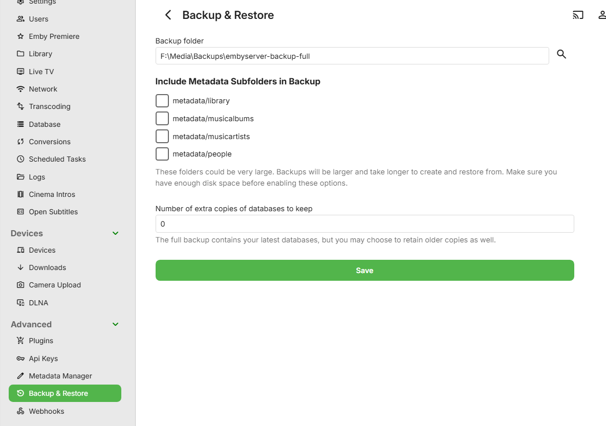

HairyBizRat 22 Posted August 23, 2024 Posted August 23, 2024 hi I had to do a fresh OS install on my server, i am an Emby Preimere subscriber, i did a backup. but when i open backup/restore plugin there is no option to restore, see iumage. What am i doing wrong here?
tedfroop21 103 Posted August 23, 2024 Posted August 23, 2024 See near the top where it says BACKUP FOLDER. If you put your backup file in that directory, the restore option should appear. You may need to restart the server once you copy the files for the option to show up.
HairyBizRat 22 Posted August 23, 2024 Author Posted August 23, 2024 (edited) 3 minutes ago, tedfroop21 said: See near the top where it says BACKUP FOLDER. If you put your backup file in that directory, the restore option should appear. You may need to restart the server once you copy the files for the option to show up. in my screen shot that is my backup folder with the full backup, nut emby doesnt offer a restore button. I've restarted the server and restarted the pc Edited August 23, 2024 by HairyBizRat
Happy2Play 9840 Posted August 23, 2024 Posted August 23, 2024 You need to change to the Backups folder not the embyserver-full-backup. But either way has your backup correct?
Gilgamesh_48 1252 Posted August 23, 2024 Posted August 23, 2024 If you see the backup you created at the bottom of the screen when you access the backup option from the bottom of the settings page then all you need to do is double click it and the restore action will commence after a couple of popups asking for confirmation.
HairyBizRat 22 Posted August 23, 2024 Author Posted August 23, 2024 19 minutes ago, Happy2Play said: You need to change to the Backups folder not the embyserver-full-backup. But either way has your backup correct? when i did the backup i did a backup and checked all options. But backup folder is called "embyserver-backup-full" and inside that folder is the below
Solution Happy2Play 9840 Posted August 23, 2024 Solution Posted August 23, 2024 You point the plugin to your backups folder not the actual backup. 1
HairyBizRat 22 Posted August 23, 2024 Author Posted August 23, 2024 thanks, my bad. I thought i pointed it to the backup folder of the backup, not the parent folder. that worked
