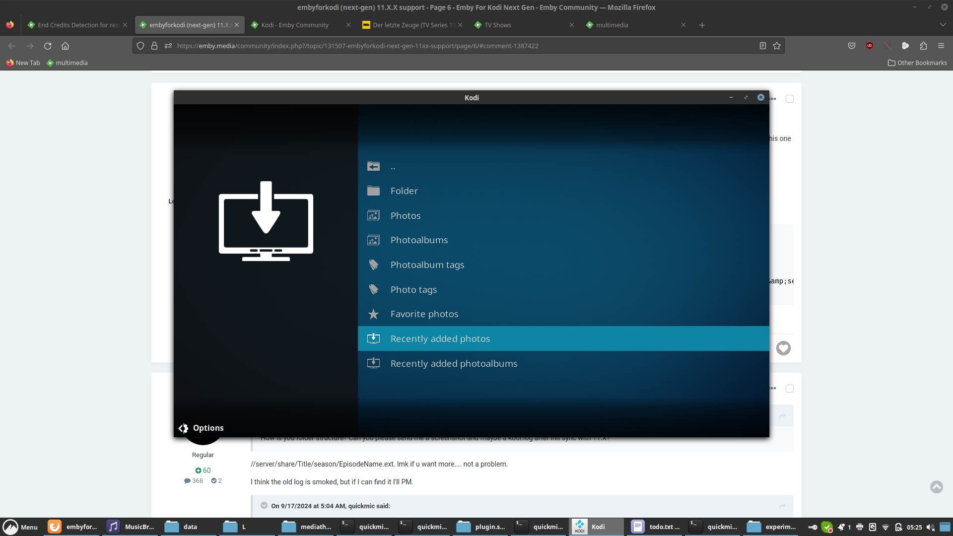

FrostByte 5452 Posted September 17, 2024 Posted September 17, 2024 @quickmic Could you add a recentlyadded_photo dynamic node to Home videos and photos? I see one for recent videos and photo albums, but not one for just plain photos. I use this one for spotlights, etc. It's basically your recentlyadded_video node, but changed the content type to Photo. recentlyadded_photo.xml <?xml version="1.0" encoding="UTF-8" standalone="yes" ?> <node order="69" type="folder"> <label>Recently added photos</label> <icon>picture.png</icon> <path>plugin://plugin.service.emby-next-gen/?mode=browse&id=19&parentid=19&libraryid=19&content=Photo&server=59e56b566f5f49b0a60ed020c43a7153&query=Recentlyadded</path> </node>

quickmic 1709 Posted September 19, 2024 Author Posted September 19, 2024 (edited) On 9/17/2024 at 8:48 PM, FrostByte said: @quickmic Could you add a recentlyadded_photo dynamic node to Home videos and photos? I see one for recent videos and photo albums, but not one for just plain photos. I use this one for spotlights, etc. It's basically your recentlyadded_video node, but changed the content type to Photo. recentlyadded_photo.xml 363 B · 1 download <?xml version="1.0" encoding="UTF-8" standalone="yes" ?> <node order="69" type="folder"> <label>Recently added photos</label> <icon>picture.png</icon> <path>plugin://plugin.service.emby-next-gen/?mode=browse&id=19&parentid=19&libraryid=19&content=Photo&server=59e56b566f5f49b0a60ed020c43a7153&query=Recentlyadded</path> </node> I'll doublecheck, but I have this node available under picture addons "Emby for Kodi Next gen (Picture)" supported by the image helper addon: It's a dynamic node as Kodi does not support picture sync. I assume you tried to access the nodes via video addon and it's not available there. Edited September 19, 2024 by quickmic

FrostByte 5452 Posted September 19, 2024 Posted September 19, 2024 (edited) 7 hours ago, quickmic said: I'll doublecheck, but I have this node available under picture addons "Emby for Kodi Next gen (Picture)" supported by the image helper addon: It's a dynamic node as Kodi does not support picture sync. I assume you tried to access the nodes via video addon and it's not available there. When I try that all I can do is add the folder for "Home videos & photos" However, when I try the libraries "How to videos" and "Surveillance Cameras" I can see what you're seeing. Is it possible that it doesn't like the "&" in the folder or library name? All 3 of those libraries are of type "Home videos & photos" in Emby. It's just that one is named that also. Edited September 19, 2024 by FrostByte
FrostByte 5452 Posted September 19, 2024 Posted September 19, 2024 However, I can see the video nodes when I go through the video addon like you mentioned. Tried a node reset, still can't see any dynamic image nodes for that one library.
quickmic 1709 Posted September 19, 2024 Author Posted September 19, 2024 2 hours ago, FrostByte said: However, I can see the video nodes when I go through the video addon like you mentioned. Tried a node reset, still can't see any dynamic image nodes for that one library. I'll check the "&". Might be an issue...

quickmic 1709 Posted September 20, 2024 Author Posted September 20, 2024 13 hours ago, quickmic said: I'll check the "&". Might be an issue... Yes it is the "&". I'll fix it in next version. 1

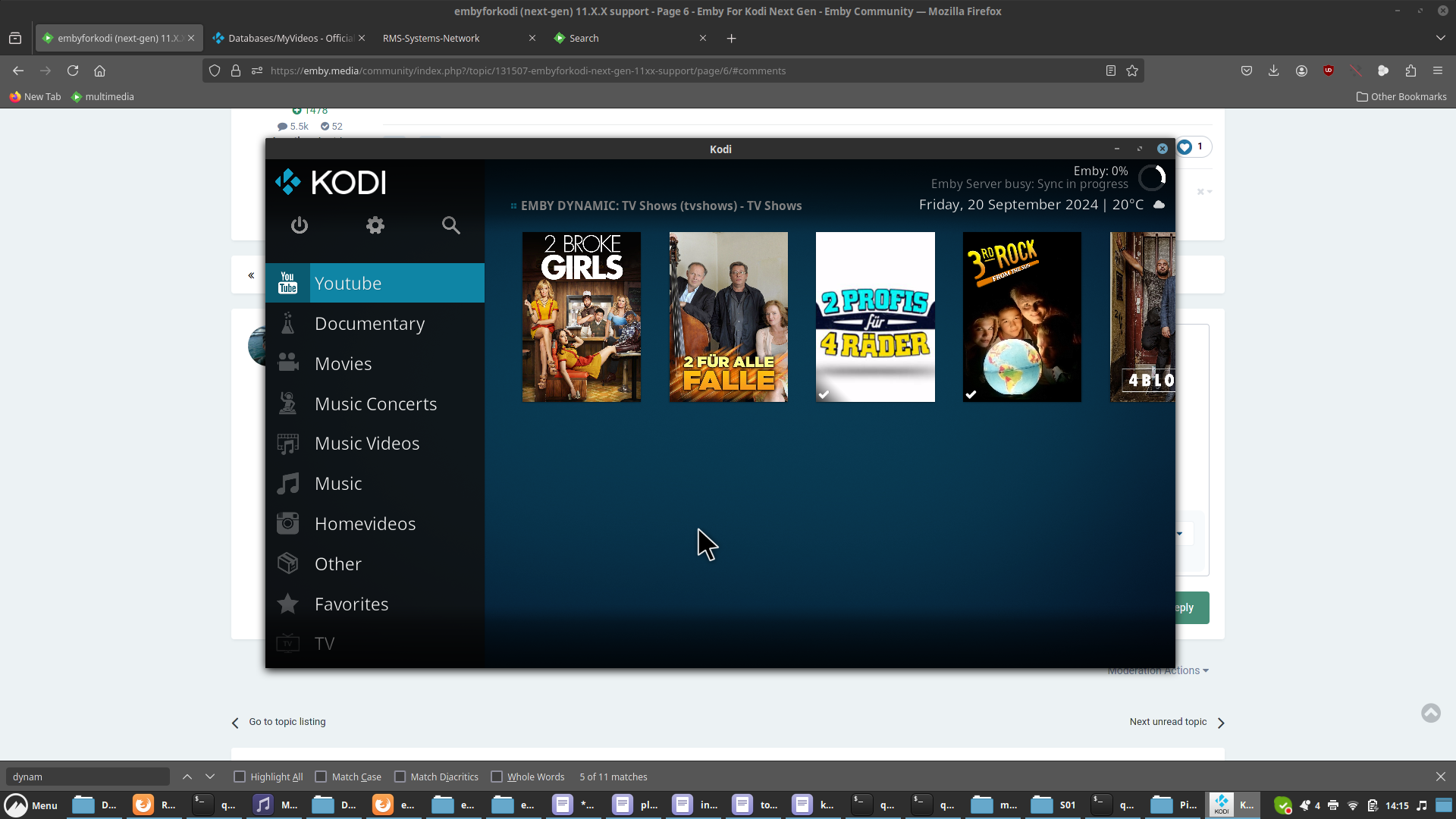

quickmic 1709 Posted September 20, 2024 Author Posted September 20, 2024 On 9/18/2024 at 9:16 PM, voodoo5_6k said: After the upgrade to 11.X (and the reset), the main page of e.g. my documentaries node would show that all episodes were watched (i.e., 0 unwatched). That is wrong however, and selecting a series, everything would be shown correctly. No issue here
voodoo5_6k 29 Posted September 20, 2024 Posted September 20, 2024 Thanks for looking into this. Interesting. Well, I'll check it again when I go back to 11.X. Yesterday, I've reinstalled the device using CE 21.1.1 stable and 10.0.47 to see whether I could reproduce the playback glitches. And I could. Have started a discussion with the CE team to see what they make out of the debug log (at least once I can upload it there... seems difficult at the moment). For the time being I'll keep the device on CE stable and emby-for-kodi-next-gen stable. Once the playback glitches have been sorted out, I'll move back to 11.X. Thanks @quickmic 1
