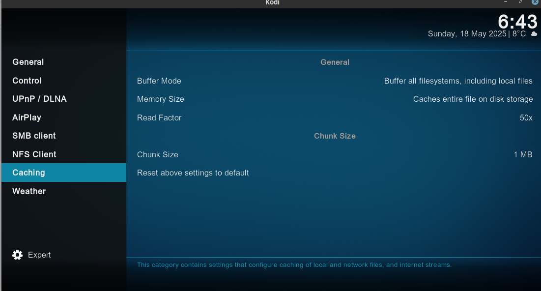

jonomite 29 Posted May 18, 2025 Posted May 18, 2025 21 minutes ago, quickmic said: Sounds your EMby server is busy/overloaded and I can see the server was scanning when the stream stalled. Increasing Kodi's video cache will also help. Interesting. I'd be curious to know more about this - where in the log does it show that? I recently build a new (much, much upgraded) server so it is surprising to hear that it is overloaded. Also, I'm curious for your thoughts on which Kodi cache settings to modify. https://kodi.wiki/view/Settings/Services/Caching There are quite a few settings. Do you recommend changing all of them?
quickmic 1709 Posted May 18, 2025 Author Posted May 18, 2025 (edited) 50 minutes ago, jonomite said: I recently build a new (much, much upgraded) server so it is surprising to hear that it is overloaded. Good server hardware helps but for large libraries etc. scans can still "overload" the server (actually the Emby application becomes unresponsive for http requests for a couple of seconds). Even on my Dell server this can happen on long running (sqlite) database queries on the server. If you think it's not a server issue, might be a network issue or Kodi bug. Impossible to say remotely, surly not a plugin issue. -> Probably IPV6 issue? You could also try disable it. Kodi cache helps if you buffer more data into the ram, or as I do using the complete disk. Caching everything might wear out your disk! Read the Kodi docu. btw, Cache settings are not respected for trans-coding streams (hls streams) Quote Interesting. I'd be curious to know more about this - where in the log does it show that? Cause Emby server is sending realtime updates via websocket to Kodi and I assume you didn't modify metadata manually? EMBY.hooks.websocket: [ LibraryChanged ] Kodi log reports: 2025-05-17 19:59:41.325 T:13085 error <general>: CCurlFile::CReadState::FillBuffer - (0x78d06520) Failed: Timeout was reached(28) 2025-05-17 19:59:41.325 T:13085 warning <general>: CCurlFile::CReadState::FillBuffer - (0x78d06520) Reconnect, (re)try 1 Kodi tries to pull data, and usually a "(re)try)" works but if it's too much this happens -> CVideoPlayerAudio::Process - stream stalled Edited May 18, 2025 by quickmic

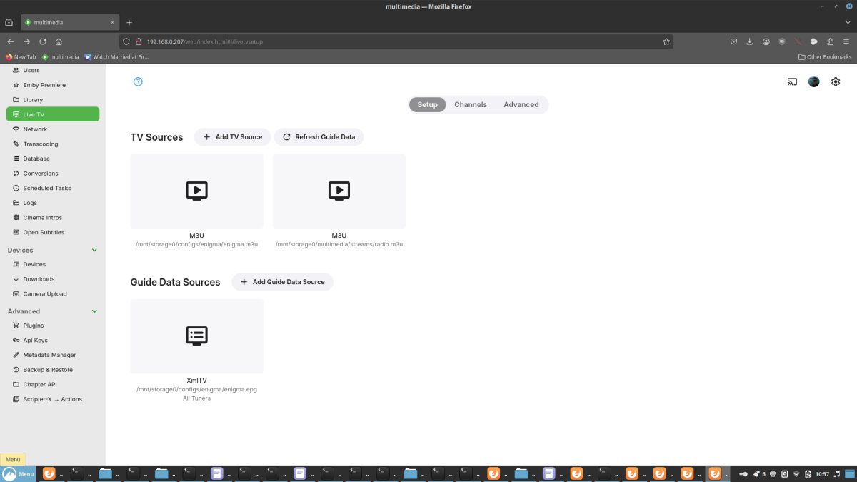

quickmic 1709 Posted May 18, 2025 Author Posted May 18, 2025 On 4/25/2025 at 2:09 PM, kalg said: Do you use embys live TV with their TV guide for epg ?? If so when you highlight a show in the TV guide you get art image of a show , with me now? What I'm saying is that isn't getting imported to Kodi IE no EPG images of the TV guide that emby has . Are you not familiar with EPG guide images ?? First image is on emby server TV guide I'm highlighting Dracula then I clicked it to show you next screen see cover art. Now third screen is Kodi with your plugin and enabled live TV sync but cover art not imported into IPTV simple client I tried to add images to my epg file, but Emby does not support that. I use M3U source with XMLTV epg on Emby server, which one do you use?
quickmic 1709 Posted May 18, 2025 Author Posted May 18, 2025 (edited) 1 hour ago, kalg said: emby's own tv guide data I"m not sure what you are talking about: The only source I can add under "Guide Data Sources" is XmlTv as I have no other plugins installed. btw. "Emby Guide Data" is for US, Canada and UK only. I'm not based there. Edited May 18, 2025 by quickmic
kalg 5 Posted May 18, 2025 Posted May 18, 2025 Oh thought it was for many countries because you have to select the country lots . Any how that's the guide I'm using, by default, just tried it with the xmltv using epg123 from green button forum and that does the same, so looks like it wont work thanks for the time you tried
jonomite 29 Posted May 18, 2025 Posted May 18, 2025 10 hours ago, quickmic said: Good server hardware helps but for large libraries etc. scans can still "overload" the server (actually the Emby application becomes unresponsive for http requests for a couple of seconds). Even on my Dell server this can happen on long running (sqlite) database queries on the server. If you think it's not a server issue, might be a network issue or Kodi bug. Impossible to say remotely, surly not a plugin issue. -> Probably IPV6 issue? You could also try disable it. Kodi cache helps if you buffer more data into the ram, or as I do using the complete disk. Caching everything might wear out your disk! Read the Kodi docu. btw, Cache settings are not respected for trans-coding streams (hls streams) Cause Emby server is sending realtime updates via websocket to Kodi and I assume you didn't modify metadata manually? EMBY.hooks.websocket: [ LibraryChanged ] Kodi log reports: 2025-05-17 19:59:41.325 T:13085 error <general>: CCurlFile::CReadState::FillBuffer - (0x78d06520) Failed: Timeout was reached(28) 2025-05-17 19:59:41.325 T:13085 warning <general>: CCurlFile::CReadState::FillBuffer - (0x78d06520) Reconnect, (re)try 1 Kodi tries to pull data, and usually a "(re)try)" works but if it's too much this happens -> CVideoPlayerAudio::Process - stream stalled Thank you for your insights. I will try changing some of the cache settings. Correct that I am not editing any metadata manually. Do you know why that might be showing up in the log? Is there anything I can do reduce that from happening?
quickmic 1709 Posted May 18, 2025 Author Posted May 18, 2025 51 minutes ago, jonomite said: Thank you for your insights. I will try changing some of the cache settings. Correct that I am not editing any metadata manually. Do you know why that might be showing up in the log? Is there anything I can do reduce that from happening? You need to check what kind of tasks are running on the server. Probably enable debug log on Emby server for better insights.
