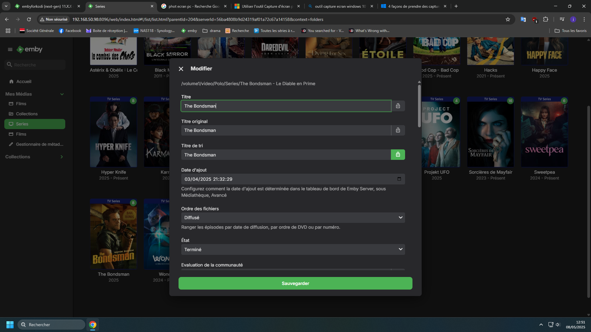

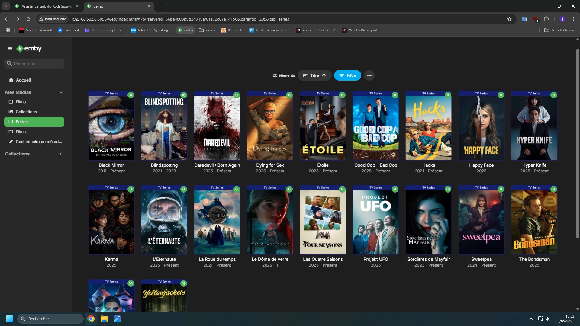

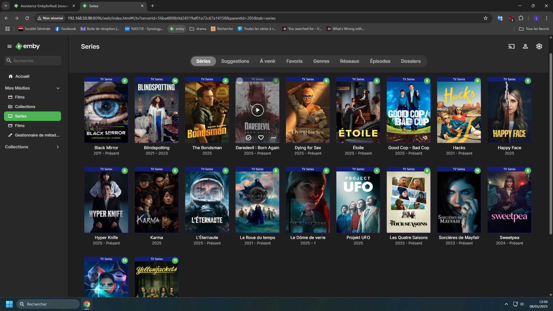

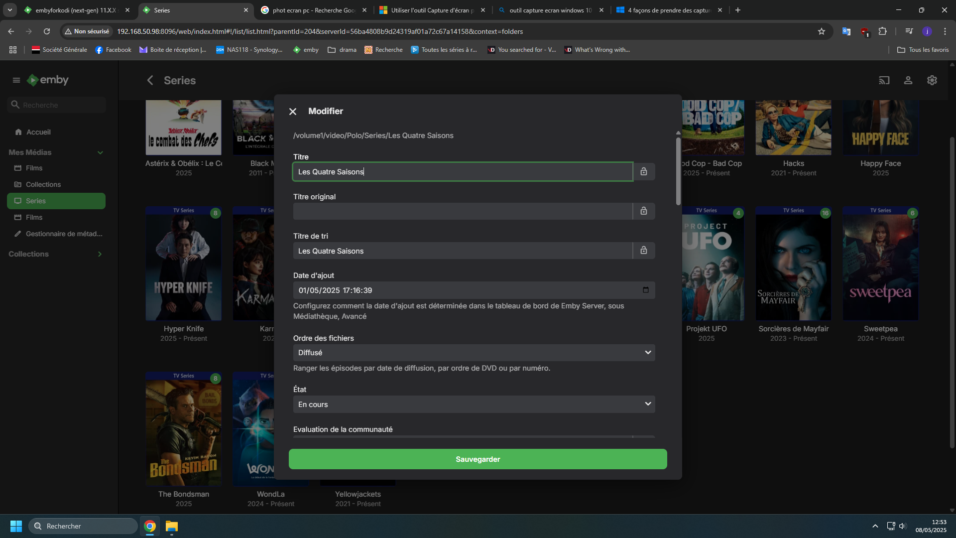

polo2907 2 Posted May 8, 2025 Posted May 8, 2025 Hello Thank you for your work. In Emby, I take into account the articles (the, a,le,la un,une ) when sorting my movies and series. How do I configure EmbyforKodi (next-gen) so that this is taken into account in Kodi? Currently, this is not the case. Emby 4.8.11 EmbyforKodi (next-gen) 11.1.27 Thank you in advance. Sorry for the English, I'm using Google Translate.
quickmic 1709 Posted May 8, 2025 Author Posted May 8, 2025 (edited) 26 minutes ago, polo2907 said: Hello Thank you for your work. In Emby, I take into account the articles (the, a,le,la un,une ) when sorting my movies and series. How do I configure EmbyforKodi (next-gen) so that this is taken into account in Kodi? Currently, this is not the case. Emby 4.8.11 EmbyforKodi (next-gen) 11.1.27 Thank you in advance. Sorry for the English, I'm using Google Translate. The sort title on Emby must be correct, is this the case? Edited May 8, 2025 by quickmic
quickmic 1709 Posted May 8, 2025 Author Posted May 8, 2025 Just now, polo2907 said: like this That's the problem. "titre de tri" is used as sort order. You must fix it on Emby side. -> "Les Quatre Saisons" should be "Quatre Saisons"
polo2907 2 Posted May 8, 2025 Posted May 8, 2025 it's not possible to use "les" ? because I prefer "Les quatre saisons" to be referenced with "les" rather than with "quatre" I don't know if I'm expressing myself correctly. In any case, thank you for these very quick responses.
quickmic 1709 Posted May 8, 2025 Author Posted May 8, 2025 35 minutes ago, polo2907 said: it's not possible to use "les" ? because I prefer "Les quatre saisons" to be referenced with "les" rather than with "quatre" I don't know if I'm expressing myself correctly. In any case, thank you for these very quick responses. "les" will be visible in the view list. Remove the "les" ONLY in "titre de tri". That's the sort order, the title is still "Les quatre saisons". Simply try it.

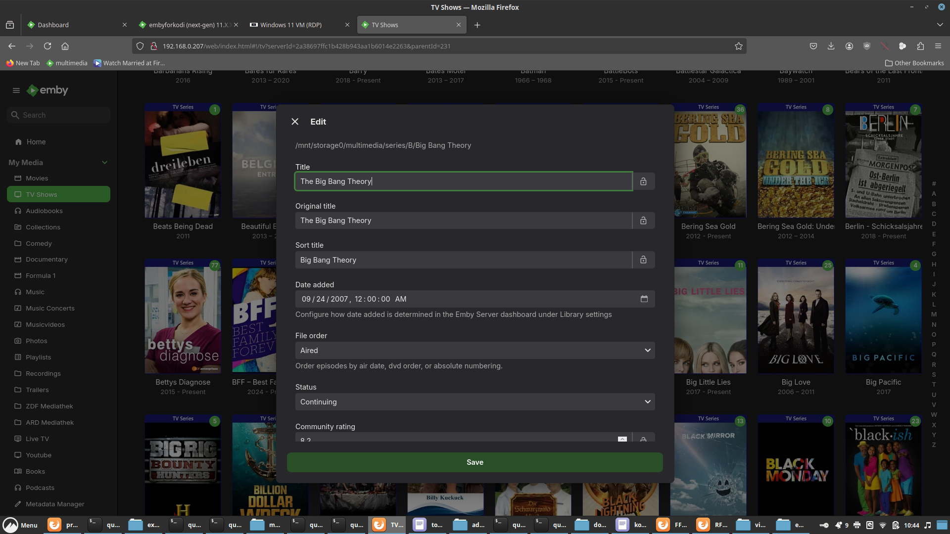

polo2907 2 Posted May 8, 2025 Posted May 8, 2025 If I delete "the" or "les" this is what I have in emby
quickmic 1709 Posted May 8, 2025 Author Posted May 8, 2025 2 minutes ago, polo2907 said: If I delete "the" or "les" this is what I have in emby Looks ok, now Kodi should be fine too. "Les Quatre Saisons" is now sorted alphabetically by "Q" and no longer by "L".

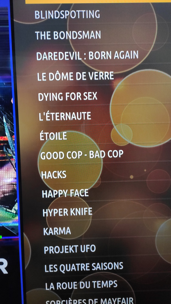

polo2907 2 Posted May 8, 2025 Posted May 8, 2025 But I prefer it this way and whether it's one way or the other, nothing changes in codi
quickmic 1709 Posted May 8, 2025 Author Posted May 8, 2025 1 minute ago, polo2907 said: But I prefer it this way and whether it's one way or the other, nothing changes in codi Oh, you want the article as sort order? Sorry, I misunderstood you. Then re-add the article. Not sure why Kodi does not respect that, it should.
polo2907 2 Posted May 8, 2025 Posted May 8, 2025 Yes, that's exactly it. I want the sorting to be done by "L" and no longer by "Q." I know how to do it in Emby, but I can't do it in Kodi. Perhaps there's a setting in Emby for Kodi (next-gen) 11.1.27 or in Kodi?
FrostByte 5452 Posted May 8, 2025 Posted May 8, 2025 Is this what you're looking for? I think the default is on. https://kodi.wiki/view/Settings/Media/General#Ignore_articles_when_sorting You can add more articles in advanced settings file also 1
polo2907 2 Posted May 8, 2025 Posted May 8, 2025 Thank you so much, I've been looking for this for so long. It was actually the second line that needed to be unchecked "Ignore articles when sorting" Thank you both @quickmic @FrostByte 2
