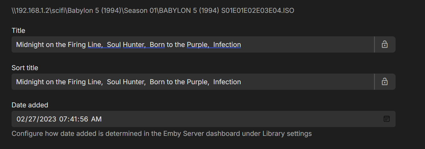

quickmic 1709 Posted February 17, 2025 Author Posted February 17, 2025 5 hours ago, kougei said: Try this https://paste.coreelec.org/GeigerWanda Thanks, I can see Kodi tries to access this path: smb://192.168.1.2/scifi/Babylon 5 (1994)/Season 01/BABYLON 5 (1994) S01E01E02E03E04.ISO 1. Is the path correct? 2. Did you mount the shared network path in Kodi? 3. Can you browse the path in Kodi's filebrowser? 4. The filename is all uppercase, is this also correct?

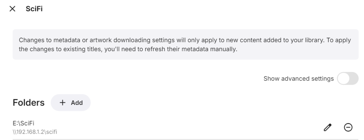

kougei 7 Posted February 17, 2025 Posted February 17, 2025 16 hours ago, quickmic said: Thanks, I can see Kodi tries to access this path: smb://192.168.1.2/scifi/Babylon 5 (1994)/Season 01/BABYLON 5 (1994) S01E01E02E03E04.ISO 1. Is the path correct? The path is correct. But it’s an NFS share, not SMB so not sure why it’s trying that with SMB share prefix 2. Did you mount the shared network path in Kodi? Yes, the shares are added as Sources in File Manager, assuming that means the same thing. 3. Can you browse the path in Kodi's filebrowser? Yes, I can even browse into the ISO containers. 4. The filename is all uppercase, is this also correct? Yes all my ISOs are saved with that syntax, I use an strm file to map scraped episodes to the correct ISO See replies above
quickmic 1709 Posted February 18, 2025 Author Posted February 18, 2025 (edited) 6 hours ago, kougei said: The path is correct. But it’s an NFS share, not SMB so not sure why it’s trying that with SMB share prefix Ok, than it cannot work for obvious reasons. Question 2-4 is obsolete then. Without additional info, I can only guess. I assume you already tried a plugin's library repair sync. 1. Did you use smb in the past, that would explain why it worked before. Frankly, I think it's not really a plugin issue, but I'll check it. 2. Do you use network paths on Emby server for the library and if so, check it and post it. 3. If not, I need details of your folder you use on Emby server. Edited February 18, 2025 by quickmic

kougei 7 Posted February 18, 2025 Posted February 18, 2025 5 hours ago, quickmic said: Ok, than it cannot work for obvious reasons. Question 2-4 is obsolete then. Without additional info, I can only guess. I assume you already tried a plugin's library repair sync. 1. Did you use smb in the past, that would explain why it worked before. Frankly, I think it's not really a plugin issue, but I'll check it. 2. Do you use network paths on Emby server for the library and if so, check it and post it. 3. If not, I need details of your folder you use on Emby server. 1. I can use smb yes, but no, I've always used NFS in the past 2. Yes I use Network paths in the Emby Server If you recall I said playback was working for the Music Folder, not the Video folders. Well I think the reason is that I had an SMB Share setup for Music, as well as NTFS as my Blusound streamer can only access SMB shares. Well I think its highly probable that Emby is finding the SMB share instead of the NFS share for music, as the IP/sharename is identical. So to test this I just added an SMB share for that Scifi share, added it as a Source in FileManager, and lo and behold the B5 ISO referenced above now plays back when accessed from the video wall scraper. So I think the issue is, that with a path as shown here in Meta-Data Manager, for whatever reason when you select it via Emby NexctGen, it is automatically assuming it is an SMB path instead of an NFS path. 1
quickmic 1709 Posted February 18, 2025 Author Posted February 18, 2025 (edited) 8 hours ago, kougei said: So I think the issue is, that with a path as shown here in Meta-Data Manager, for whatever reason when you select it via Emby NexctGen, it is automatically assuming it is an SMB path instead of an NFS path. Correct, cause your path substitution reflects a Windows network share and that's turned into a smb:// share (so Kodi can parse it). The plugin mapping is correct and your substitution is wrong for nfs. a nfs substitution should look like nfs://192.168.1.2/scifi After fixing, you need a repair sync on Kodi/plugin btw, if you use addon mode, it doesn't matter what the network path substation is (even it's wrong). It will always works. Only for ISO (which must be played natively) it matters. Edited February 18, 2025 by quickmic

kougei 7 Posted February 18, 2025 Posted February 18, 2025 8 hours ago, quickmic said: Correct, cause your path substitution reflects a Windows network share and that's turned into a smb:// share (so Kodi can parse it). The plugin mapping is correct and your substitution is wrong for nfs. a nfs substitution should look like nfs://192.168.1.2/scifi After fixing, you need a repair sync on Kodi/plugin btw, if you use addon mode, it doesn't matter what the network path substation is (even it's wrong). It will always works. Only for ISO (which must be played natively) it matters. OK, this looks like it will allow me to fix things.i really appreciate the help. Need to point out though, this has previously worked without this issue, albeit between CoreElec updates and using NextGen 11.x over 10.x previously something changed. Likewise the path used in Emby server I always followed the syntax example in the Emby Server UI when you add a library, and with this syntax successfully played back files irrespective of using SMB versus NFS shares, I preferred NFS simply because they don’t require user/password on local network. 1
