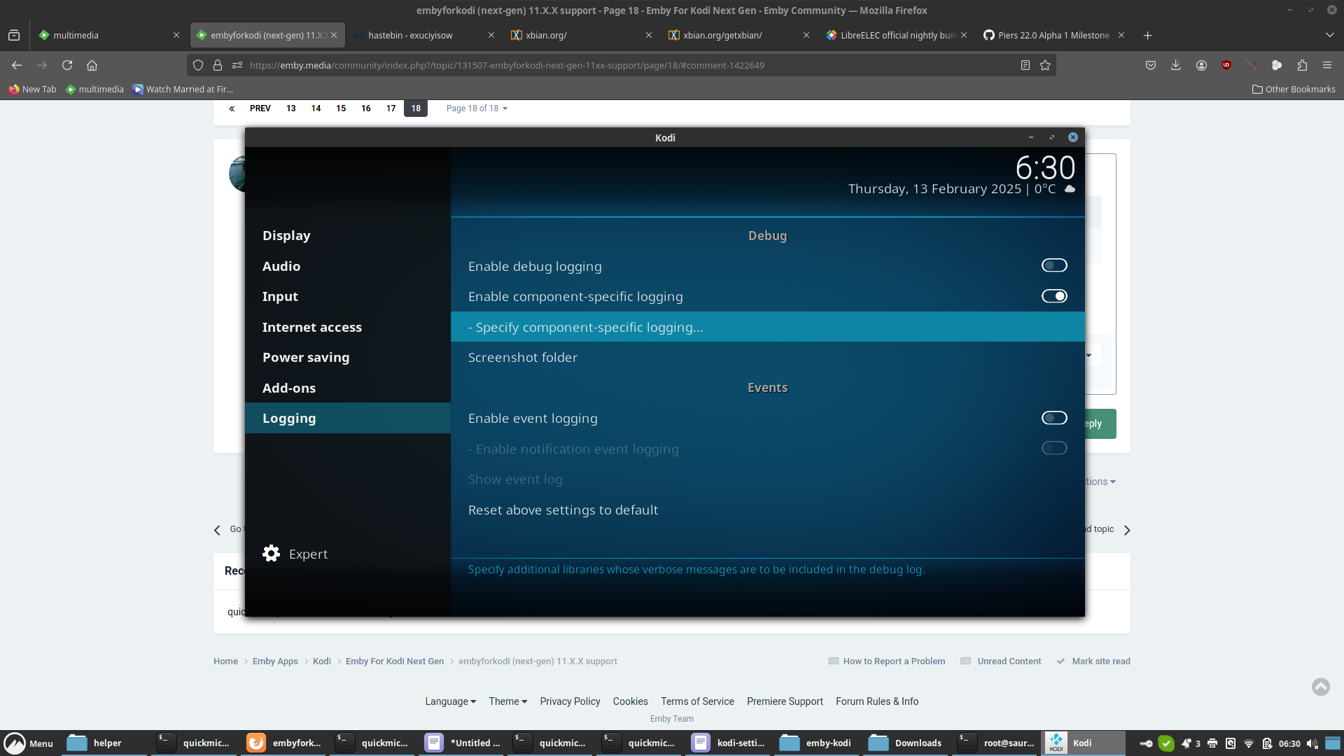

quickmic 1709 Posted February 13, 2025 Author Posted February 13, 2025 (edited) 32 minutes ago, t123thomas said: both LE & Windows has user data folder > playlist > video inside are list of my shortcuts from emby each category has .xsp at the end also xsp and file type Please enable the extra logging options and upload a new log. Currently I down know why LE thinks the file is corrupt. Debug log must be also enabled. (in the screenshot it's disabled). Edited February 13, 2025 by quickmic

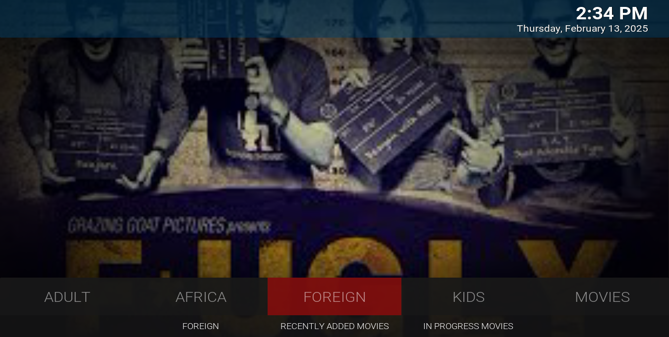

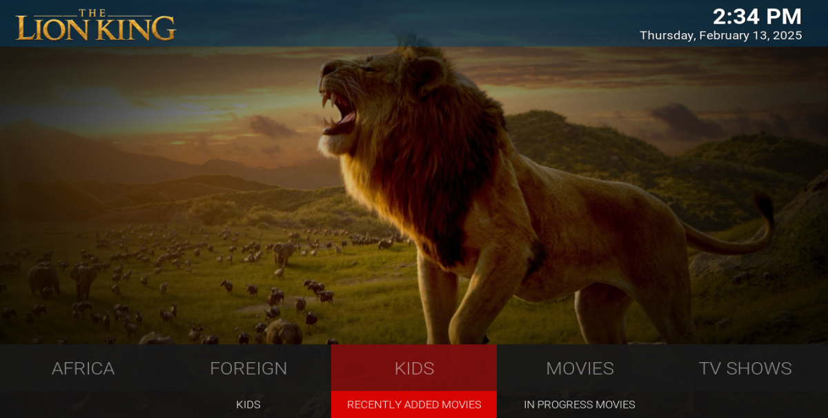

t123thomas 63 Posted February 13, 2025 Posted February 13, 2025 (edited) 6 hours ago, t123thomas said: Thanks for troubleshooting the issue, I will make the change myself, that forum is very slow to respond @Quickmic Thanks your proposed changes resolved the issue, however, each category it ought to have submenu, such newly added, progress watch, Genre etc, Please what changes do think can be made for the skin to include these sub menu as this was working in the previous skin/emby4kodi versions Thanks most appreciated Edited February 13, 2025 by t123thomas
quickmic 1709 Posted February 13, 2025 Author Posted February 13, 2025 11 minutes ago, t123thomas said: @Quickmic Thanks your proposed changes resolved the issue, however, each category it ought to have submenu, such newly added, progress watch, Genre etc, Please what changes do think can be made for the skin to include these sub menu as this was working in the previous skin/emby4kodi versions Thanks most appreciated New log Log Well, I don't know this this but I'm quite sure is it fully customizable. As mentioned, I would avoid all this implemented helper-features and only use the next-gen plugin nodes. I'll have a look into that in the next days next days but don't expect too much from me. I don't know what you expect from the skin. Have a look here, skins usually all works the same:
t123thomas 63 Posted February 13, 2025 Posted February 13, 2025 53 minutes ago, quickmic said: Well, I don't know this this but I'm quite sure is it fully customizable. As mentioned, I would avoid all this implemented helper-features and only use the next-gen plugin nodes. I'll have a look into that in the next days next days but don't expect too much from me. I don't know what you expect from the skin. Have a look here, skins usually all works the same: I have added the sub menu manually, but it would have been nice if its auto populated which what it used to be Thanks for the efforts and supports 1
