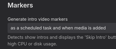

jimbobjonesbob 7 Posted January 25, 2025 Posted January 25, 2025 (edited) 1 hour ago, quickmic said: Did you check the Marker options in your Emby library settings? some files work, some don't If I create a new library , the folder I add into the new library when I create it are all working fine. But if I remove an episode and add it back, it no longer has the skip intro. However, if I run the manual task, it works - but then won't work in Kodi , because as you said, a metadata change doesn't push through. Edited January 25, 2025 by jimbobjonesbob
quickmic 1709 Posted January 25, 2025 Author Posted January 25, 2025 (edited) 18 minutes ago, jimbobjonesbob said: metadata change doesn't push through. Metadata changes are pushed, but not SkipIntro (Marker) changes (only). Library settings looks ok, was it always as the screenshot or did you modify it? Usually the intro markers never changed after you added content to Emby and they are all synced to Kodi (cause it's new file and all metadata changed). If the markers are not available when added new content and you add the markers later via task it will not be reported. However, this should not be the case with the library settings in your screenshot. If no metadata changes reported to Kodi at all (you can test that by renaming an episode), that's an different issue and has nothing to do with markers. Then it's probably a websocket issue etc. If the rename works and you have a file which has markers on Emby but not on Kodi, you can rename the file as well (as a test). You will see the markers will be updated without trigger a repair sync on Kodi. -> Emby reports the (name) metadata change to Kodi and the plugin will update all metadata including the markers. That's why I mentioned, the core issue should be fixed. The markers must be added at the time the content was added to Emby. As you mentioned, some content don't have markers on Emby and you need to add them via task, that's the issue. I assume you have several episodes on Emby server without markers, so you need to fix them all on Emby server first and then trigger a repair sync. And if you configured Emby probably adding all markers on content added, you will never run into this issue again. Edited January 25, 2025 by quickmic
jimbobjonesbob 7 Posted January 25, 2025 Posted January 25, 2025 (edited) 9 minutes ago, quickmic said: And if you configured Emby probably adding all markers on content added, you will never run into this issue again. tnx for your help My screenshot has always been this way - my library is meant to add intro markers on content added. I renamed an episode and it came through to kodi changed okay Edited January 25, 2025 by jimbobjonesbob
