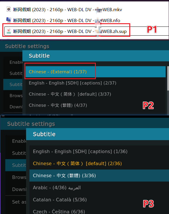

whisperer 11 Posted December 14, 2024 Posted December 14, 2024 Hi, the second issue matches what I’m experiencing. For the first issue, my case is a bit different: I have an external subtitle file (same name as the video) in the same directory as the video (P1). In native mode, the external subtitle appears in the subtitle list and is selected by default (P2). In addon mode, the external subtitle doesn’t show up in the subtitle list at all (P3).
quickmic 1709 Posted December 14, 2024 Author Posted December 14, 2024 1 hour ago, whisperer said: Hi, the second issue matches what I’m experiencing. For the first issue, my case is a bit different: I have an external subtitle file (same name as the video) in the same directory as the video (P1). In native mode, the external subtitle appears in the subtitle list and is selected by default (P2). In addon mode, the external subtitle doesn’t show up in the subtitle list at all (P3). Please upload the subtitle file for review.
whisperer 11 Posted December 14, 2024 Posted December 14, 2024 22 minutes ago, quickmic said: Please upload the subtitle file for review. Thanks, here is a sample subtitle. pgs_subtitle_sample.sup 1
quickmic 1709 Posted December 14, 2024 Author Posted December 14, 2024 (edited) 1 hour ago, whisperer said: Thanks, here is a sample subtitle. pgs_subtitle_sample.sup 27.6 MB · 0 downloads Thanks, I can see the problem. The subtitle size is quite big and the download times out after 6 seconds. I'll increase the timeout for subtitle download in next version, but frankly not sure if it's a great idea to use pgs subtitles. Edited December 14, 2024 by quickmic 1
