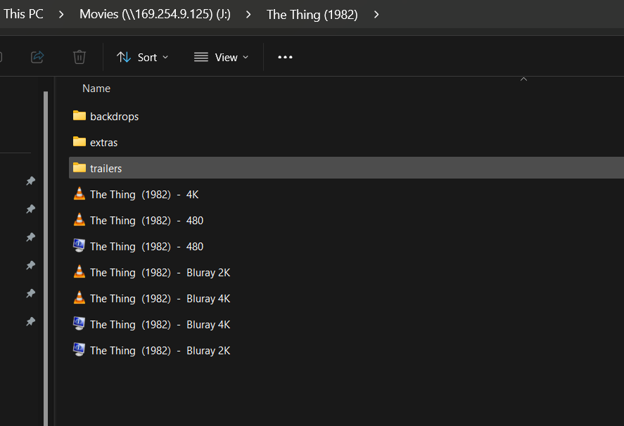

Kyrunner 86 Posted December 1, 2024 Posted December 1, 2024 @quickmic I have a good one for you. if I have a movie with multiple version’s Kodi doesn’t see the extras or the local movie trailer. If there is no multiple version of the movie Kodi sees the extras and the local movie trailer.
quickmic 1709 Posted December 1, 2024 Author Posted December 1, 2024 26 minutes ago, Kyrunner said: @quickmic I have a good one for you. if I have a movie with multiple version’s Kodi doesn’t see the extras or the local movie trailer. If there is no multiple version of the movie Kodi sees the extras and the local movie trailer. I just checked, and I can see both. Is there a pattern, when extras or trailer are missing? Native mode?
Kyrunner 86 Posted December 1, 2024 Posted December 1, 2024 17 minutes ago, quickmic said: I just checked, and I can see both. Is there a pattern, when extras or trailer are missing? Native mode? I'm using default mode. The only time I don't see extras or local trailers is when there are multiple versions of the movie in the movie folder. I also noticed it might be the same way in Emby, which might be an Emby issue.
quickmic 1709 Posted December 1, 2024 Author Posted December 1, 2024 1 hour ago, Kyrunner said: I also noticed it might be the same way in Emby, which might be an Emby issue. Then it's not a plugin issue. Did you group the versions manually? If yes, that might be the issue.
Kyrunner 86 Posted December 1, 2024 Posted December 1, 2024 15 minutes ago, quickmic said: Then it's not a plugin issue. Did you group the versions manually? If yes, that might be the issue. I did group them. What is the proper way.

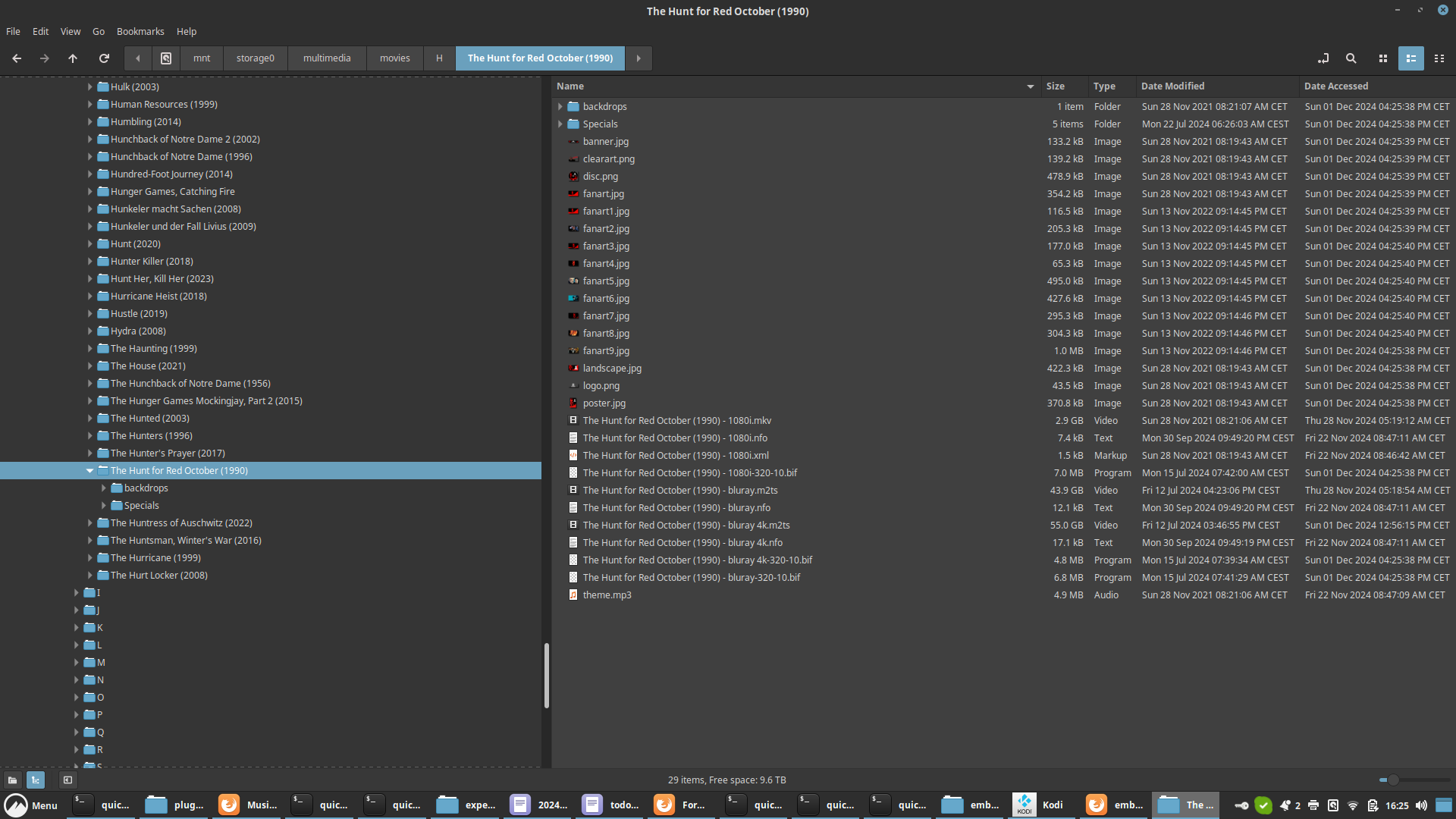

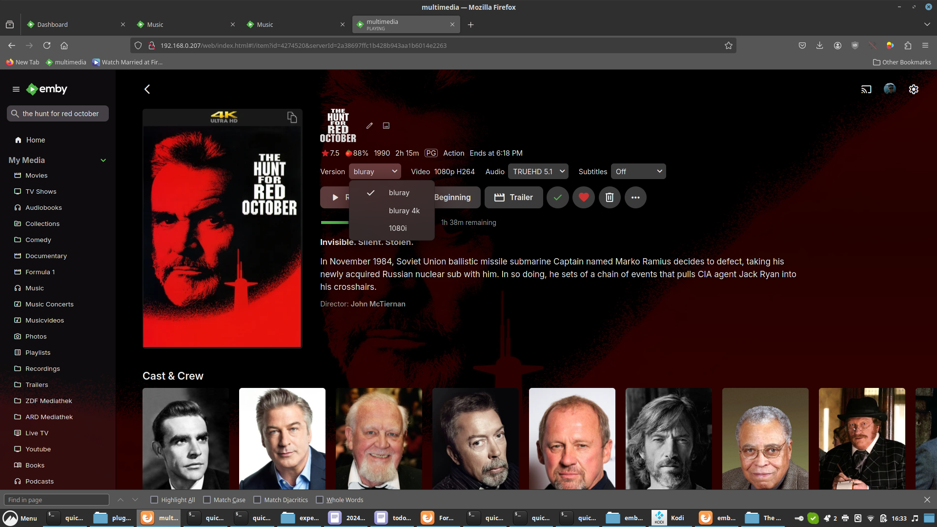

quickmic 1709 Posted December 1, 2024 Author Posted December 1, 2024 (edited) 1 hour ago, Kyrunner said: I did group them. What is the proper way. Let Emby do it for you. The filenaming must be modified. Subfolder name must be equal as (base)filename and the string after the dash is the subversion ID. No other dashes are allowed in the filename!. Dash is the separator! After that, trigger a rescan on Emby and it will be grouped automatically including extras and trailers. Put local trailer under specials or in the subfolder -> The Hunt for Red October (1990)-trailer.mp4. Maybe The Hunt for Red October (1990) - trailer.mp4 works to, but not tested. When I have it in the subfolder, I use "-" not " - " for trailer. Also other filenaming might work too, but I know for sure, my naming works. Edited December 1, 2024 by quickmic
Kyrunner 86 Posted December 1, 2024 Posted December 1, 2024 43 minutes ago, quickmic said: Let Emby do it for you. The filenaming must be modified. Subfolder name must be equal as (base)filename and the string after the dash is the subversion ID. No other dashes are allowed in the filename!. Dash is the separator! After that, trigger a rescan on Emby and it will be grouped automatically including extras and trailers. Put local trailer under specials or in the subfolder -> The Hunt for Red October (1990)-trailer.mp4. Maybe The Hunt for Red October (1990) - trailer.mp4 works to, but not tested. When I have it in the subfolder, I use "-" not " - " for trailer. Also other filenaming might work too, but I know for sure, my naming works. I have mine set up like that but in Emby they don't combine them they are 4 separate movies in Emby
quickmic 1709 Posted December 1, 2024 Author Posted December 1, 2024 Did you remove the nfo before the rescan?
Kyrunner 86 Posted December 1, 2024 Posted December 1, 2024 4 minutes ago, quickmic said: Did you remove the nfo before the rescan? Yes. I removed nfo then done a new scan I even tried to refresh metadata
quickmic 1709 Posted December 1, 2024 Author Posted December 1, 2024 19 minutes ago, Kyrunner said: Yes. I removed nfo then done a new scan I even tried to refresh metadata Well, then I don't know. Works like a charm on my setup.

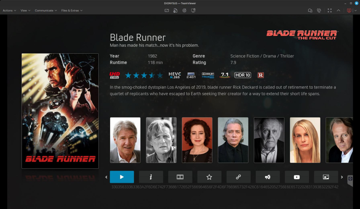

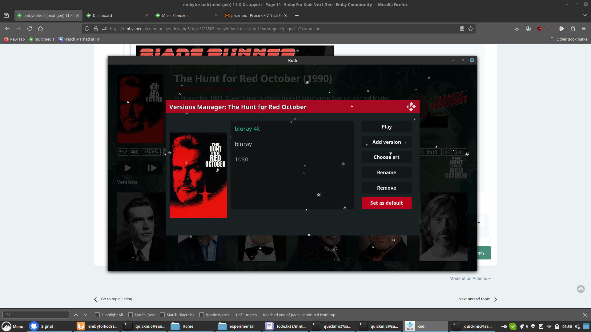

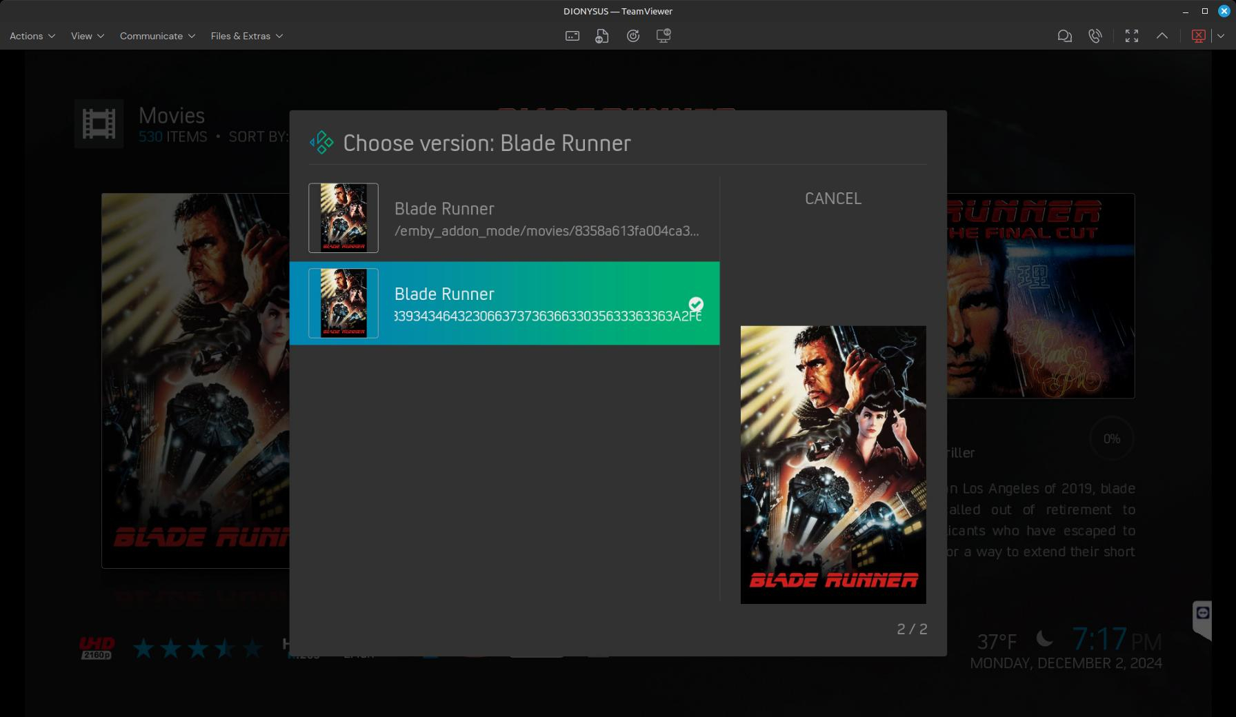

rotational467 44 Posted December 3, 2024 Posted December 3, 2024 (edited) This might be/probably is a skin issue (Arctic Zephyr Reloaded)? I'm not sure because this is first movie I've added multiple versions for and I don't know how multiple versions should work in Kodi+E4K. If playing direct from the library list, I do get a version picker dialog, there's no metadata though the versions are in the same order as other clients, 4K first. Choose version is also available in the item's context menu. From the movie detail screen, it defaults to the 4K version with no way to change it, including in the "Manage" menu. Kodi 21.1, Emby 4.8.10.0, E4K 11.1.8 in add-on mode. Did a factory reset when moving from 11.1.5 to beta 11.1.8. Edited December 3, 2024 by rotational467 fat fingers
quickmic 1709 Posted December 3, 2024 Author Posted December 3, 2024 (edited) 2 hours ago, rotational467 said: This might be/probably is a skin issue (Arctic Zephyr Reloaded)? I'm not sure because this is first movie I've added multiple versions for and I don't know how multiple versions should work in Kodi+E4K. If playing direct from the library list, I do get a version picker dialog, there's no metadata though the versions are in the same order as other clients, 4K first. Choose version is also available in the item's context menu. From the movie detail screen, it defaults to the 4K version with no way to change it, including in the "Manage" menu. Kodi 21.1, Emby 4.8.10.0, E4K 11.1.8 in add-on mode. Did a factory reset when moving from 11.1.5 to beta 11.1.8. In my skin there is an option to change the default version in the info screen -> versions. In plugin's config menu -> sync -> there is an option "Set highest video resolution as default". If you disable, it will be the same order as Emby server lists the versions. Edited December 3, 2024 by quickmic
