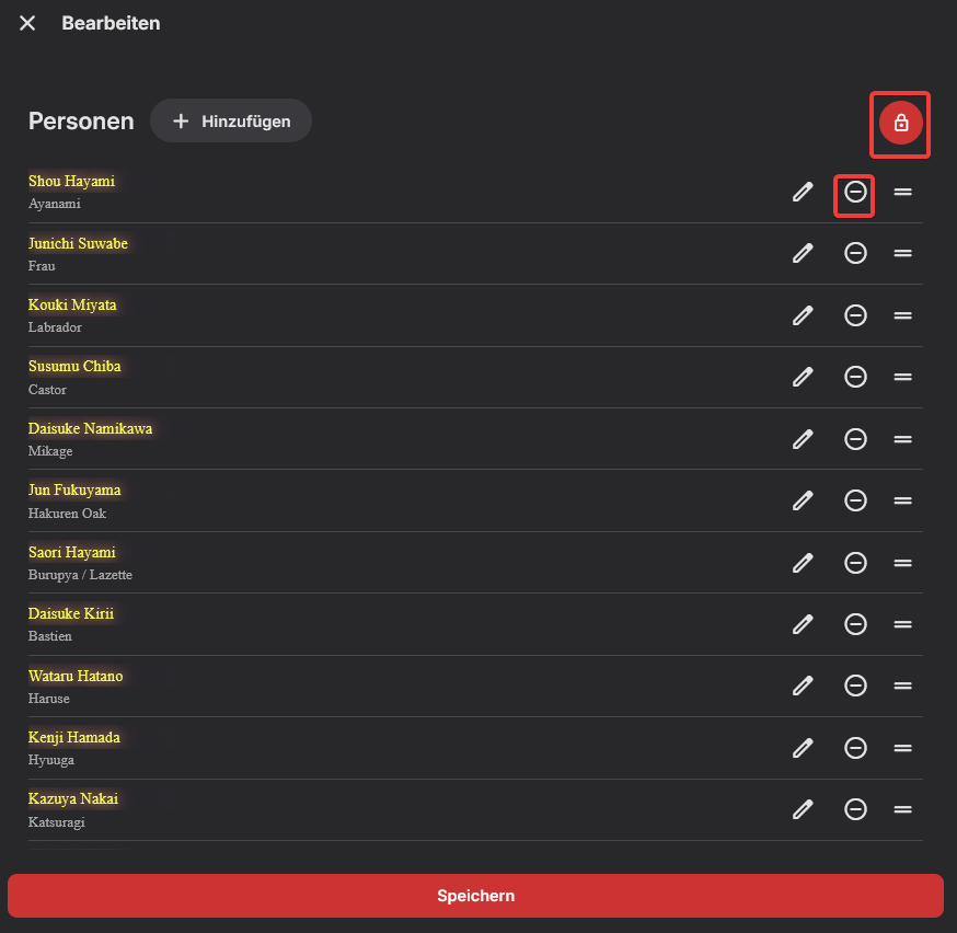

I would guess add the lockfields in your edit as there are field locks or lockdata for entire nfo.
<lockedfields>Cast</lockedfields>
10 minutes ago, visproduction said:
Maybe I didn't understand your initial issue
Hello @visproductionthx for the Information
I remove all actors from the nfo with a script
The aim is that there are no more Actors in the nfo and none are updated.
However, as long as I don't click this lock button in the gui, they are always updated again in the nfo.
My question is whether the command for the lock button can also be included in the python code?
Thx @Happy2Play i will try that

I would try locking using the user interface.

I understand that if I delete something from the nfo, it is directly added back from the database.
So, another question: can I somehow trigger the deletion of people via a script, similar to how I would do it manually in the GUI? For example, using AutoHotkey?
Because if I remove people through the GUI and click the block button, they are also immediately removed from the nfo.
Happy2Play
Not that I know of as in the UI you are working directly with specific db itemid metadata so externally you would have to use the API ItemUpdateService to remove info.  So you would have to Post a update to every itemid but not sure how to trigger nfo save at the same time.

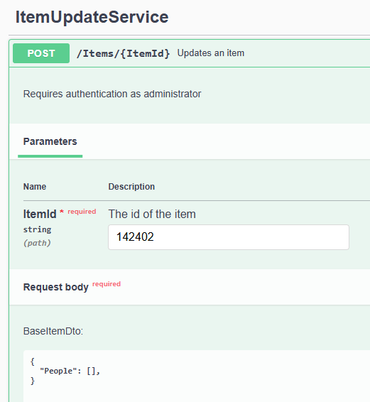

Okay one idea is I delete this via Rest-API and then directly edit the nfo. but how?
How do I get all Item_id. per file?
I have seen that this is not saved in the nfo. So I can't extract them from there.
Or can I filter this via the IDs in the nfo?
tmdbid = '21855' # The TMDB ID from the NFO file
item_id = get_item_id_by_tmdbid(tmdbid) # This function extracts the item_id as described above

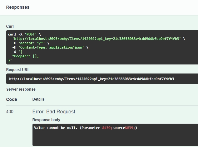

Personally don't know all the requirements to be sent back in itemupdate as limiting to just people I get a bad request but people are removed from item.  But not updated in nfo.  @Lukeshould a bad request still work?
System.ArgumentNullException: Value cannot be null. (Parameter 'source')
Itemid is Emby's created number in the database for that media.
Edited by Happy2Play
