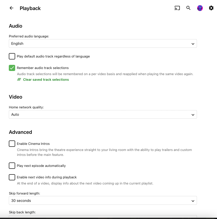

Cluttered 15 Posted August 19, 2024 Author Posted August 19, 2024 (edited) I have enable next video and autoplay next video both off, some episodes do hang at the end but most were fine. These ones aren't hanging, they go back to the series screen is it? (the first image I posted) with the next button on it. It recognises it is a button as the mouse pointer changes when I hover over it but pressing it any number of times does nothing. It does sometimes take a while to update the latest episode after one finishes but that never seemed to cause issues using the 'next' button. And I don't think I changed anything at all on the server so why did it change suddenly? Edited August 19, 2024 by Cluttered
GrimReaper 4893 Posted August 19, 2024 Posted August 19, 2024 (edited) 15 minutes ago, Cluttered said: These ones aren't hanging, they go back to the series screen is it? (the first image I posted) with the next button on it. 6 hours ago, Cluttered said: at the end I get the screen with the 'next episode' button in the lower right. Nope, they don't go back, that's episode playback screen hanging at the end - though, contrary to that screenshot, my "Next episode" button does get filled and then screen hangs. Edit: Try enabling both of those options, play one episode to the end, let second play automatically and then disable them both again, see if there are any changes in behaviour afterwards. Edited August 19, 2024 by GrimReaper Append
