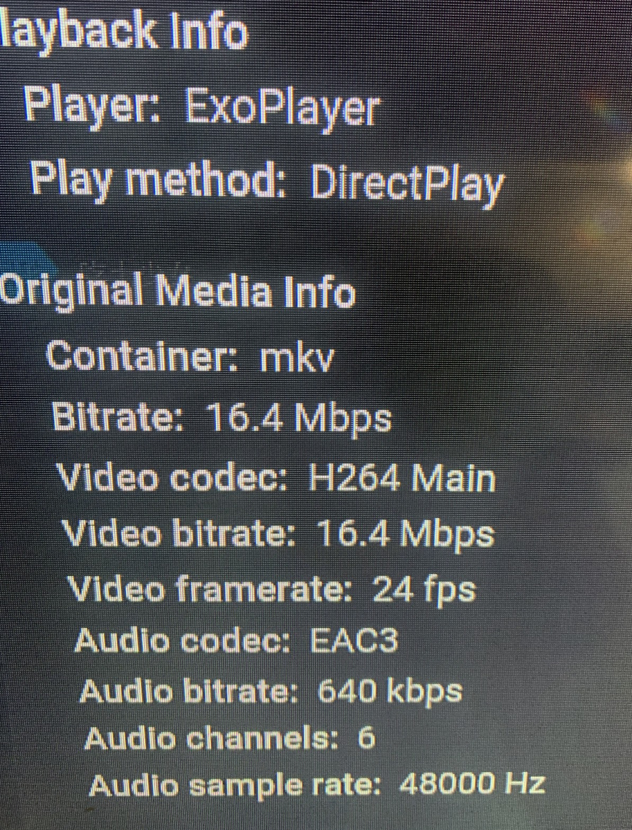

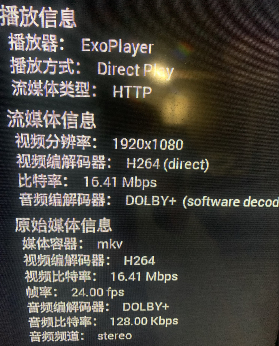

zysljd 3 Posted August 17, 2024 Posted August 17, 2024 I'm using standard android, tested several different versions 3.4.X, 3.3.X, 3.2.X. Playing AC3 no sound. But the strange thing is that with the Android TV version there is sound, I watched the playback information and noticed one point. For the TV version, the sound information is Dolby, while the standard version is AC3, I don't know if this has anything to do with it. Both versions are direct playback, no transcoding.

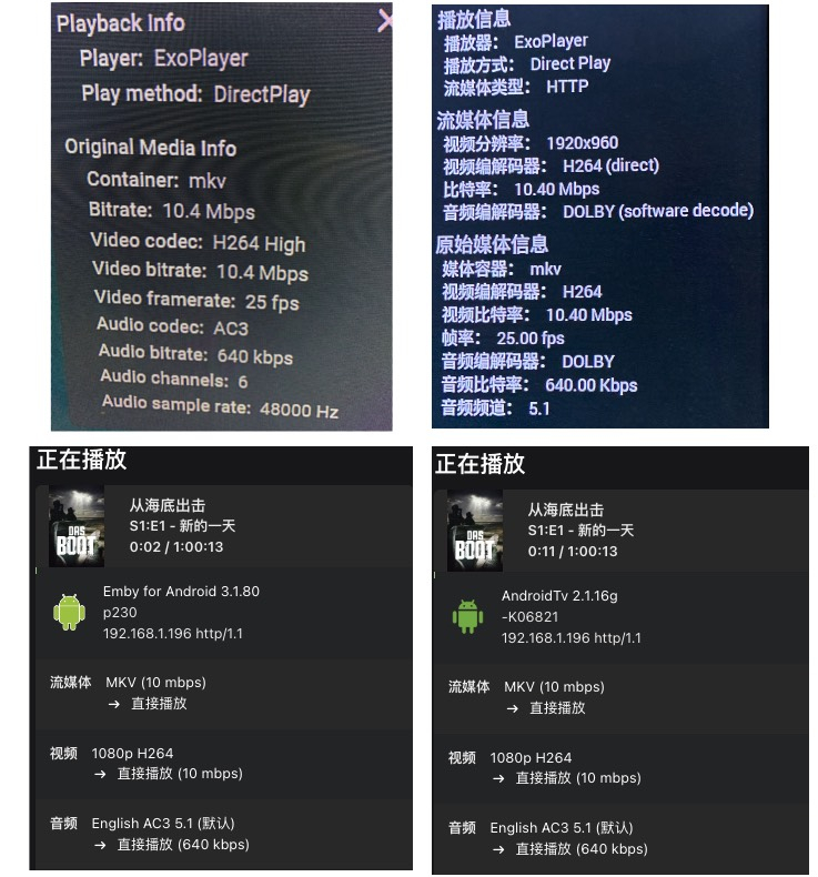

zysljd 3 Posted August 17, 2024 Author Posted August 17, 2024 Recollected the relevant information Another TV show, same situation.
zysljd 3 Posted August 17, 2024 Author Posted August 17, 2024 The same movie, using the latest Android Standard, is also silent.
