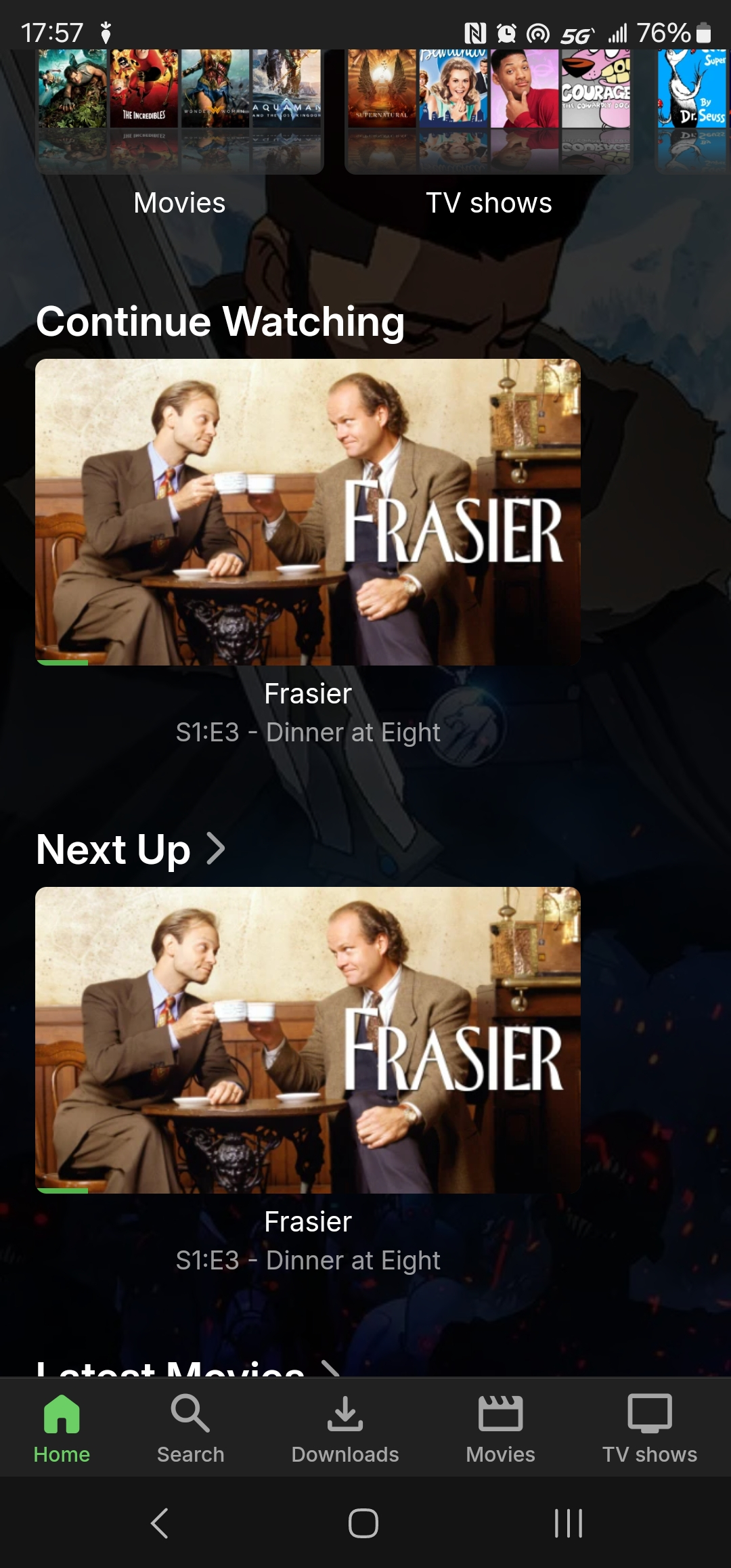

keduncan3 4 Posted August 16, 2024 Posted August 16, 2024 I searched the forums and documentations section but haven't found a solution for this yet. Can anyone provide some insight as to the Continue Watching and Next Up sections? What I'm looking for it to do is have one section for resuming already started media and a different section for Next Up where the next available episode that hasn't been started is listed. From what I read, Next Up Legacy is supposed to do this, however it is acting like continue watching. All I can see is the resumeable media.
Happy2Play 9811 Posted August 16, 2024 Posted August 16, 2024 Looks correct as Next Up has not reached the threhold to change from the episode you are watching to the next so it ends up in both sections. But everywhere an item is shown it will show the indicator. Just more noticable as these rows are usually stacked together.
keduncan3 4 Posted August 16, 2024 Author Posted August 16, 2024 (edited) So just to confirm, I need to have both continue watching and next up defined on in my settings as section 2 and section 3 or does next up contain both of those in separate rows? I apologize, I'm just a little confused on how CW and NU work independently of each other versus together. For clarification, my goal is for NU to only ever show the next episode available for play while continue watching will only ever show resumeable media Edited August 16, 2024 by keduncan3
Happy2Play 9811 Posted August 16, 2024 Posted August 16, 2024 (edited) 10 minutes ago, keduncan3 said: So just to confirm, I need to have both continue watching and next up defined on in my settings as section 2 and section 3 or does next up contain both of those in separate rows? Do you need them both no as the combine CW will show you both if Legacy row is disabled. Others like me like the legacy row as I usually have nothing in CW. Edited August 16, 2024 by Happy2Play
