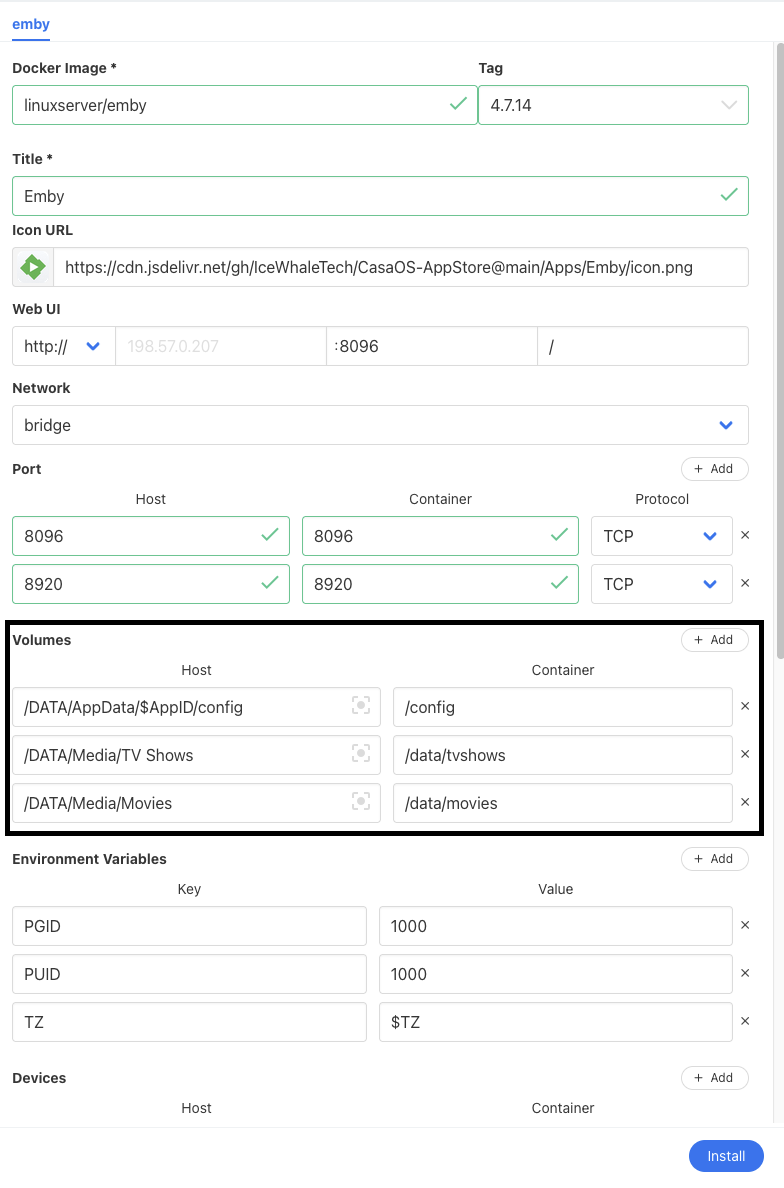

guunter 49 Posted August 17, 2024 Posted August 17, 2024 (edited) 56 minutes ago, numetalfan89 said: I’ve downloaded the emby application via the search feature on casaos You need to set the paths in your Emby app on casaos. It’ll be like /mnt/usb/Movies:Movies for example. First part is your host directory and second part is what it will look like in the Emby docker. I don’t have casa installed atm to screenshot. I just do a docker compose.. Edited August 17, 2024 by guunter

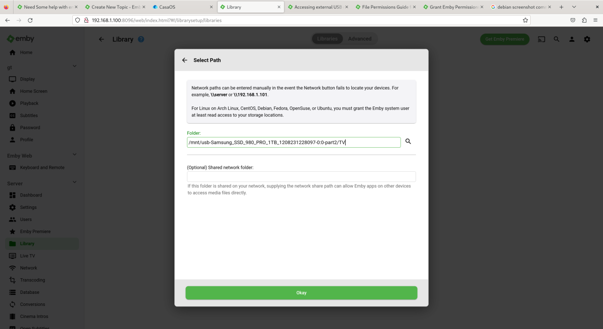

numetalfan89 1 Posted August 17, 2024 Author Posted August 17, 2024 2 minutes ago, guunter said: You need to set the paths in your Emby app. It’ll be like /mnt/usb/Movies:Movies for example. First part is your host directory and second part is what it will look like in the Emby docker. I don’t have casa installed atm to screenshot. I just do a docker compose.. the first screenshot shows that I am trying to set the path in emby and its presenting the error, 'The path could not be found. Please ensure the path is valid and try again.'
guunter 49 Posted August 17, 2024 Posted August 17, 2024 3 minutes ago, numetalfan89 said: the first screenshot shows that I am trying to set the path in emby and its presenting the error, 'The path could not be found. Please ensure the path is valid and try again.' You need to do it on CasaOS first. You have to add a path in there. Think of the Emby app as its own entity with casaos. It has no access to anything unless you set it in the configuration in CasaOS.

Solution guunter 49 Posted August 17, 2024 Solution Posted August 17, 2024 8 minutes ago, numetalfan89 said: Is there a forum post that can show me how to do that? I'm unsure of what to look up as it seems what I do find is irrelevant to me. Change the settings for Emby in CasaOS. Click the 3 dots and select settings. Where you see Volumes is where you edit your storage pasts. Host will be your /mnt/usb and the Container is what that folder will be named in emby. 1 1
numetalfan89 1 Posted August 17, 2024 Author Posted August 17, 2024 41 minutes ago, guunter said: Change the settings for Emby in CasaOS. Click the 3 dots and select settings. Where you see Volumes is where you edit your storage pasts. Host will be your /mnt/usb and the Container is what that folder will be named in emby. Brooooo thank you so much
guunter 49 Posted August 17, 2024 Posted August 17, 2024 24 minutes ago, numetalfan89 said: Brooooo thank you so much Just fyi this is also the same section to add variables for gpu transcoding 1
