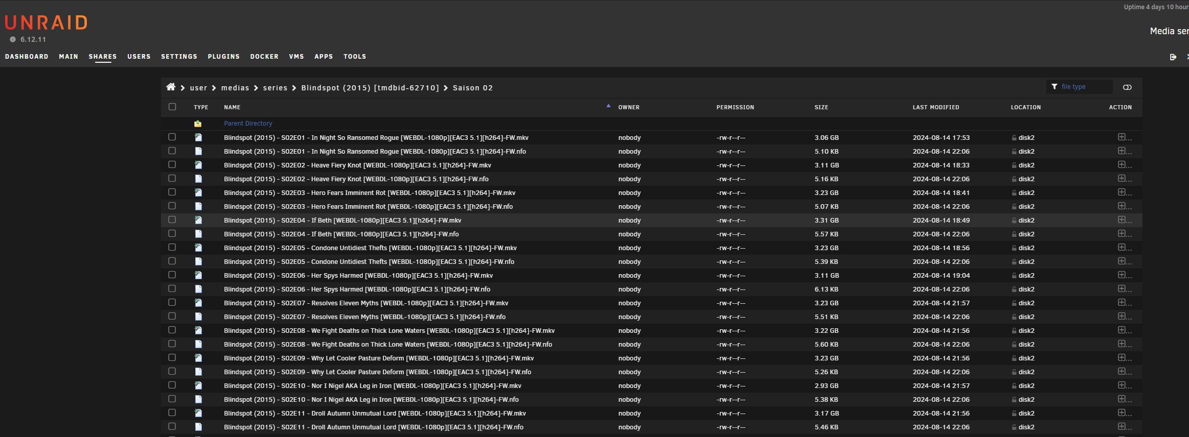

Luke 42243 Posted August 16, 2024 Posted August 16, 2024 1 minute ago, Dydhzo said: Okay, thanks for your feedback. I’ll wait 5 days for the Infuse plugin then. - Do you recommend correcting the permissions or disabling the NFO file saving? (I’m not really sure what the point of saving them is.) Is it better to save them or not? Sorry for all the questions; I just want to do what’s best. It really depends on whether you want that feature or not. Do you have nfo files next to your video files?
Guest Posted August 16, 2024 Posted August 16, 2024 4 minutes ago, Luke said: It really depends on whether you want that feature or not. Do you have nfo files next to your video files? yes I have NFO files next to my files (see image)
Guest Posted August 17, 2024 Posted August 17, 2024 (edited) On 8/16/2024 at 4:16 AM, Luke said: It really depends on whether you want that feature or not. Do you have nfo files next to your video files? Hello, I did everything you told me. It reset this morning at 9 AM (last night, I reinstalled Infuse). I believe I’ve fixed the issue with the NFO permissions. Here are the new logs: (I just noticed that the NFO still shows "is denied," but there are other errors. I don't know what they mean. For example: ) Source: System.Private.CoreLib TargetSite: Void CheckIo(Error, System.String, Boolean, System.Func`2[Interop+ErrorInfo,Interop+ErrorInfo]) InnerException: System.IO.IOException: Permission denied Source: TargetSite: embyserver-63859491167.txt emby-container.txt Edited August 17, 2024 by Dydhzo
Solution Happy2Play 9812 Posted August 17, 2024 Solution Posted August 17, 2024 Yes there appears to be a recursive permissions issue on /medias/films-anime and /medias/series-animation. So you will either need to correct the permissions issue or disable nfo saver.
Guest Posted August 17, 2024 Posted August 17, 2024 5 minutes ago, Happy2Play said: Yes there appears to be a recursive permissions issue on /medias/films-anime and /medias/series-animation. So you will either need to correct the permissions issue or disable nfo saver. Yes, I had only modified /medias/films. I just applied the changes to the rest. I'll wait to see if this has fixed the problem or not.
