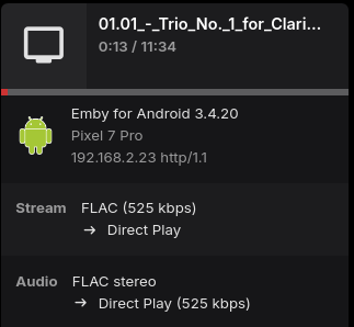

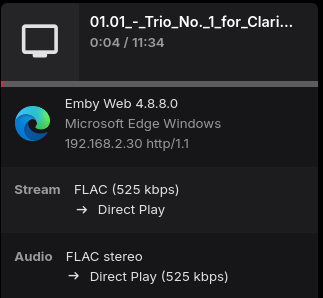

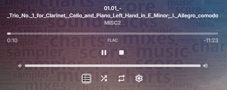

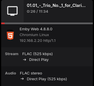

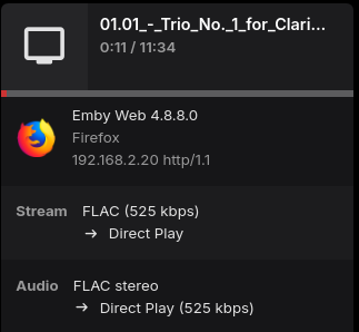

You'll have to provide your server log, I cannot reproduce an issue with this file, I don't see billions of minutes on my android device. Maybe you need to refresh metadata on the item?
image.png.e8dc461b20d9716e10a634fa1773eaae.pngimage.png.5d48e75bce5c35e39fab62a7096237ac.png
image.png.52c61bd69941eb179f9e69f9232b1a15.pngimage.png.48124043537d18b7141741eec9745a12.png

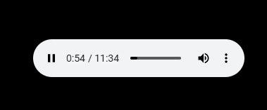

So if you drag and drop the file into your browser does it play?  But not seeing an issue either.
Yea try the drag and drop test. Sometimes there are certain files that are encoded in such a way that the browser audio player can't handle.

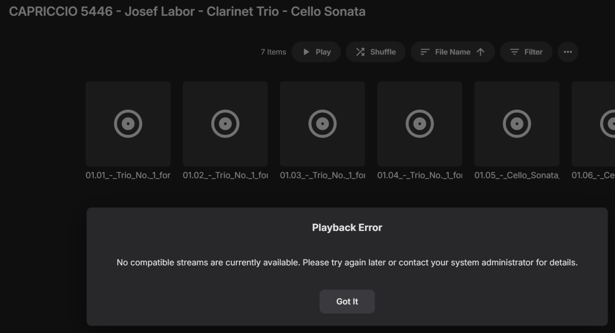

Actually, here is printscreen what happend if I want to reproduce file on web browser

It works if I drag and drop file into the browser - exactly as you showed on your printscreen.

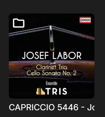

Choose folder image.png.657337beed957e77e31bd8f2665ded1a.png and try.
Just to inform you I did access and tried to play the first item and the folder with both play and shuffle so I concur that it's working now. My only guess is the metadata was not correct and it got refreshed. :) I figured I could answer my own question about the media info that way but I wouldn't know if it was updated or not.

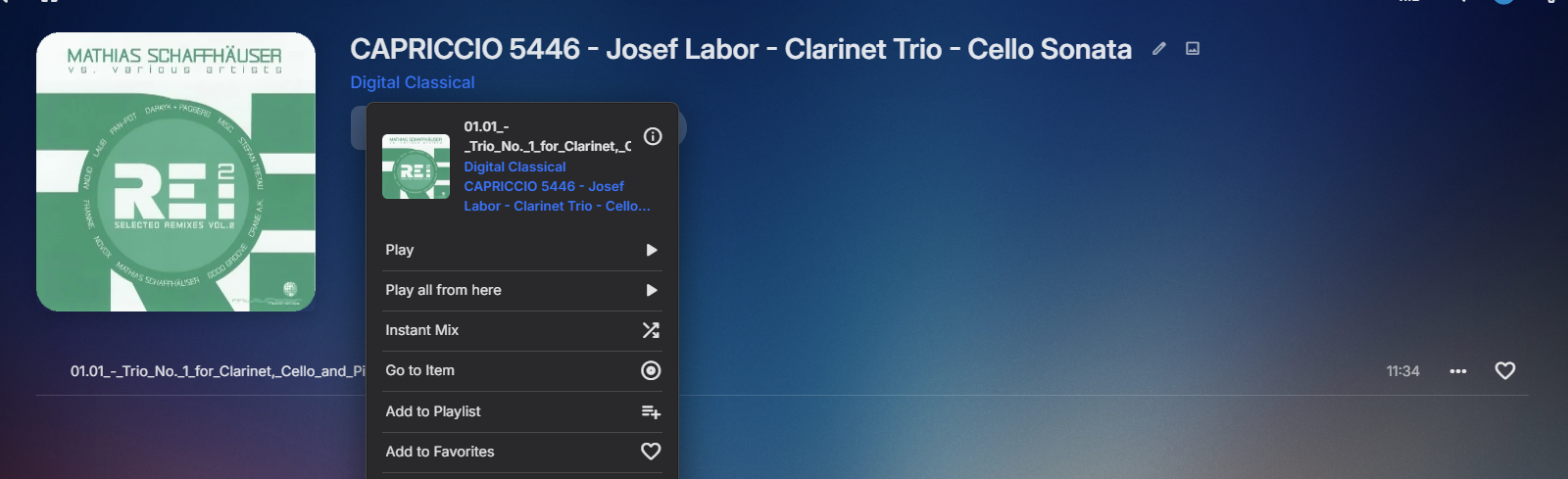

If you go to the album in Emby and right click on the track and click the super secret info button at top right, what shows for media info?

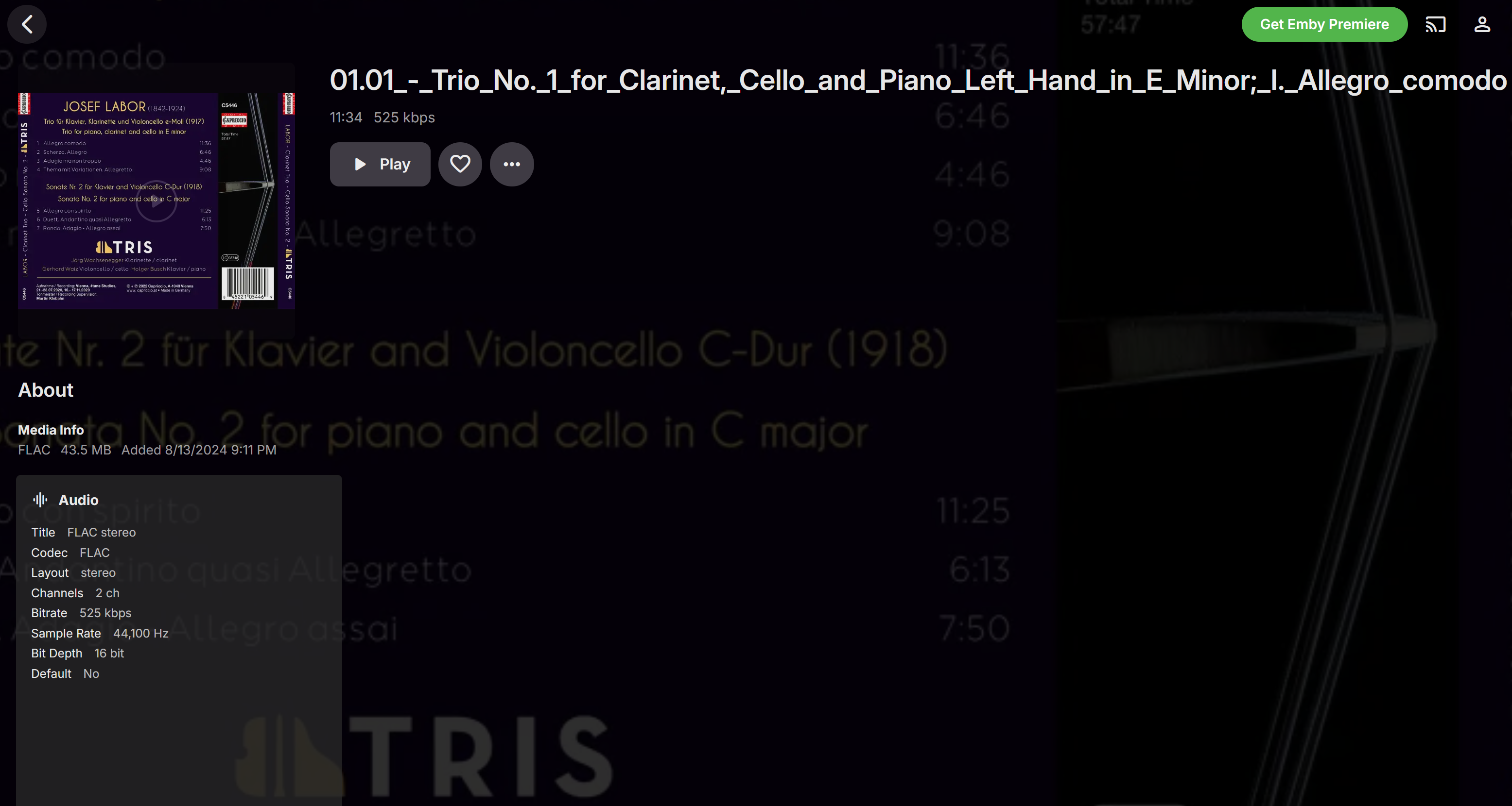

This is what I see as info:
