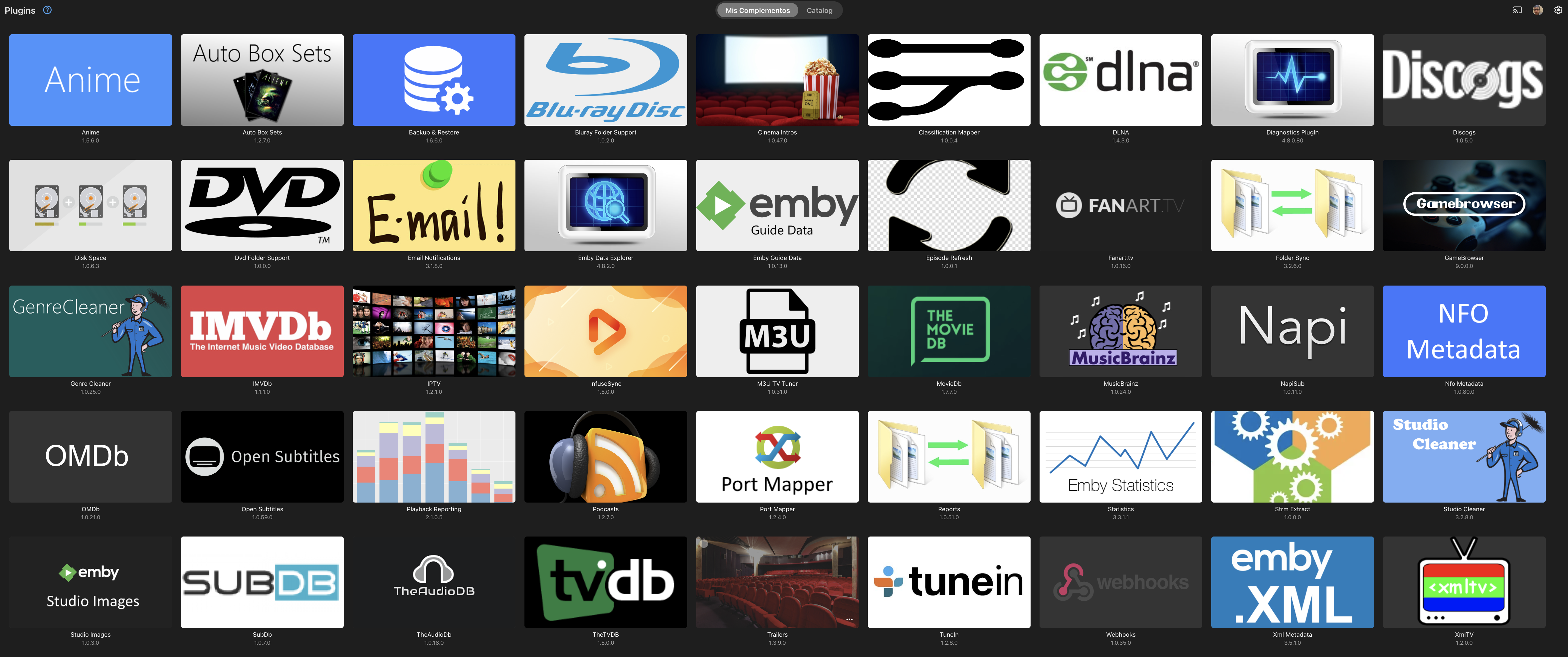

DarkStar1977 120 Posted August 14, 2024 Author Posted August 14, 2024 24 minutes ago, Happy2Play said: Really depends on the plugin installed using that task. These are the plugins I've installed, and I believe no one it's depending on the "Refresh Internet Channels":

Happy2Play 9811 Posted August 14, 2024 Posted August 14, 2024 Don't see anything in that log but will guess the Tunein plugin.
Luke 42234 Posted August 14, 2024 Posted August 14, 2024 Hi, please try removing the TuneIn plugin. Then restart the server and see how things compare.

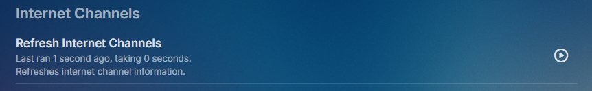

DarkStar1977 120 Posted August 30, 2024 Author Posted August 30, 2024 On 8/14/2024 at 7:07 PM, Luke said: Hi, please try removing the TuneIn plugin. Then restart the server and see how things compare. Hi, After removing TuneIn, the NAS stoppend being frozen but everytime that the "Refresh internet Channels" run, the Emby server is frozen being unable even to stop it through the WD applications interface. The only solution is to reboot the NAS everytime this task runs to make Emby Server to respond again. BTW, the IPTV plugin also uses the "Refresh Internet Channels" task, I've removed it too but for now I had to remove from the Scheduled tasks the "Refresh Internet Channels". I would appreciate some more Quality Control on Plugins, as most of them cause issues and seems it's a lottery everytime you install a plugin.

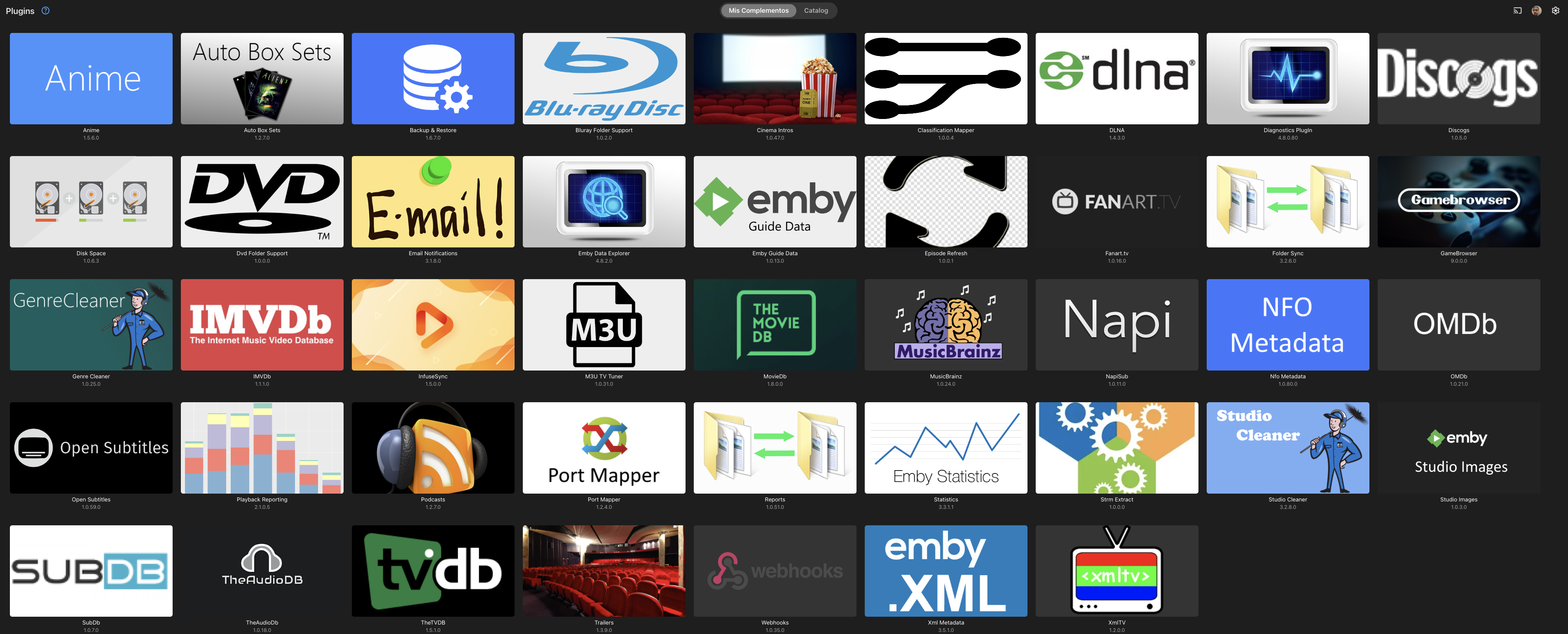

DarkStar1977 120 Posted September 7, 2024 Author Posted September 7, 2024 2 hours ago, Luke said: I would suggest keeping the task but removing the plugin. Otherwise if you install other channel plugins that use the same mechanism, this may lead you into thinking they are not refreshing their content. I've already removed all plugins (I think) that uses this, these are my installed plugins now: Even no one is using it, running it breaks my Emby Server

Happy2Play 9811 Posted September 11, 2024 Posted September 11, 2024 1 hour ago, Luke said: That would probably mean you have a lot of content from those removed channels that needs to be cleaned out of the database. Are you able to locate any of it via searching? Isn't all that logged? Or is it only debug logging? From last image Trailers and Podcast use that task, correct? On 8/30/2024 at 8:16 AM, DarkStar1977 said: I would appreciate some more Quality Control on Plugins, as most of them cause issues and seems it's a lottery everytime you install a plugin. That is questionable as not every system will be a to handle all plugins. But yes no matter the plugin, every plugin that is added applied additional strain to your server this is why Dev will usually ask to remove all plugins down to default Emby installed plugins. As these are the only plugins that come with Emby by default.
