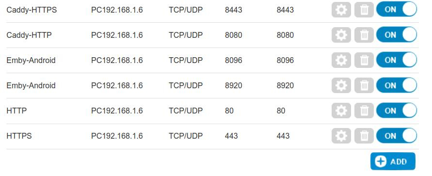

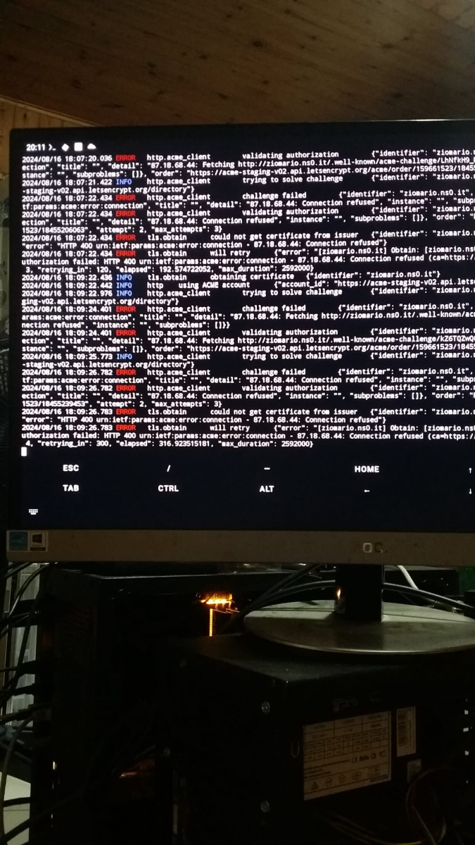

ziomario 5 Posted August 16, 2024 Author Posted August 16, 2024 (edited) Running the script without sudo still does not work. Errors is : ERROR : tls.obtain will retry error ziomario.ns0.it solving challenge authorization failed HTTP 400 urn:iert.params acme error connection: connection refused. Ports opened on the router are : Caddy-HTTPS PC192.168.1.6 TCP/UDP 8443 Caddy-HTTP PC192.168.1.6 TCP/UDP 8080 Emby-Android PC192.168.1.6 TCP/UDP 8096 Emby-Android PC192.168.1.6 TCP/UDP 8920 HTTP PC192.168.1.6 TCP/UDP 80 HTTPS PC192.168.1.6 TCP/UDP 443 Using sudo in the script,instead,to connect to the Emby server I should use port 8443 : https://ziomario.ns0.it:8443 While before,I didn't have to write the port. It was cleaner to open the website like this : https://ziomario.ns0.it Edited August 16, 2024 by ziomario
pwhodges 2033 Posted August 16, 2024 Posted August 16, 2024 (edited) In the router, open ports 80 & 443 (and no others), forwarding them to PC192.168.1.6, ports 8080 & 8443. This will be accessed without specifying a port - just https: . In Caddy, reverse proxy using the http port set in Emby (8096), specifying http (reverse_proxy http://192.168.1.6:8096). The https port isn't used, as Emby is not doing https (Caddy is), and the Emby security setting should say "handled by reverse proxy". Why have you got encode in your Caddyfile? I don't think it will be useful. Paul Edited August 16, 2024 by pwhodges
ziomario 5 Posted August 16, 2024 Author Posted August 16, 2024 (edited) ---> In the router, open ports 80 & 443 (and no others), forwarding them to PC192.168.1.6, ports 8080 & 8443. what this mean ? I can't do what you suggest. For me open ports means forward them. To open and to forward are the same action. Check the attached image. Edited August 16, 2024 by ziomario
Q-Droid 1011 Posted August 16, 2024 Posted August 16, 2024 Pay attention, read and try to understand what's posted. You only need the bottom two entries, not the others. AND for 80 change the destination port to 8080. AND for 443 change the destination port to 8443. You are opening, forwarding and translating the port values.

Q-Droid 1011 Posted August 16, 2024 Posted August 16, 2024 You need two entries/lines in your router. LAN port 8080, public port 80. LAN port 8443, public port 443.
ziomario 5 Posted August 16, 2024 Author Posted August 16, 2024 (edited) like this one,ok... Edited August 16, 2024 by ziomario
pwhodges 2033 Posted August 16, 2024 Posted August 16, 2024 JUST TWO LINES as mentioned in several posts. REMOVE the lines referring to Emby. The only connections from the outside will be for Caddy (with the settings you now have), which is then solely responsible for passing data on to Emby through the reverse_proxy command. Paul 1
