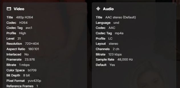

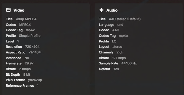

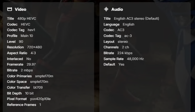

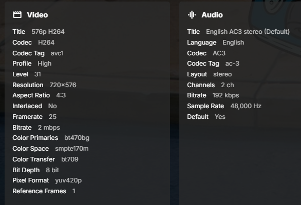

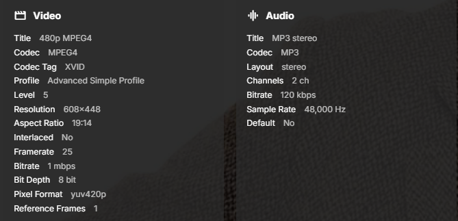

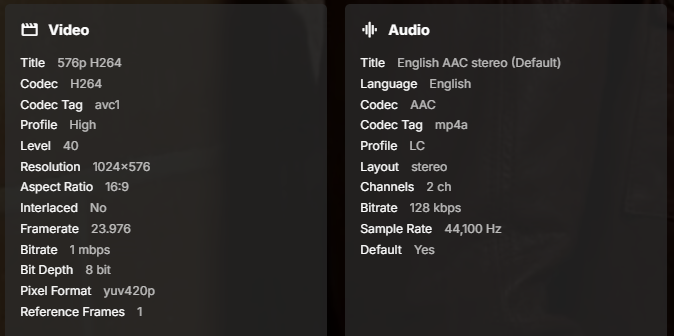

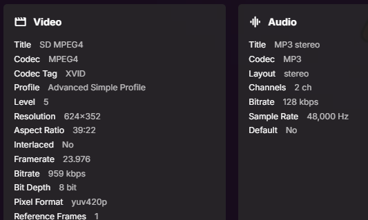

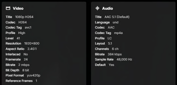

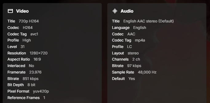

kingy444 117 Posted January 5 Author Posted January 5 (edited) On 03/01/2026 at 15:48, Luke said: What makes you think the app is trying to connect using ipv6? Well I thought I had narrowed it down to that, now im going to backtrack my previous post.... Turns out the video i tested was different, so it seems when the split tunnel is most media doesnt work, but some do. A couple of quick tests below. All work on full tunnel, its only split tunnel affected. I have noticed that when on split tunnel the dashboard thinks the theme.mp3 is playing when its not aswell. (if i turn full tunnel on i can hear the theme) Transcoding works fine, I can force transcoding on the full tunnel by changing the video size and this works too, the stream never starts on the split tunnel. I tried to find similiar files that work on and off the tunnel per below if that helps. I find it hard to blame the files here, given they playback fine on the full tunnel, and as other files are playing fine now on split tunnel, I am unsure what the issue with these files is (noting its more that dont play than do) I have some other inconsistencies with some files too This file plays on split tunnel, If I turn the srt subtitles off... but i tried the same for other files in the right column, and was not so successful Works on Split Tunnel Doesnt Work on Split Tunnel at all (including no srt) Edited January 5 by kingy444
